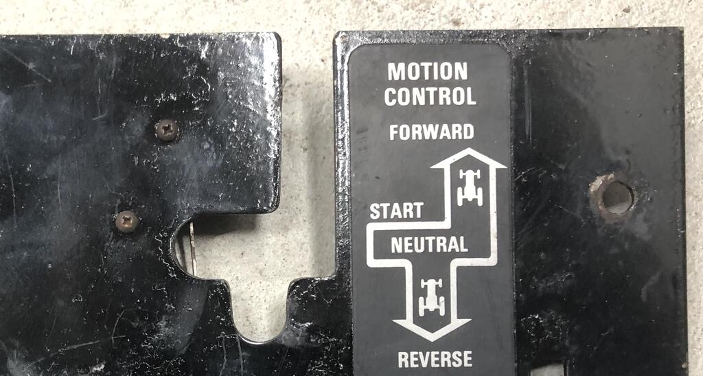

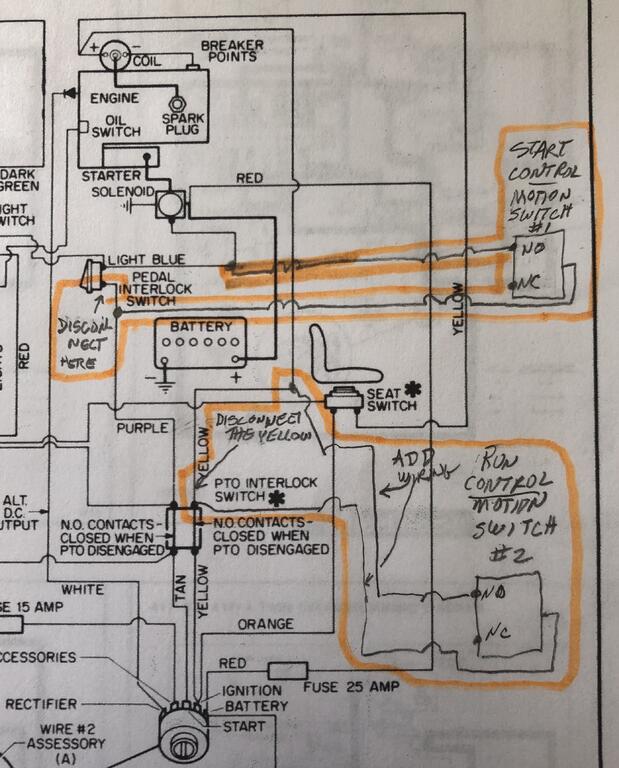

Handy Don 17,494 #37 Posted March 12, 2021 (edited) 16 hours ago, Lcarter114 said: No. My original thinking was to have it like my zero turn. If you are moving and are out of the seat it will shutdown. Now I am not married to anyone idea at this point, I was just looking for ideas. Thanks for adding this thought. Detecting that the operator is out of the seat is straightforward and the machine already has a switch for that (it comes into play when the PTO is engaged) Detecting that the motion lever is not in neutral is also straightforward on machines that have a switch for that (yours apparently does not, according to the wiring diagram). You can likely buy and add this switch--it mounts under the console floor plate. So the conditions are these: The engine runs as long as: Operator is in seat (regardless of PTO or motion lever) PTO is disengaged and motion is in neutral (regardless of operator in or out of seat) The engine starts as long as: PTO is disengaged and motion is in neutral (regardless of operator in or out of seat or position brake pedal). I'm assuming that since your brake was frozen but the tractor started that the pedal interlock shown in the wiring diagram has been defeated. Please clarify. Electrically, the start and run circuits are separate--this is a good thing for reliability and safety. So what's needed is a DPDT (double pole - double throw) lever-actuated microswitch mounted to detect neutral (or two SPDT versions ganged together like in the PTO mechanism). No relay is needed. One NO* (normally open) side will be wired in place of the existing pedal interlock sensor in the starting circuit--this prevents starts while lever is not in neutral. One NO* (normally open) side will be wired into the existing circuit between the PTO switch and the "+" terminal on the ignition coil -- this stops the engine when the motion lever is out of neutral unless the operator is in the seat. * NO contacts are closed when the motion lever is in neutral. These two attached images show how the switch gets mounted to the console plate to detect the lever in neutral. This image is a modified wiring diagram showing the changes (circled with orange highlighter). I hope the wiring gurus will double check me here. Edited March 12, 2021 by Handy Don 2 Share this post Link to post Share on other sites
Lcarter114 4 #38 Posted March 12, 2021 48 minutes ago, Handy Don said: Thanks for adding this thought. Detecting that the operator is out of the seat is straightforward and the machine already has a switch for that (it comes into play when the PTO is engaged) Detecting that the motion lever is not in neutral is also straightforward on machines that have a switch for that (yours apparently does not, according to the wiring diagram). You can likely buy and add this switch--it mounts under the console floor plate. So the conditions are these: The engine runs as long as: Operator is in seat (regardless of PTO or motion lever) PTO is disengaged and motion is in neutral (regardless of operator in or out of seat) The engine starts as long as: PTO is disengaged and motion is in neutral (regardless of operator in or out of seat or position brake pedal). I'm assuming that since your brake was frozen but the tractor started that the pedal interlock shown in the wiring diagram has been defeated. Please clarify. Electrically, the start and run circuits are separate--this is a good thing for reliability and safety. So what's needed is a DPDT (double pole - double throw) lever-actuated microswitch mounted to detect neutral (or two SPDT versions ganged together like in the PTO mechanism). No relay is needed. One NO* (normally open) side will be wired in place of the existing pedal interlock sensor in the starting circuit--this prevents starts while lever is not in neutral. One NO* (normally open) side will be wired into the existing circuit between the PTO switch and the "+" terminal on the ignition coil -- this stops the engine when the motion lever is out of neutral unless the operator is in the seat. * NO contacts are closed when the motion lever is in neutral. These two attached images show how the switch gets mounted to the console plate to detect the lever in neutral. This image is a modified wiring diagram showing the changes (circled with orange highlighter). I hope the wiring gurus will double check me here. Just looking this over to make sure I follow it completely. If I understand this correctly I would need two normally open switches to detect when the lever is not in the neutral position? This looks simple enough to do and would solve the problem. Thanks for the info. Share this post Link to post Share on other sites
DennisThornton 4,773 #39 Posted March 12, 2021 49 minutes ago, Lcarter114 said: Just looking this over to make sure I follow it completely. If I understand this correctly I would need two normally open switches to detect when the lever is not in the neutral position? This looks simple enough to do and would solve the problem. Thanks for the info. Took over a day but I think you have your answer! Share this post Link to post Share on other sites
Jeff-C175 7,211 #40 Posted March 12, 2021 (edited) 18 hours ago, Lcarter114 said: Ok, I don't need a lecture. ... I don't think there is anyone who can say they have never gotten off their piece of equipment without ... I do. I won't admit to this, it wasn't me, it was someone who looks just like me though... Something about a cement block on the seat, engaging the mower deck, and squirting the garden hose underneath to clean the deck out. Maybe that someone who looks just like me should simply install a washout port? Edited March 12, 2021 by Jeff-C175 Share this post Link to post Share on other sites
Handy Don 17,494 #41 Posted March 12, 2021 (edited) 1 hour ago, Lcarter114 said: Just looking this over to make sure I follow it completely. If I understand this correctly I would need two normally open switches to detect when the lever is not in the neutral position? This looks simple enough to do and would solve the problem. Thanks for the info. YW. Yes, Two switches of the type you can see in the picture ganged together so both are controlled by the motion lever (an example is the two switches attached to the PTO mechanism). It would also be fine to have a single body DPDT. Just be sure to wire each side separately as if they were two switches! As far as connections, I'll leave it to you to find the best way to make them secure and weatherproof in convenient locations. Be sure to print the diagram and save it with your tractor documents so you have a reference! Is the pedal interlock defeated? Edited March 12, 2021 by Handy Don Share this post Link to post Share on other sites

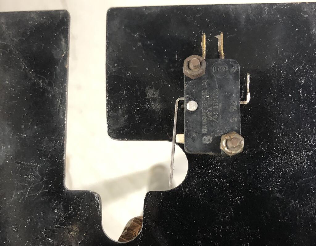

Lcarter114 4 #44 Posted March 13, 2021 17 hours ago, Handy Don said: YW. Yes, Two switches of the type you can see in the picture ganged together so both are controlled by the motion lever (an example is the two switches attached to the PTO mechanism). It would also be fine to have a single body DPDT. Just be sure to wire each side separately as if they were two switches! As far as connections, I'll leave it to you to find the best way to make them secure and weatherproof in convenient locations. Be sure to print the diagram and save it with your tractor documents so you have a reference! Is the pedal interlock defeated? The pedal lock is not defeated. It was my left leg that was pinned so I couldn't reach it. I looked at my tractor last night and my gear shift plate is straight. There is linkage and plate on top of the transmission where I maybe able to mount the switch. Share this post Link to post Share on other sites

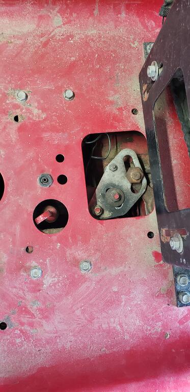

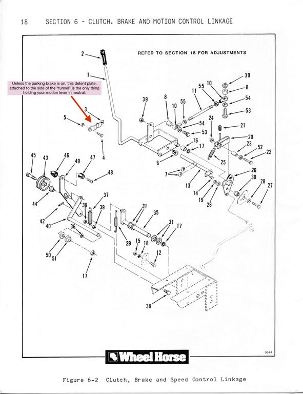

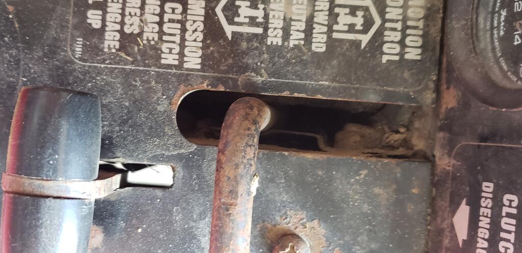

Handy Don 17,494 #45 Posted March 13, 2021 4 minutes ago, Lcarter114 said: The pedal lock is not defeated. It was my left leg that was pinned so I couldn't reach it. I looked at my tractor last night and my gear shift plate is straight. There is linkage and plate on top of the transmission where I maybe able to mount the switch. Ah! Now I see how the motion control is vulnerable to being moved. I haven't seen this configuration before. Looking at the relevant section of the parts list for your tractor here. That detent plate, visible in your picture, flexes slightly to permit the lever to move out of the "neutral" detent to forward and reverse positions. Configuring a sturdy and reliable switch arrangement here that detects when the motion lever or linkage is (or is not) "in the middle" will be harder. This will need some thought, as my original idea won't work. (As a side note, I'm guessing that for this model, the engineers were content with the pedal interlock to assure safety when starting the engine and didn't look to the mount/dismount situation that you want to address. Other models had the same plate arrangement as my '88 518-H. Share this post Link to post Share on other sites
Lcarter114 4 #46 Posted March 13, 2021 1 hour ago, Handy Don said: Ah! Now I see how the motion control is vulnerable to being moved. I haven't seen this configuration before. Looking at the relevant section of the parts list for your tractor here. That detent plate, visible in your picture, flexes slightly to permit the lever to move out of the "neutral" detent to forward and reverse positions. Configuring a sturdy and reliable switch arrangement here that detects when the motion lever or linkage is (or is not) "in the middle" will be harder. This will need some thought, as my original idea won't work. (As a side note, I'm guessing that for this model, the engineers were content with the pedal interlock to assure safety when starting the engine and didn't look to the mount/dismount situation that you want to address. Other models had the same plate arrangement as my '88 518-H. I am going to take off the plate and see if I can mount a switch at the indent. I have been keeping my eye out for a 520. I like my 417 but the hour meter shows 1400 hours. I bought it used a few years ago. It runs good and has no real issues, but I would like to have a gear drive instead of a hydro. I think it would be better when using the tiller. Share this post Link to post Share on other sites
Handy Don 17,494 #47 Posted March 13, 2021 48 minutes ago, Lcarter114 said: I am going to take off the plate and see if I can mount a switch at the indent. I have been keeping my eye out for a 520. I like my 417 but the hour meter shows 1400 hours. I bought it used a few years ago. It runs good and has no real issues, but I would like to have a gear drive instead of a hydro. I think it would be better when using the tiller. I hope you are able to figure it out. You can leave out the start switch in my diagram if you are comfortable with the pedal interlock and focus only on the run switch. Consider posting in the classifieds if you'd consider a trade! The 17hp Kohler paired with the 1100 Eaton is a desirable setup to some folks and there are plenty of members capable of overhauling that engine, if it needs it. There are very few 416-8 and 520-8's around. Most are hydros. Others will weigh in on the HP needed to till but you might do just fine with something smaller. What other implements do you use? Share this post Link to post Share on other sites
