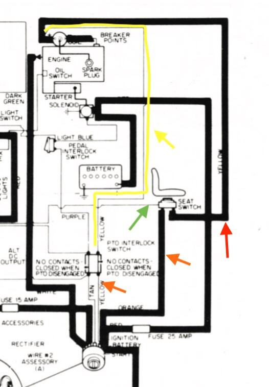

Handy Don 15,941 #5 Posted March 11, 2021 (edited) 4 minutes ago, SylvanLakeWH said: Check and see if it is bypassed... This switch only shuts down the tractor and only if PTO is engaged. No direct interaction with motion control. While engine is spinning down, it can still move. I think the idea is to force it to neutral while leaving the engine running and leave the existing PTO/Seat safety switch as it is. Edited March 11, 2021 by Handy Don 2 1 Share this post Link to post Share on other sites
WVHillbilly520H 10,378 #6 Posted March 11, 2021 (edited) 7 hours ago, Handy Don said: This switch only shuts down the tractor and only if PTO is engaged. No direct interaction with motion control. While engine is spinning down, it can still move. I think the idea is to force it to neutral while leaving the engine running and leave the existing PTO/Seat safety switch as it is. My 520 shuts down if the motion control is in anything other than neutral with the seat switch working, PTO on or not. But it is also 10 years newer than the OPs. Edited March 12, 2021 by WVHillbilly520H 2 Share this post Link to post Share on other sites

Handy Don 15,941 #8 Posted March 11, 2021 (edited) I'm looking at the wiring diagram for the 417-A. Here is a section: The ORANGE arrows point to wires that have power when the ignition switch is in RUN. The RED arrow points to wire supplying power to the coil when the PTO is engaged and the operator is in the seat. The YELLOW arrow points to the wire (with my yellow line adjacent) supplying power to the coil when the the PTO is disengaged. It does not go through the seat switch. (The GREEN arrow points to a wire that would show the state of the seat switch with an indicator light, but I don't think there is a lamp for that in the 417-A dash so it goes nowhere. Bottom line. It is factory that the engine runs while the PTO is disengaged and the operator is off the seat. Back to the problem of locking the motion control into neutral. Edited March 11, 2021 by Handy Don Share this post Link to post Share on other sites

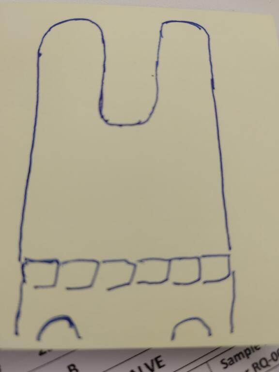

WVHillbilly520H 10,378 #19 Posted March 11, 2021 34 minutes ago, Handy Don said: Agreed to both of these. I have a floor-mounted motion lever and just looked at the floor plate. It would be possible to fabricate a plunger solenoid that locks the lever into neutral. But the sequence of events in dismounting might make it useless depending on when the weight comes off the seat and where the lever is when that happens. For example, if in starting to dismount, I bump the lever out of the lockable position and into the "no motion" area between forward and reverse, the solenoid has already been thwarted. If while continuing to get off the seat I further bump the lever toward forward or reverse it'll go. Ok a truly simple fix, fab up a "Y" fork that would be hinged/bolted to the shifter console plate, so during use it is out of the way, then when stopped simply flip the Y fork over to capture and block shifter from moving either direction, totally mechanical no electrical failures. 1 3 Share this post Link to post Share on other sites

Handy Don 15,941 #21 Posted March 11, 2021 2 minutes ago, WVHillbilly520H said: Ok a truly simple fix, fab up a "Y" fork that would be hinged/bolted to the shifter console plate, so during use it is out of the way, then when stopped simply flip the Y fork over to capture and block shifter from moving either direction, totally mechanical no electrical failures. I like this. It need only be a simple bar to flip fore/aft that blocks the lever from coming out of the neutral position. Bravo. 1 1 Share this post Link to post Share on other sites
WVHillbilly520H 10,378 #22 Posted March 11, 2021 17 minutes ago, Handy Don said: I like this. It need only be a simple bar to flip fore/aft that blocks the lever from coming out of the neutral position. Bravo. Standard flat hinge 1-2" wide by 3-4" long Share this post Link to post Share on other sites
