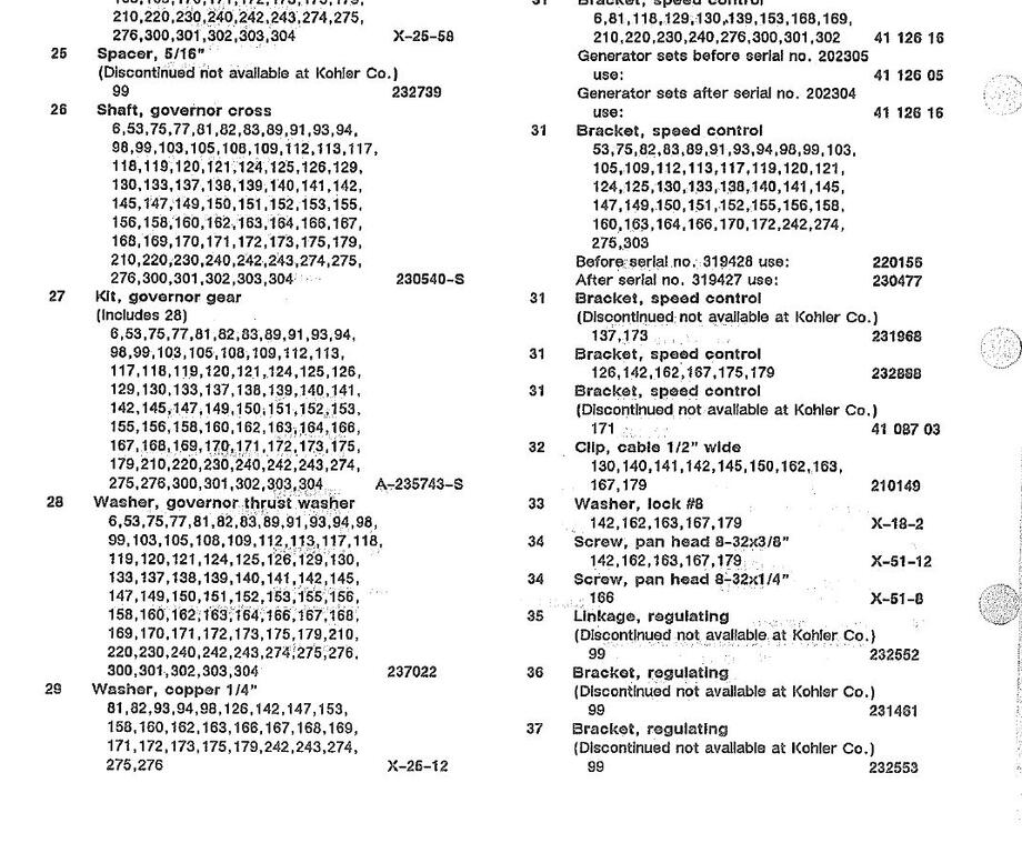

Gregor 4,848 #31 Posted April 2, 2021 I got the block painted, and on my work bench, all the parts lined up, and ready for assembly. Opened my book, and was determined to follow it step by step. If the book said fart, I was gonna fart. Everything went well for about 10 minutes, and then it didn't.. Step 1, install bearing on PTO side. Check! Bearing installed. Step 2, install governor gear and cross shaft. This is where the trouble started. The governor gear slides onto a small stub of a shaft, after installing a washer. Washer? What washer? I don't have any washer, and I don't remember seeing a washer. It's not in any of my bags of parts, it's not in any of my pics. So I look up the exploded view on partstree.com. Yep, there's a washer. Maybe I lost it. Maybe it was still in the block when I took it to the machine shop. I don't know, but it's not there now. Now I have to order a washer, and wait for it to arrive, before going any further. Or do I? It just so happens I have another K-181, waiting in the wings for a re-build. It is the original motor from the 876. We will call it the RED 181. I didn't want to tear it down yet, but desperate times call for desperate measures. I may as well tear it down, steal the washer, get the block and crank to the machine shop, so I can order another re-build kit. (more about the RED 181 in the K-181 (2) thread) I tear down the RED 181 to steal the washer, and there is no washer. Now I am stumped. Did Kohler at some time eliminate the washer? Do I proceed without the washer, or do I put it on hold, and order 2 washers? Like I said, there was no washer in the RED 181, and I don't believe there was ever a washer in the black 181. @Mickwhitt. Do you remember a washer in your 181? Motor experts.....help? Thanks Greg Share this post Link to post Share on other sites

pfrederi 21,184 #35 Posted April 2, 2021 (edited) The washer is there to keep the plastic gear from rubbing on the cast iron block material.. Quick look at parts manual 74 different variants all used it... Edited April 2, 2021 by pfrederi Share this post Link to post Share on other sites
Gregor 4,848 #36 Posted April 2, 2021 I ordered 2 of them. Whether or not I wait for them, remains to be seen. Share this post Link to post Share on other sites
pfrederi 21,184 #37 Posted April 2, 2021 (edited) 1 minute ago, Gregor said: I ordered 2 of them. Whether or not I wait for them, remains to be seen. 1 minute ago, Gregor said: I ordered 2 of them. Whether or not I wait for them, remains to be seen. 74 variants use them...plastic against cast iron not a good thing Edited April 2, 2021 by pfrederi Share this post Link to post Share on other sites

Gregor 4,848 #39 Posted April 2, 2021 I was able to pick up a small bronze thrush washer. 1/16" thick. Fit the stub shaft perfectly. With the stop pin installed there is still some slide play in the gear. Nothing interfering with anything. I may go this route. 1 Share this post Link to post Share on other sites

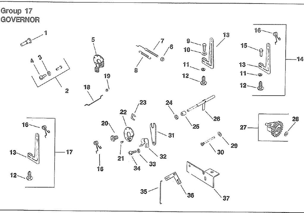

Gregor 4,848 #40 Posted April 2, 2021 Partstree shows several things on the exploded view of the governor, that simply are not on my motor. K181 spec 30108 Share this post Link to post Share on other sites
pfrederi 21,184 #41 Posted April 2, 2021 (edited) Your engine your call The washer is thin very thin I didn't measure it but it is less than 1/16 just by looking at it. Your variant is 105 Edited April 2, 2021 by pfrederi Share this post Link to post Share on other sites
Gregor 4,848 #42 Posted April 2, 2021 Yes it is thinner than 1/16. The thrust bearing is 1/16. The governor position, looks to me anyway, is determined by the stop pin. There is plenty of play for the governor gear between the stop pin, and the thrust washer. I don't have parts # 24, and 25 in your blow up, and with the governor bushing, I don't see how it's possible for them to be in there. There simply isn't room. At any rate, it's is going back together. If it blows, it blows. I will have learned something. They say you learn more from your mistakes, than your successes. We will find out. 5 hours ago, Handy Don said: Patience, sir, will be rewarded. When God was handing out patience, I thought he said patients. I said nope, don't need that. So I didn't get much. 1 Share this post Link to post Share on other sites
pfrederi 21,184 #43 Posted April 2, 2021 You should have #24 you should not have #25. You should look at the Kohler parts manual. Share this post Link to post Share on other sites
Gregor 4,848 #44 Posted April 2, 2021 10 minutes ago, pfrederi said: You should have #24 you should not have #25. You should look at the Kohler parts manual. You are right, sorry. I do have #24. Share this post Link to post Share on other sites

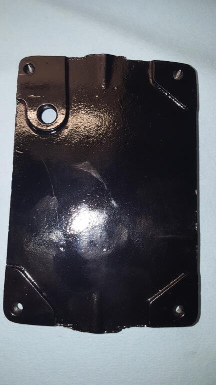

Gregor 4,848 #45 Posted April 3, 2021 I may have hit a snag in my plans. My plan was to assemble this motor, and mount it on the 876 temporarily, until I get the original rebuilt. That was the plan anyway. But as you can see by the oil drain plug hole, it may not be a good plan. The ends of the pan are not tapped for a plug. I could mount the other pan on here now, and switch them later, but it sounds like a hassle. If I get a pipe plug, with a countersunk Allen head, I may be able to shim the motor up off the frame a bit , just to get by. But I have gone as far as I am going tonight. Crank, cam, piston, rings, and tappets are in.Everything done by the book. Well, except for that little washer. Share this post Link to post Share on other sites
953 nut 69,558 #46 Posted April 3, 2021 You should be able to bolt your rebuilt engine to the other oil pan right on the tractor. Share this post Link to post Share on other sites
Gregor 4,848 #47 Posted April 3, 2021 The tractor is in about 100 pieces, and at the paint stripper. Share this post Link to post Share on other sites

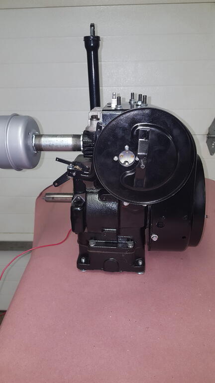

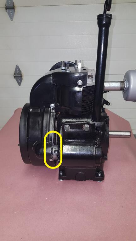

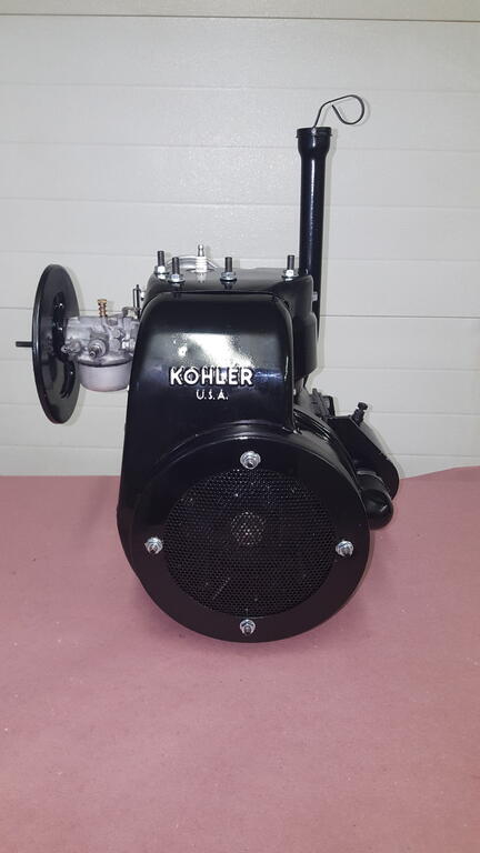

Gregor 4,848 #48 Posted April 3, 2021 (edited) Good, bad, or indifferent, the K 181 #1 is back together. But not without some problems. First, was that little washer on the governor gear. We'll see how that plays out. Speaking of governors, I still don't understand the adjustment procedure, even though it's spelled out in the book. As long as it works, I guess it doesn't matter, if I understand it or not. The coil/stator assembly is bad, I think, but I installed it anyway, only to have to remove it again. The flywheel was rubbing on it. I had the same problem with the Tecky. If and when I ever locate another stator, I will worry about it then. I am switching this motor to battery ignition. At least I think I am. If I have this right, all I have to do is add a coil, and a battery, and I am good to go. I hope. It has the original Kohler carb on, rebuilt. I don't have an air breather cover, so when I do fire it up, I'll have to borrow one from another motor. You may not be able to tell it in this pic, but the starter bendix rubs on the shroud. So far the only thing I can think of, is to whittle away a bit at the shroud. Maybe I will come up with something else, with a little more thought. I had to add some small feet to it to accommodate the oil plug. If I can figure a way to mount it, supply fuel to it, and mount the coil, I will give it a test run. Edited April 3, 2021 by Gregor Share this post Link to post Share on other sites

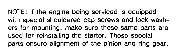

Gregor 4,848 #49 Posted April 3, 2021 Excerpt from the Kohler manual And they mean it too. Another tip toe through the garbage, for me. 1 Share this post Link to post Share on other sites

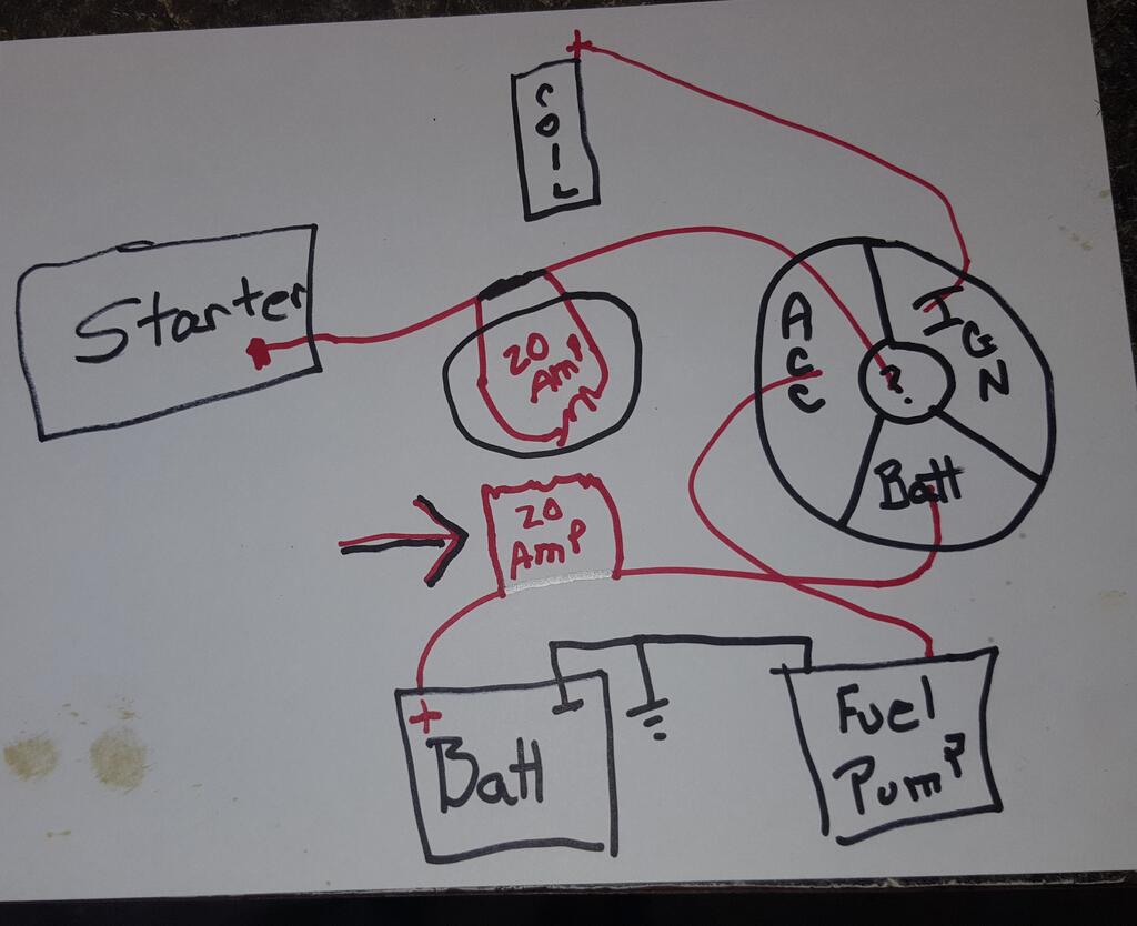

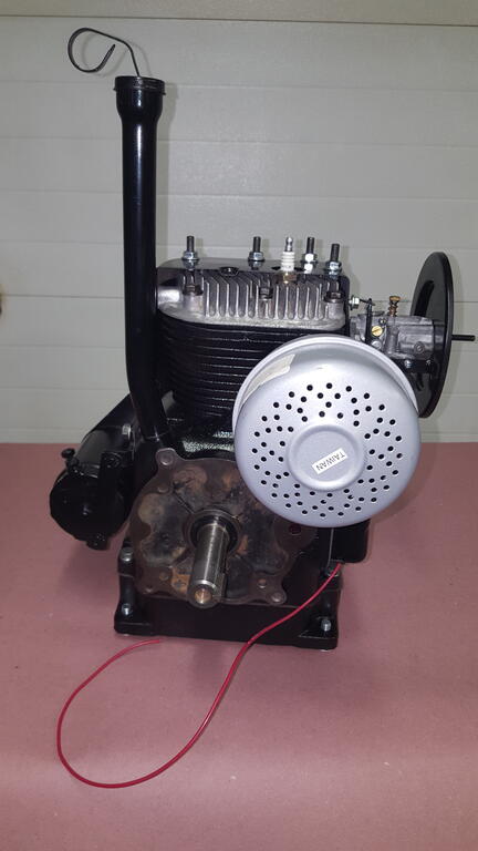

Gregor 4,848 #50 Posted April 4, 2021 I mounted the 181 on a test stand. Then I proceeded to wire it up. That's where things went bad. What did I do wrong? The back of the switch is labeled as you see it, except for the center post. I assumed it went to the starter. I have it wired as shown. As soon as I turn the key to "crank" position, it blows the fuse indicated by the arrow. With the circled 20 amp fuse installed I have continuity between the battery lug on the switch, and the center lug, any time the key is turned to the "on" position. If I remove the fuse, I don't. (thats the part I don't get) Fuel pump runs with the key in the "on" position, or the "acc" position. I have continuity, between the battery lug, and the ignition lug with the key turned on. Remove all fuses, use my jumper cables, direct from battery to starter, turns over fine. Again! Share this post Link to post Share on other sites
