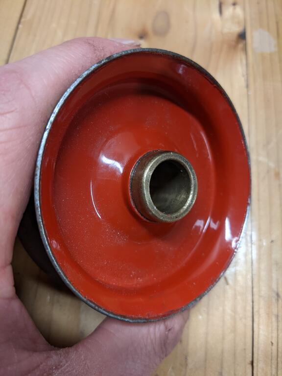

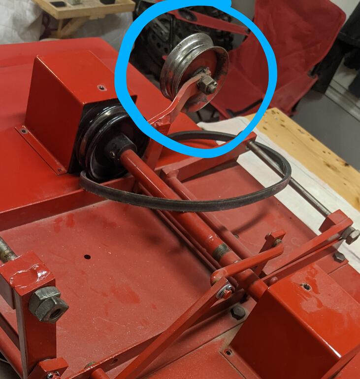

1) The Idler Pulley Bronze Bearing:
I mic'd it at 5/8" x 7/8" x 1". This is based on the OD and the length of the Idler bolt (part #1049), and the OD of the exposed portion of the bronze bearing in the idler pulley. Idler pulley (part #1602).
2 Questions:
          1) What is the actual size for the bronze bearing?
          2) Can this bearing even be replaced? It is in a peculiar place and appears to be held in 2 spots, one spot on either side of the pulley. I can't see inside until I cut the bearing out so it's hard to tell whether or not the is a tube of sort that makes contact with the bearing throughout the pulley, like the axle tube bearings. And it seams like this would, or could be a royal pain to set the new bearing if it only has two points of contact.

Gotcha. Any thoughts on the bronze bearing on the idler pulley?
squonk
Idler pulley looks like a common pulley .Replace the whole thing.

Lee1977
1 hour ago, john7 said:
I have no doubt that I can find something that will work.  The RJ and the deck were bought new by my grandfather so I'm committed to keeping things as original as possible... that is, if I can anyways.
Some idlers can be taken apart by drilling out the spot welds and some can't if it had a sealed bearing it can be fixed. The flat idlers are usually easer as they are not welded together in the grove. I suggest to take a small bit
and drill a reference hole between the spot welds before drilling out the spot welds. The idler bearings I have replaced are 1623-2RS 1 3/8 OD  5/8" ID and 7/16" thick there is usually a spacer pressed in the iD bushed down to 3/8".
I bolt mine back together.

john7
Thanks for the pointers. If only mine was a radial and not a bronze bearing. I tried to upload a close up but ran out of MB's.
I like your idea. Mine is spot welded like yours as well. This has me thinking. If I split the two halves it may be easier to press the bronze bearing in from the inside of both halves, one at a time.
Here's a close-up. Any ideas?
Edited by john7

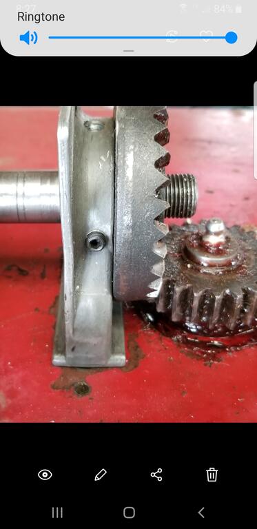

gt14rider
Added a couple of set screws in aluminum housing to keep bearing tight,
john7
This is a killer idea. I didn't notice any issues with my bearings slipping in the aluminum housings at all. In fact, they were set very well; not too loose and not too tight.
Is your deck one of the newer RMR-32's or something else? I notice that you have a zerk on top of your spindle for your bearings. I only have a zerk on top of the housing itself, nothing inside. I went ahead and got sealed bearings mostly for this reason.
On a different note, what kind of grease are you using for your gears?
gt14rider
My deck is a RM- 366. Run it on a 856. The grease is high temp bearing grease
