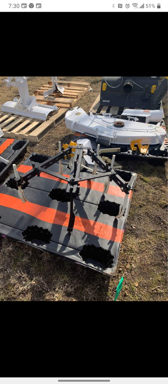

haydendavid380 759 #1 Posted March 8, 2021 I surely can't figure it out Share this post Link to post Share on other sites

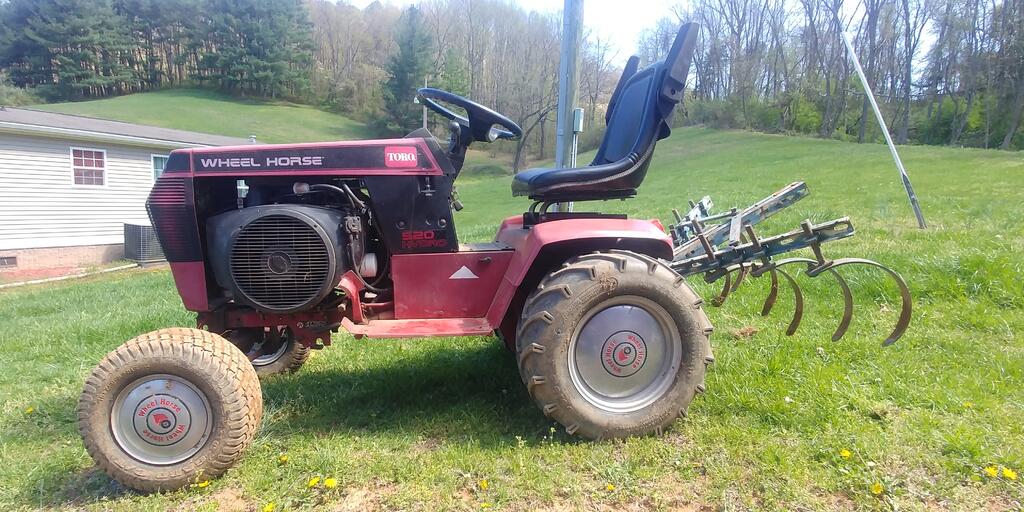

WVHillbilly520H 10,376 #3 Posted March 8, 2021 See the 2 bars pointing in a "Vee"... This one has been in the family for nearly 40 years. 2 Share this post Link to post Share on other sites

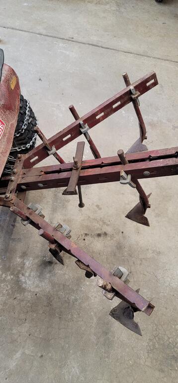

WVHillbilly520H 10,376 #5 Posted March 9, 2021 38 minutes ago, haydendavid380 said: Great, so I'm missing pieces Yes , but easy/cheap to fabricate some 3/16-1/4" x 1" flat stock will be plenty. Unfortunately they are in WV and I can't get you actual dimensions until the weekend. 3 Share this post Link to post Share on other sites
Pullstart 68,147 #6 Posted March 9, 2021 I have an old one that was pulled from the junk pile weeds at Grandpa’s house. Lots of broken cast pieces. I tossed a 1/4”x1” piece of bar stock across it, bolted it together as needed and went to town. It was a bit crooked until it broke but it does the job! 1 2 Share this post Link to post Share on other sites
WVHillbilly520H 10,376 #7 Posted March 12, 2021 On 3/8/2021 at 7:20 PM, haydendavid380 said: Great, so I'm missing pieces Better pic... Share this post Link to post Share on other sites
haydendavid380 759 #8 Posted March 12, 2021 20 minutes ago, WVHillbilly520H said: Better pic... That'll be easy enough with a couple pieces of flat stock 1 Share this post Link to post Share on other sites
WVHillbilly520H 10,376 #9 Posted March 12, 2021 1 minute ago, haydendavid380 said: That'll be easy enough with a couple pieces of flat stock I will try to remember to get you some dimensions this weekend when I got back home to WV to my parents. 1 Share this post Link to post Share on other sites
