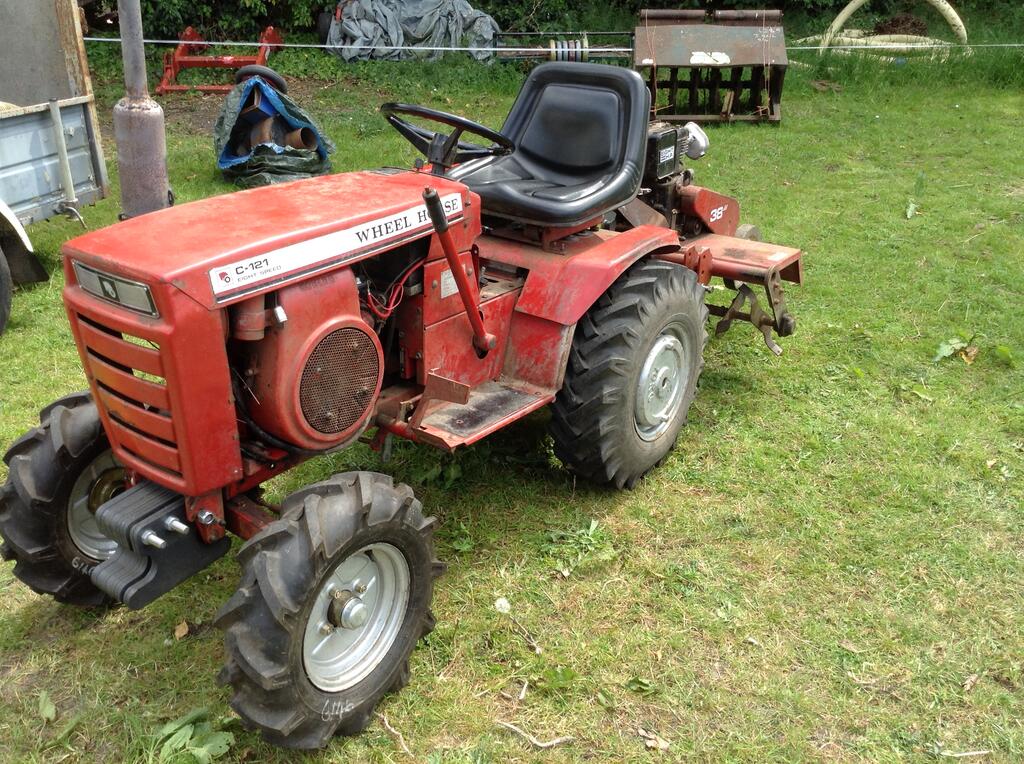

ebinmaine 77,543 #2 Posted March 8, 2021 What kind of tractor? I made a bolt on bracket for Trina's 867. Share this post Link to post Share on other sites

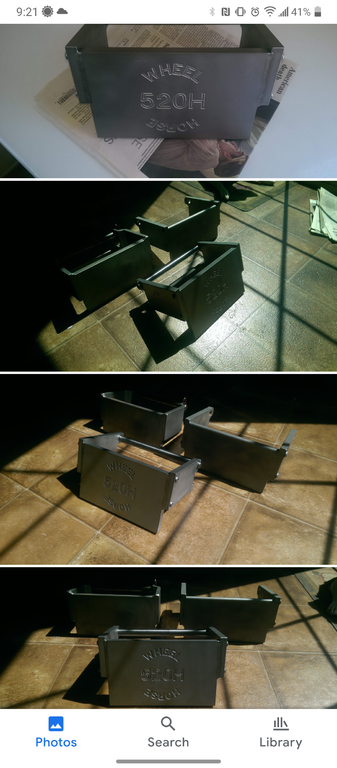

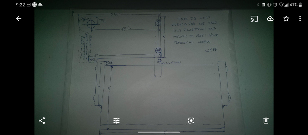

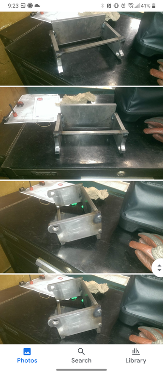

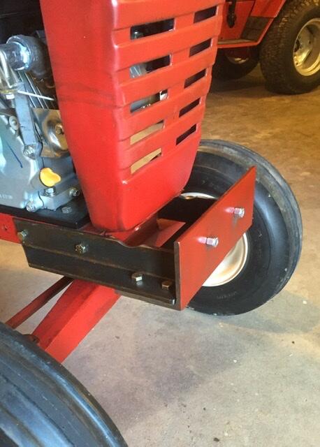

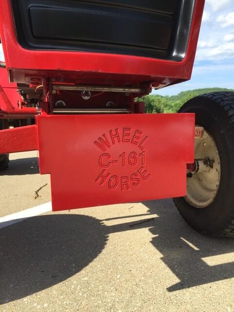

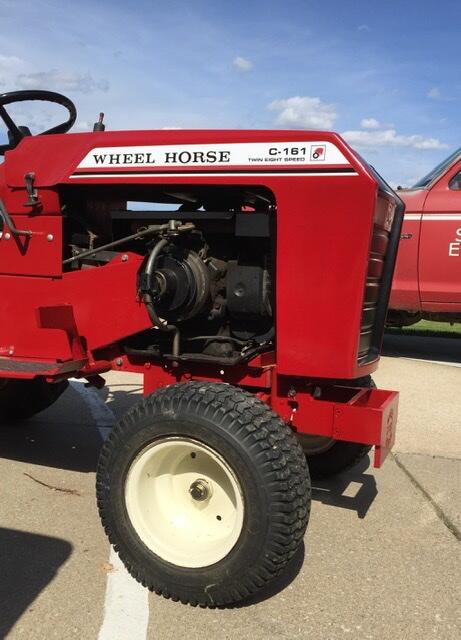

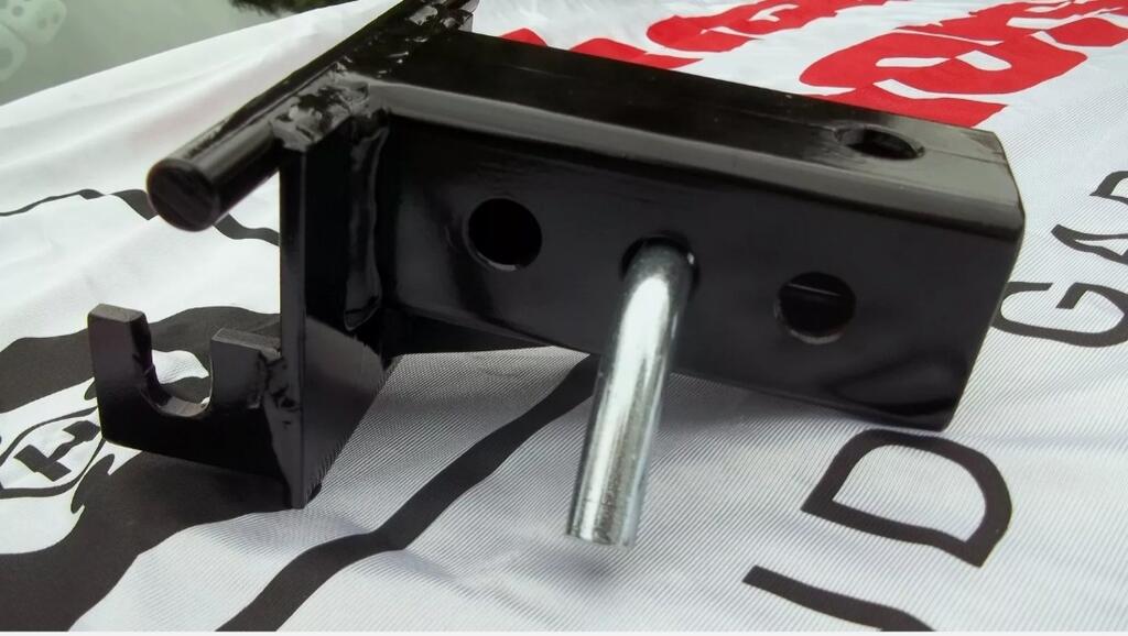

WVHillbilly520H 10,378 #4 Posted March 8, 2021 Try this... Can be welded or bolted together. Different thickness material ect. 5 4 Share this post Link to post Share on other sites
haydendavid380 759 #5 Posted March 8, 2021 21 minutes ago, WVHillbilly520H said: Try this... Can be welded or bolted together. Different thickness material ect. Is that steel or aluminum? If it's steel that some crazy thick plate to out bends in. 1 Share this post Link to post Share on other sites
WVHillbilly520H 10,378 #6 Posted March 8, 2021 Those are steel, but 1/4" would suffice, I made them to fit my weights I had. Share this post Link to post Share on other sites

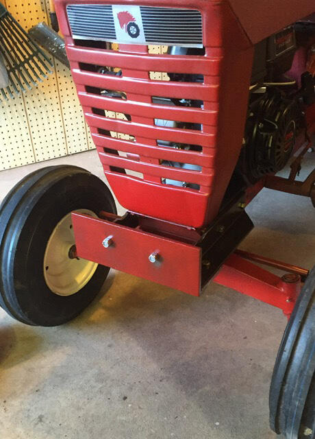

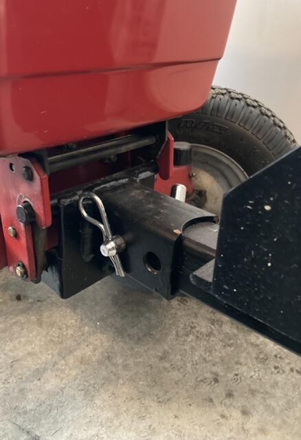

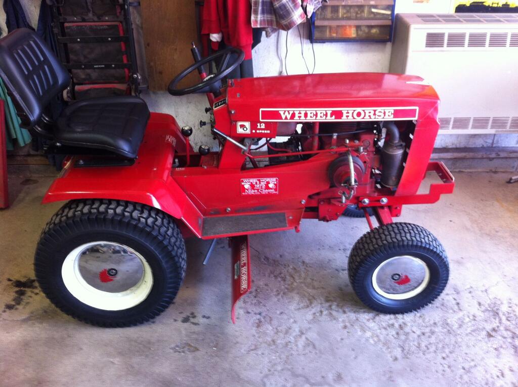

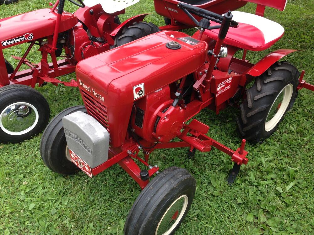

ranger 1,848 #7 Posted March 8, 2021 These are mine I put together sometime ago, (I keep using this photo on here.) they are “Fish Plates,” “Flitch Plates”, used on trucks to attach the truck bed/body to the chassis. I have loads of them, 10mm thick with 16mm holes in them, they get used on many projects. I think each one weighs about 2kg. Bolted together with long M16 bolts, one of which hooks Into the front “Attach a Matic”. It does the job at the moment, but????? 6 2 Share this post Link to post Share on other sites

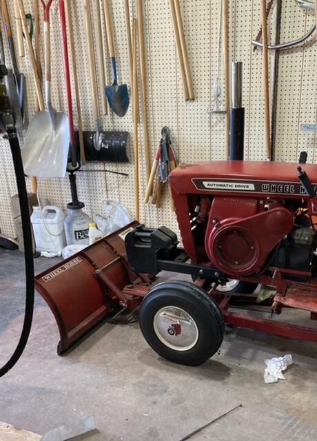

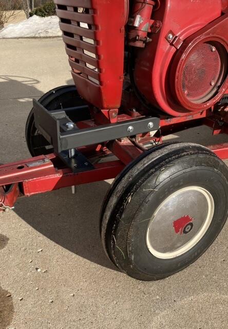

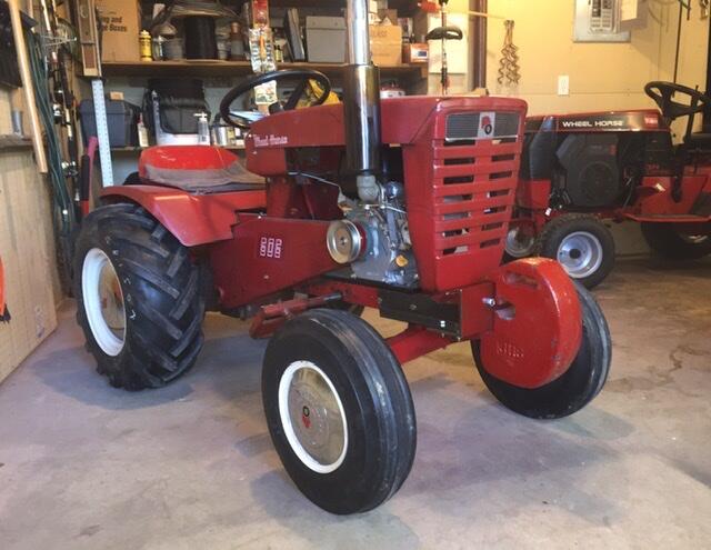

cschannuth 3,819 #8 Posted March 9, 2021 I have purchased one that will look familiar from above, I have bolted them together, and I’ve welded them. 2 3 Share this post Link to post Share on other sites

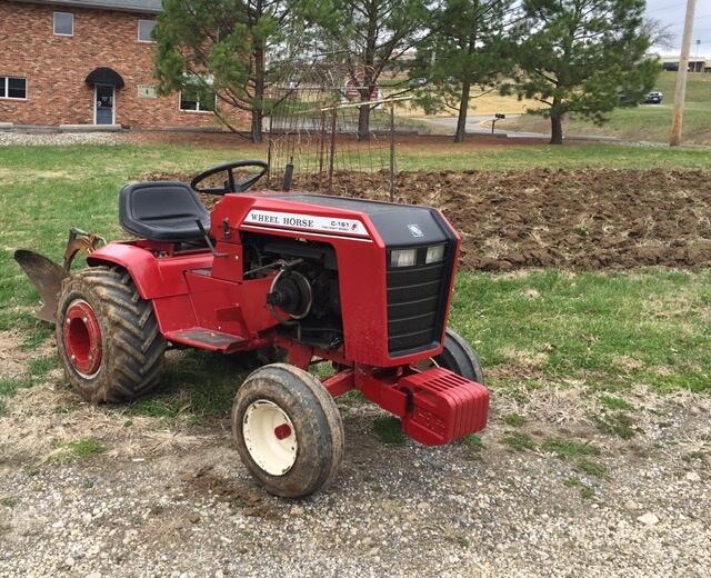

cschannuth 3,819 #15 Posted March 9, 2021 11 hours ago, ebinmaine said: Love this thread. Some very nice tractors here. So.... What do we all think is a "magic number" of pounds to have as front weight?? Anywhere from zero to about 100 pounds depending on what I’m using the tractor for. Sometimes the weight bracket just acts as a bumper for me. If I’ve got my sprayer on the back and it’s full I use a couple of 50 pound suitcase weights. On my plow tractor I’ve got 7- 10 pound weights when I’m plowing somebody’s garden. 1 Share this post Link to post Share on other sites

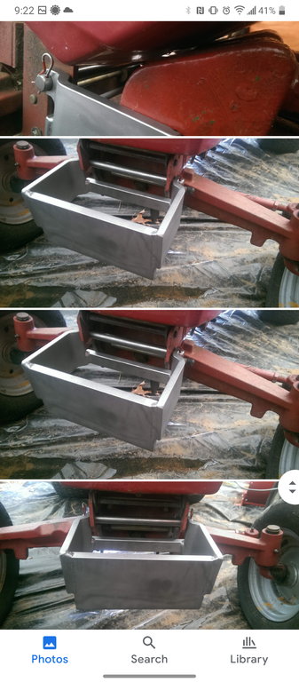

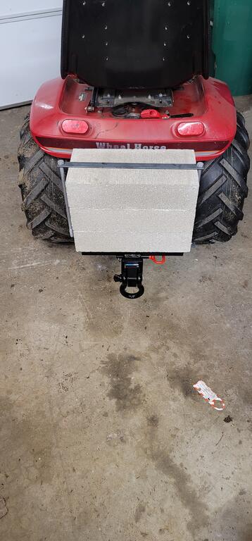

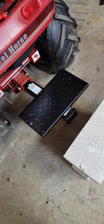

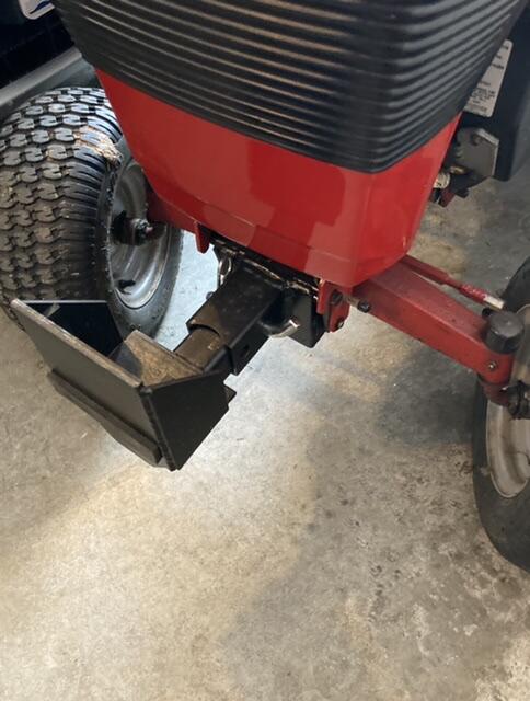

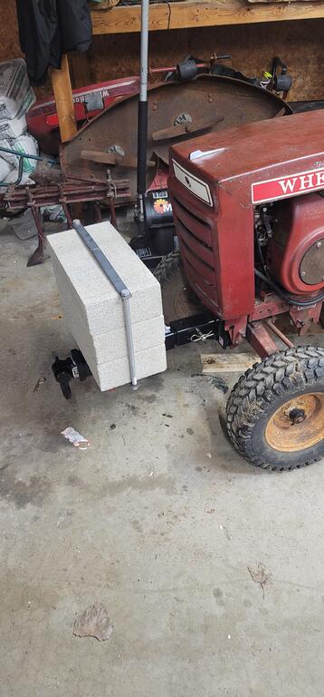

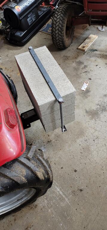

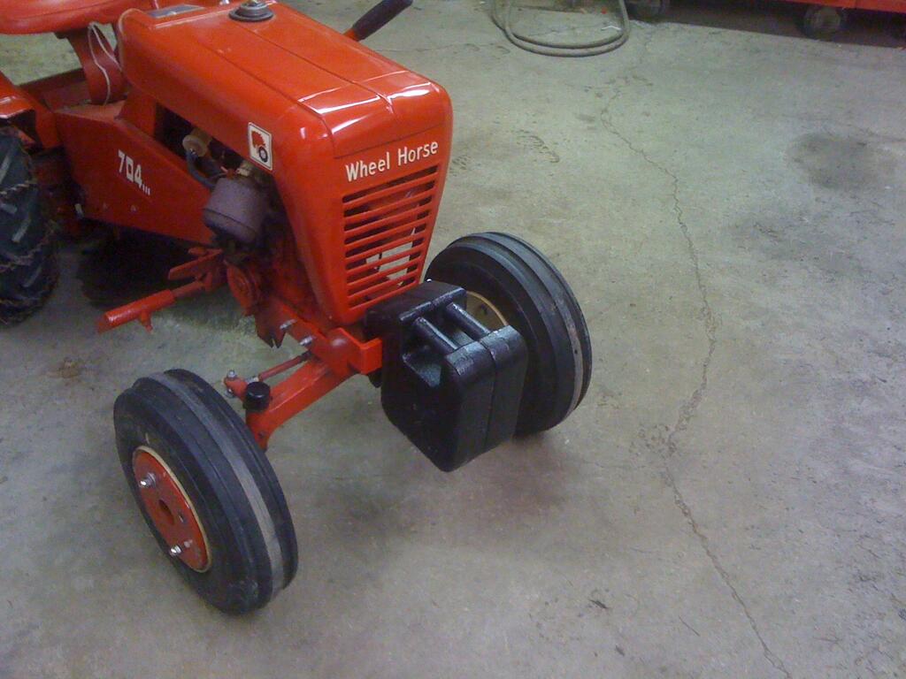

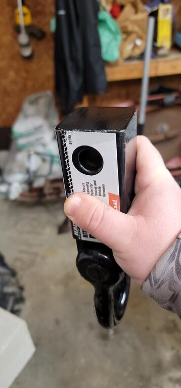

haydendavid380 759 #17 Posted March 16, 2021 Ok, so here's where I am. I spent the day trying to find something heavy. I checked CL for any suitcase weights, exercise weights anything. Came up short and settled on bricks. Cost me less than $10 versus $300+. I'll keep my eye out for something more permanent. I ordered one of these That's supposed to be here later in the week. In the mean time I stared working on the weights and brackets. I started out with one of these from harbor freight. The price of steel stock is astronomical right now, so I went with something off the shelf that was only $25. This caught my eye too, and I figure it's extra 10lbs couldn't hurt 😄 I'm trying to decide between 2 blocks and 3. I burnt up the only cheap 1/2" drill bit I had, so I'll have to wait until tomorrow to finish up, but I think this should work. 2 1 Share this post Link to post Share on other sites
ebinmaine 77,543 #18 Posted March 16, 2021 7 hours ago, haydendavid380 said: trying to decide between 2 blocks and 3 More is better in this case. Nice work. Share this post Link to post Share on other sites
haydendavid380 759 #19 Posted March 16, 2021 4 hours ago, ebinmaine said: More is better in this case. Nice work. The stated weight it 33lbs on each stone. 3 weights and and the steel I'm guessing is about 115-120lbs. I just wasn't sure how much the front tachamatic could hold. 1 Share this post Link to post Share on other sites
ebinmaine 77,543 #20 Posted March 16, 2021 3 minutes ago, haydendavid380 said: The stated weight it 33lbs on each stone. 3 weights and and the steel I'm guessing is about 115-120lbs. I just wasn't sure how much the front tachamatic could hold. I don't feel like that's a problem at all Share this post Link to post Share on other sites
haydendavid380 759 #21 Posted March 18, 2021 The front hitch bracket and my drill bits showed up. Everything is bolted up and fastened. 2 Share this post Link to post Share on other sites

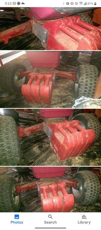

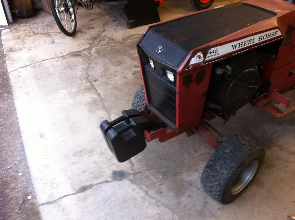

Goldnboy 1,081 #22 Posted March 22, 2021 Here is my solution to front weight bracket. Free cast iron weights that were rusty, and a bad mule drive. Bored a 1" hole in the center and used a 1" bolt to support the weight plates. I can use a variety of combinations but shown is 50#. I can easily remove by removing the lynch pin. 2 Share this post Link to post Share on other sites

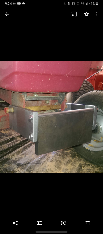

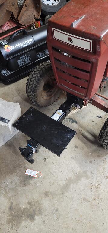

TJ5208 1,841 #23 Posted March 22, 2021 Here's my home made weight box dead battery thou battery weight is 22 lbs it's steers good when it's rolling but once and still it's really hard but I grease the spindles and the steering module so it's easier to steer 3 Share this post Link to post Share on other sites
