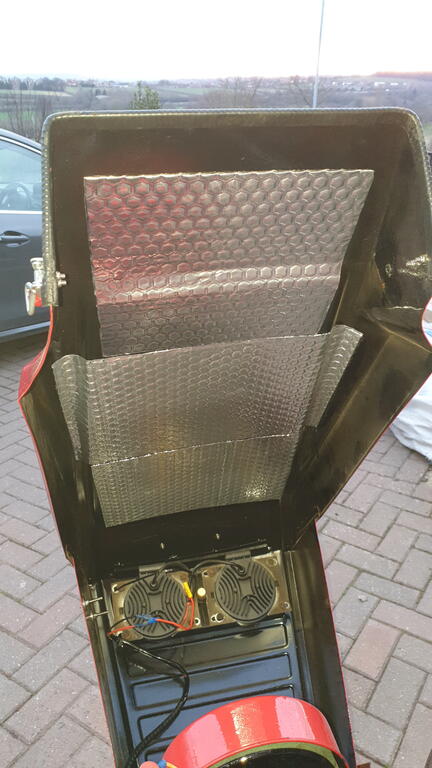

Mickwhitt 5,249 #1 Posted March 6, 2021 Ok I called it a hood, not a bonnet. So, mine rattles like a tin outhouse in a thunderstorm. The top surface flexes and bounces up and down at tick over. I'd like to brace it to stop the vibration, I have some deadening material that sticks on to the underside but do I need to make some kind of brace to stiffen the panel before I glue this stuff on. Its a problem as I can't stand my gin glass on the bonnet 🙄 Mick 4 Share this post Link to post Share on other sites

Mickwhitt 5,249 #9 Posted March 6, 2021 It is just flexing of the large expanse of flat steel panel. All pivots have been refused, vinyl door seal on the edge where it sits on the dash tower and strong clamps to hold it shut instead of those rubber stretch catches. The deadening material is specialist stuff for vehicle converters to deaden panel boom etc. I'll give it a try and report back. Mick 2 Share this post Link to post Share on other sites

Mickwhitt 5,249 #12 Posted March 6, 2021 Two minute job to cut and stick three sheets of this stuff into the inside of the bonnet. Its only 2mm thick and is a kind of bitumen adhesive with a foil top layer. It worked a treat and took out a lot of the panel bounce that was bugging me. You can see it still allows the steel to flex but it has killed the noise very much and im happy with the results. 1 2 Share this post Link to post Share on other sites
Pullstart 68,535 #13 Posted March 6, 2021 Mick, I was going to suggest sound deadening mat, but you beat me to it! Carry on! 1 Share this post Link to post Share on other sites
Mickwhitt 5,249 #14 Posted March 6, 2021 This stuff is pretty good for how thin it is. Most car bonnets have an X shaped brace welded in there to reduce the flex as well as some form of deadening mat. This stuff says it will kill panel noise as dead as a do do. 1 Share this post Link to post Share on other sites
