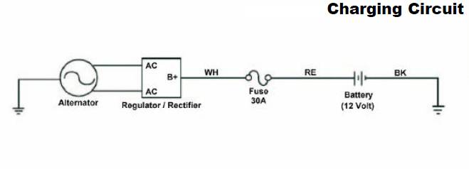

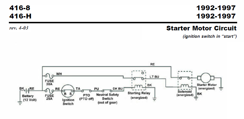

rmaynard 16,843 #4 Posted March 5, 2021 The following info is based on the 1992 - 1997 416's The only circuits where a 30A fuse is supposed to be is the charging circuit. and the starter solenoid circuit. I would be looking for something shorting out in that wiring. 1 Share this post Link to post Share on other sites

rmaynard 16,843 #6 Posted March 5, 2021 15 minutes ago, chev0545 said: 97 Thanks. I refer you to the two circuits shown above. 2 Share this post Link to post Share on other sites
