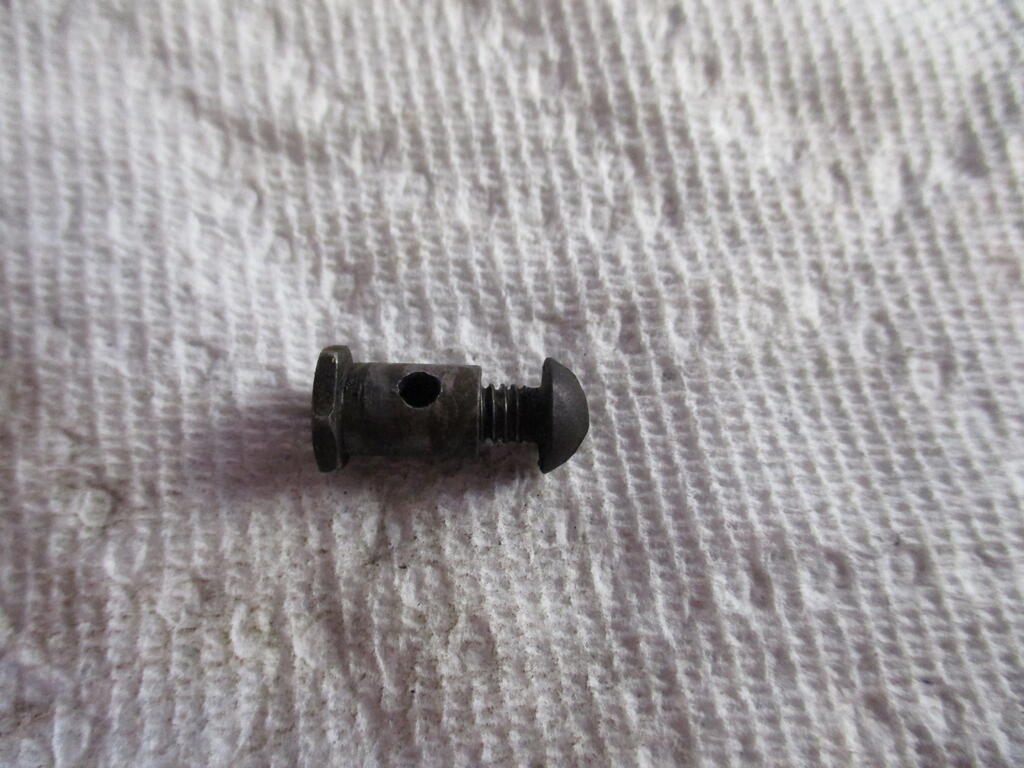

pfrederi 19,208 #1 Posted March 5, 2021 Throttle cable clamp used on big block K Singles at the end of the cable. Kohler # 4875510. Still available for only $15.83 each... I figure that they must not be that uncommon and probably available a lot cheaper from McMaster Fastnal etc...IF I knew what another name would be... Any ideas?? Share this post Link to post Share on other sites

rmaynard 16,689 #3 Posted March 5, 2021 It's called an adjustable cable clamp. 2 Share this post Link to post Share on other sites
stevasaurus 23,512 #4 Posted March 5, 2021 Looks like it would be easy to make on a lathe. I google image...adjustable cable clamp. 1 Share this post Link to post Share on other sites
littleredrider 409 #5 Posted March 5, 2021 should be able to get them a decent hardware store. Used them on go carts back in the day.... 4 Share this post Link to post Share on other sites

ranger 1,830 #7 Posted March 5, 2021 Over here (UK) it’s called a “ solder less nipple”. 1 1 2 Share this post Link to post Share on other sites

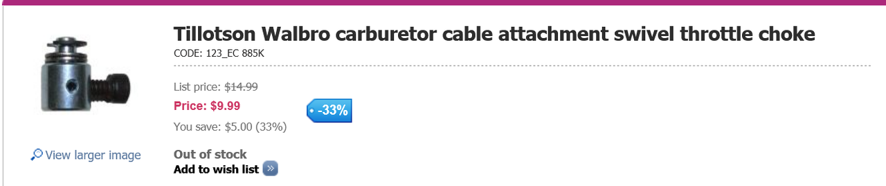

bc.gold 3,406 #9 Posted March 5, 2021 Carburetor cable attachment swivel throttle choke 2 Share this post Link to post Share on other sites
Mickwhitt 5,239 #10 Posted March 5, 2021 Yep definitely a solderless cable nipple. Only need a small lathe really, in fact I could make one of these with a drill press. Mick 4 1 Share this post Link to post Share on other sites

Mickwhitt 5,239 #12 Posted March 5, 2021 I will make one tomorrow, see how long it takes. Doesn't need the hexagonal section, just a rim to hold it in the throttle arm. Share this post Link to post Share on other sites

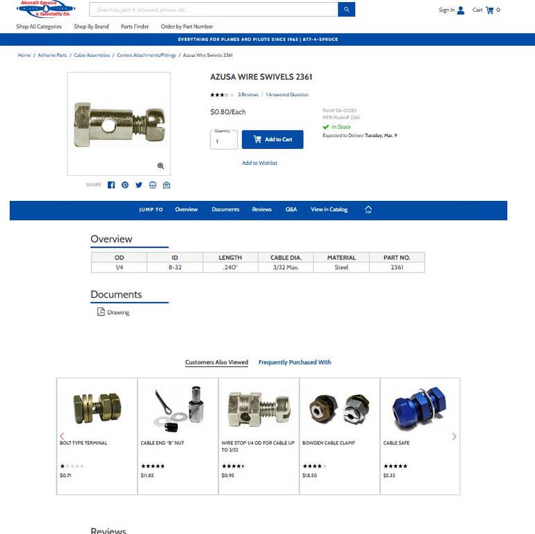

pfrederi 19,208 #16 Posted March 6, 2021 OK thank you all Good price at same place I get my Posiflo fuel pumps... Azusa 2361 Wire Swivels 3 Share this post Link to post Share on other sites

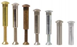

Gregor 4,847 #23 Posted March 7, 2021 (edited) Sex bolt/nut with a hole drilled in it works for me. Found at most hardware stores Edited March 7, 2021 by Gregor Share this post Link to post Share on other sites
DennisThornton 4,771 #24 Posted March 7, 2021 1 hour ago, Gregor said: Sex bolt/nut with a hole drilled in it works for me. Found at most hardware stores I managed a hardware store and had NO idea what you were referring to, saw the picture and Googled. We called those "Chicago Screws" but they didn't have the nurl. 69 and I think I still learn something here about everyday. "Sex bolts"! I'll be darned! Share this post Link to post Share on other sites
