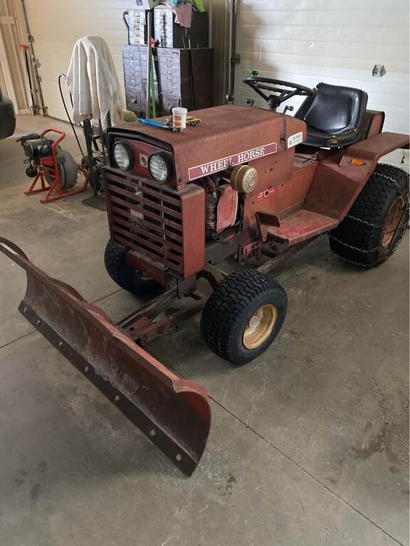

I don't know enough to know if this is original, or a Franken Horse. It says Wheel Horse 18. Appears to have an 18 HP Lp run Onan. Could be I am misinterpreting everything. Also claims to have a 3 point hitch. Did Wheel Horse have a 3 point? What ever it is, the seller sure is proud of it. Asking price, 4K. It may be well worth that, I have no idea. But it's one I have not seen before.

That'd be the predecessor to the D series.
Should be a gasoline engine. Tank is behind the seat.
3 point was an option on those and GT14... Others... C195?
I'm no expert but I'm gonna guess it's value is less than half the asking price.

its a D180. Looks original, but I'm not an expert on these either. They came with 3-point hitches as well. The price? That seems pretty steep. There is 3 for sale not far from me for $5k and are nicer than that.

953 nut
It was probably repowered with an Onan from an RV generator set. In 1973 (year of the no names) it would be the Wheel Horse 18 rather than a D-180.
