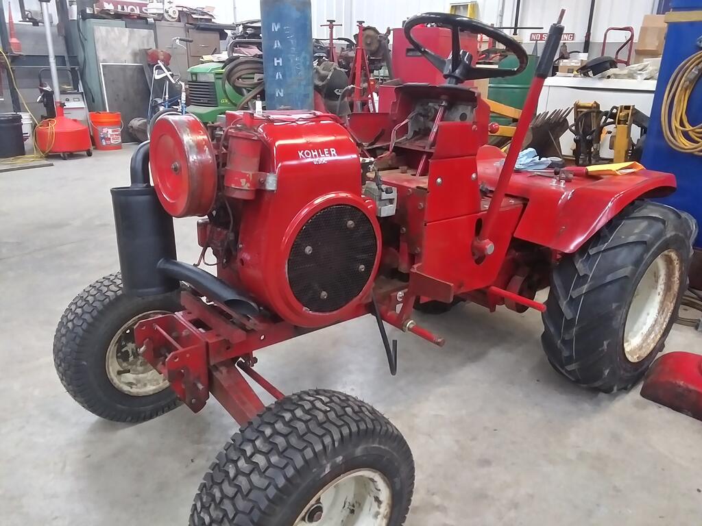

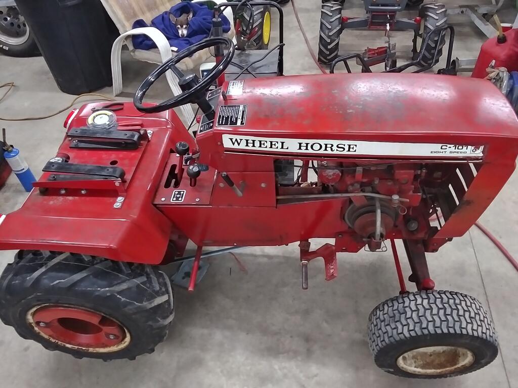

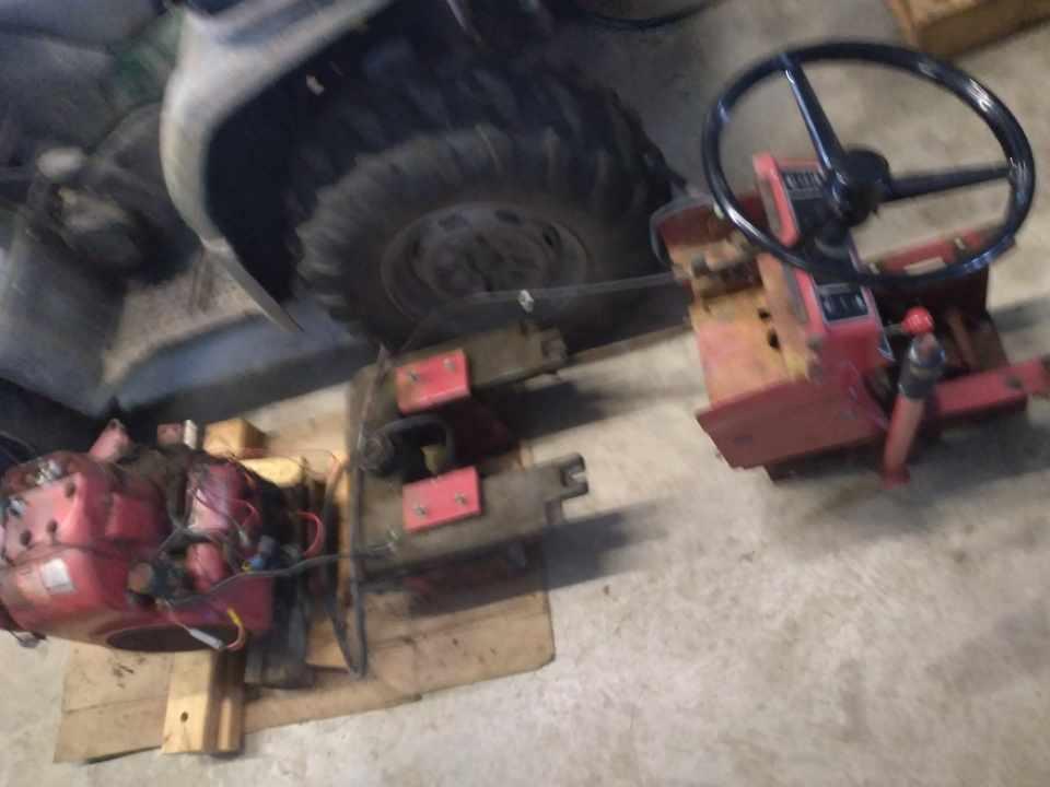

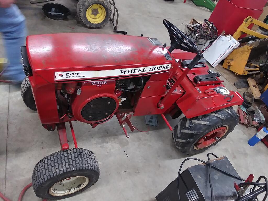

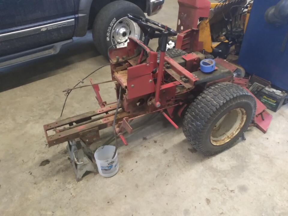

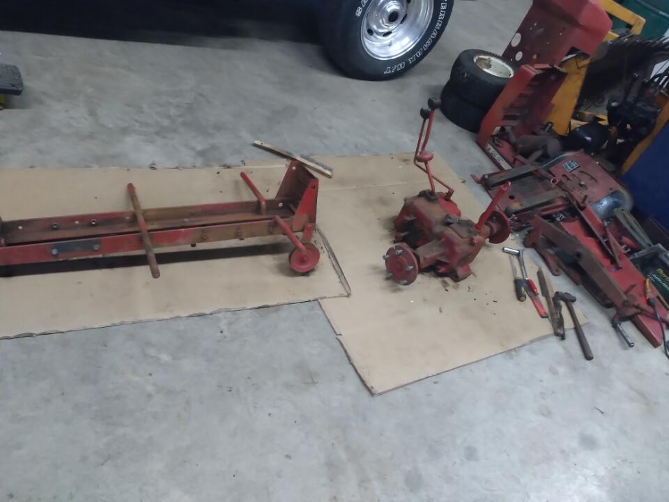

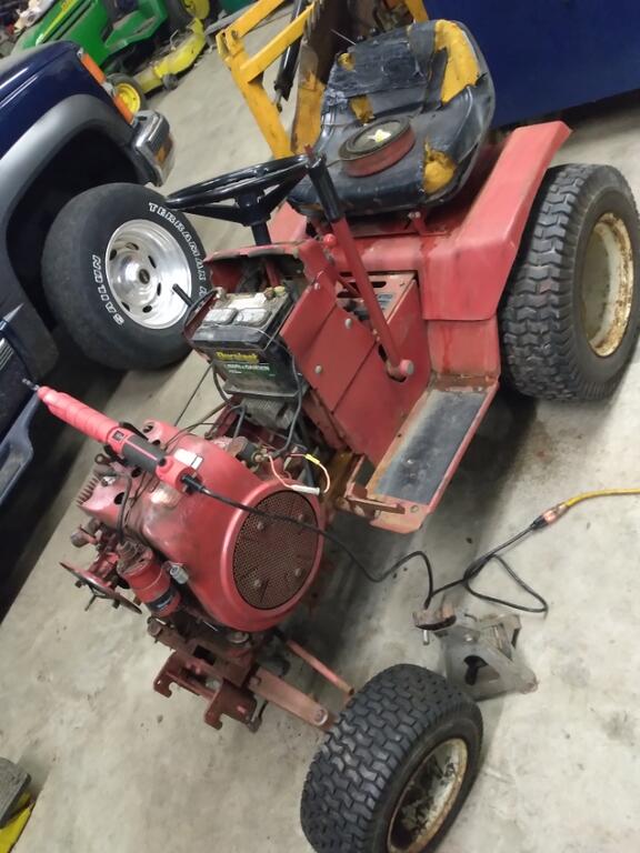

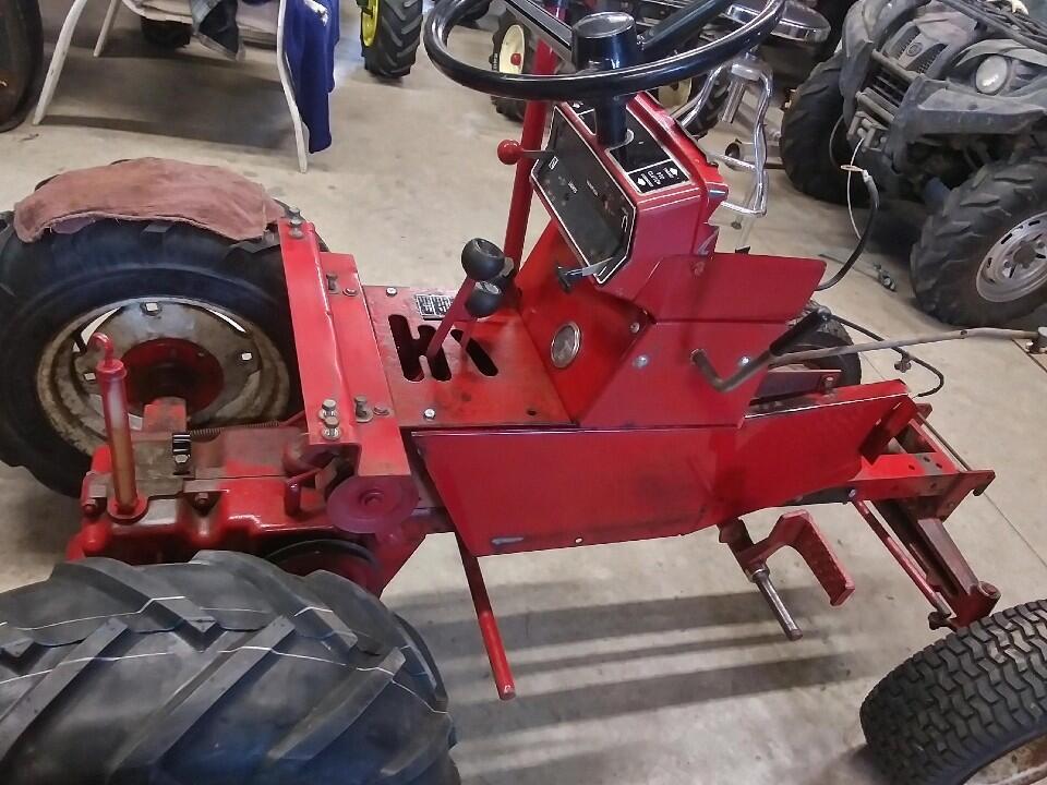

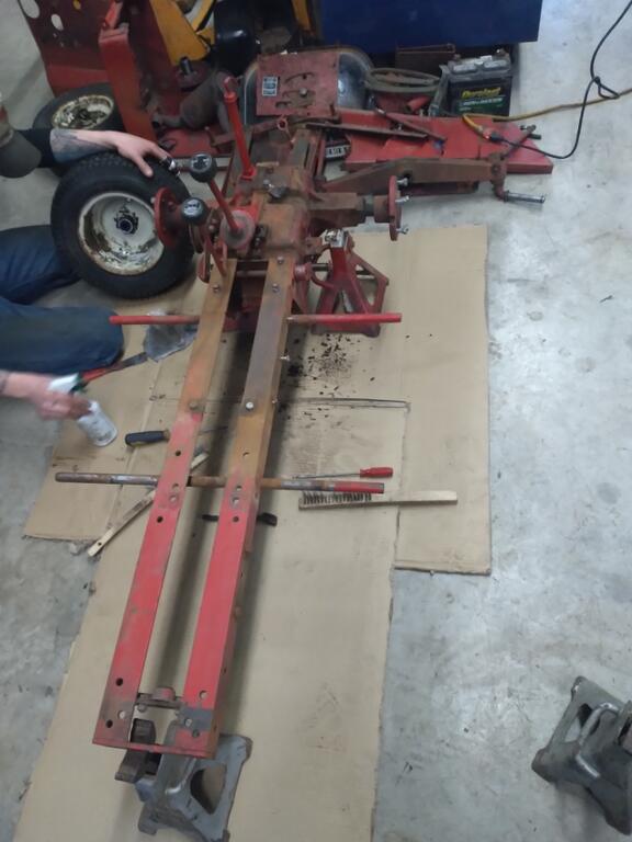

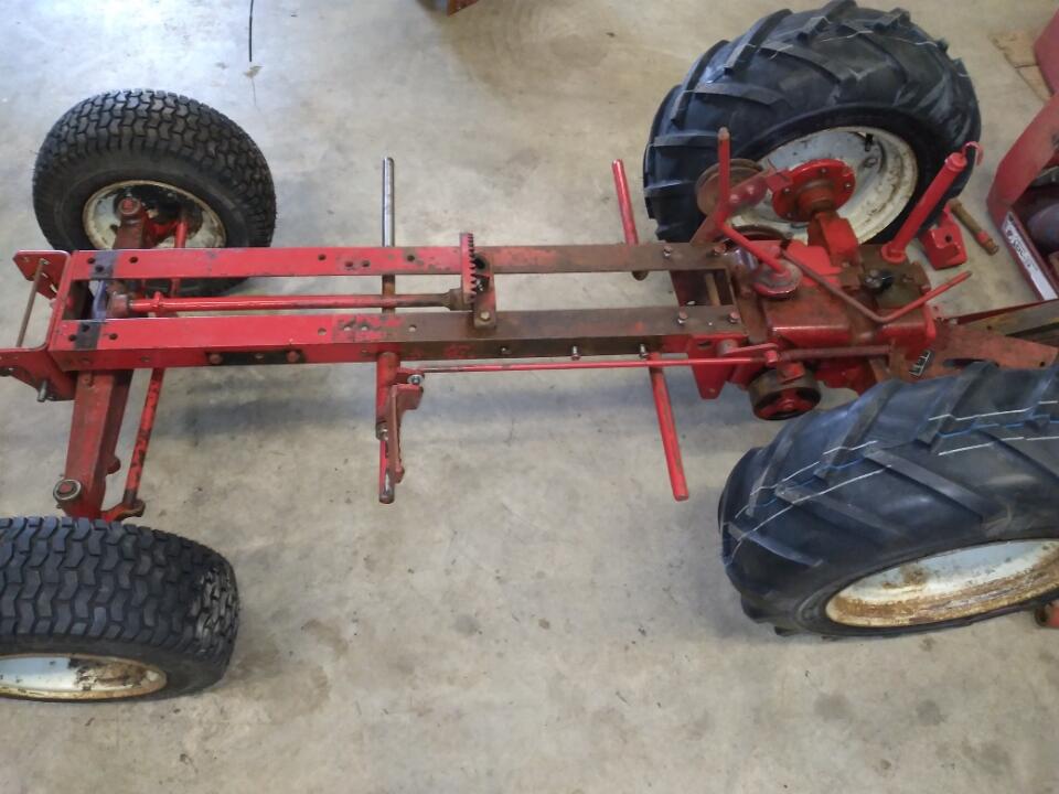

Chris G 3,363 #1 Posted March 5, 2021 A good friend of mine owns this machine. He picked it up last summer for a good deal with the mower deck and snow blower. He brought it in to change the oil and we ended up tearing it down quick and going through it mechanically and clean it up. I figured id share. We started pics after we started. But i will find a before pic. 10 5 Share this post Link to post Share on other sites
ebinmaine 74,531 #2 Posted March 5, 2021 Possibly the most thorough oil change I've ever seen. Niiiice.... 3 7 Share this post Link to post Share on other sites
Pullstart 68,170 #3 Posted March 5, 2021 Nice work Chris! Can’t help but mention, looks (in the photos) like it’s time for another set of Sailuns on the Chevy! 1 Share this post Link to post Share on other sites
Jeff-C175 7,206 #4 Posted March 5, 2021 1 hour ago, pullstart said: another set of Sailuns on the Chevy! Who doesn't love slicks on the front? I think there's more tread on them Turf Savers! 1 Share this post Link to post Share on other sites
The Tuul Crib 7,340 #5 Posted March 5, 2021 Hard to put a price on a good and thorough oil change! 2 1 Share this post Link to post Share on other sites
Chris G 3,363 #6 Posted March 5, 2021 Those tires are definitely pass there prime. But theres new rims tires and a few other things in line for that truck. Share this post Link to post Share on other sites

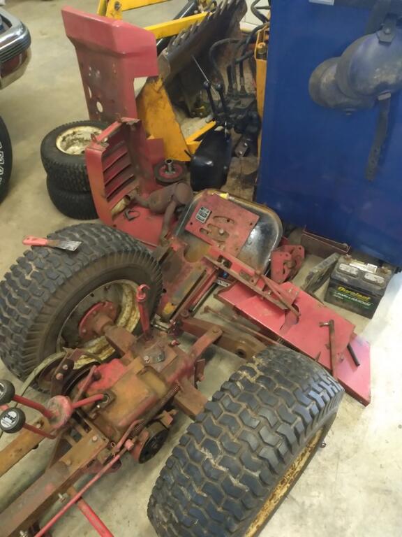

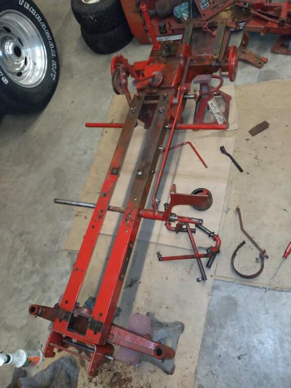

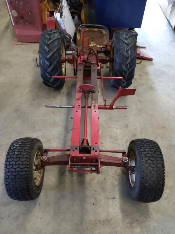

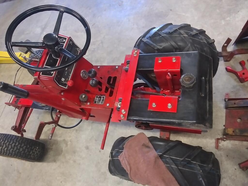

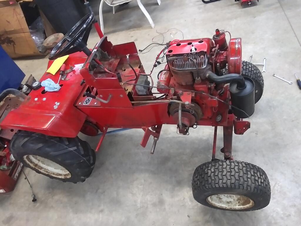

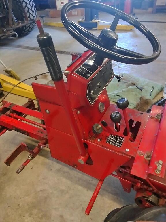

Chris G 3,363 #7 Posted March 8, 2021 Got a little more done friday. Should be back at it tommorow. 4 3 Share this post Link to post Share on other sites

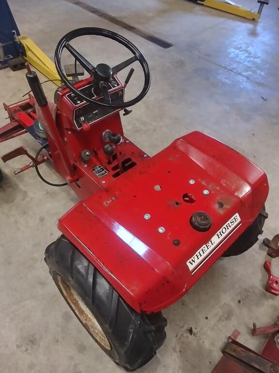

Raposo 532 #8 Posted March 9, 2021 looks great! What did you do to the factory paint? Just sand and wax or did you clear coat it? 1 Share this post Link to post Share on other sites
Chris G 3,363 #9 Posted March 9, 2021 All of the exposed paint was wet sanded and cleared. All the metal underneath or not seen, was degreased and then sprayed with a undercoating that castle makes. 1 Share this post Link to post Share on other sites
ebinmaine 74,531 #10 Posted March 9, 2021 What's the paper grit sequence ? Share this post Link to post Share on other sites
Chris G 3,363 #11 Posted March 11, 2021 Depending on how bad it is to start. I usually start with a 220 grit lightly sand. So it dont scratch to deep in the paint. Then work my way up to a 1200 grit. Then after 2 coats of clear lightly wet sand again with a 2000 grit and then final clear. Share this post Link to post Share on other sites

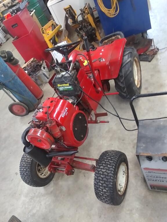

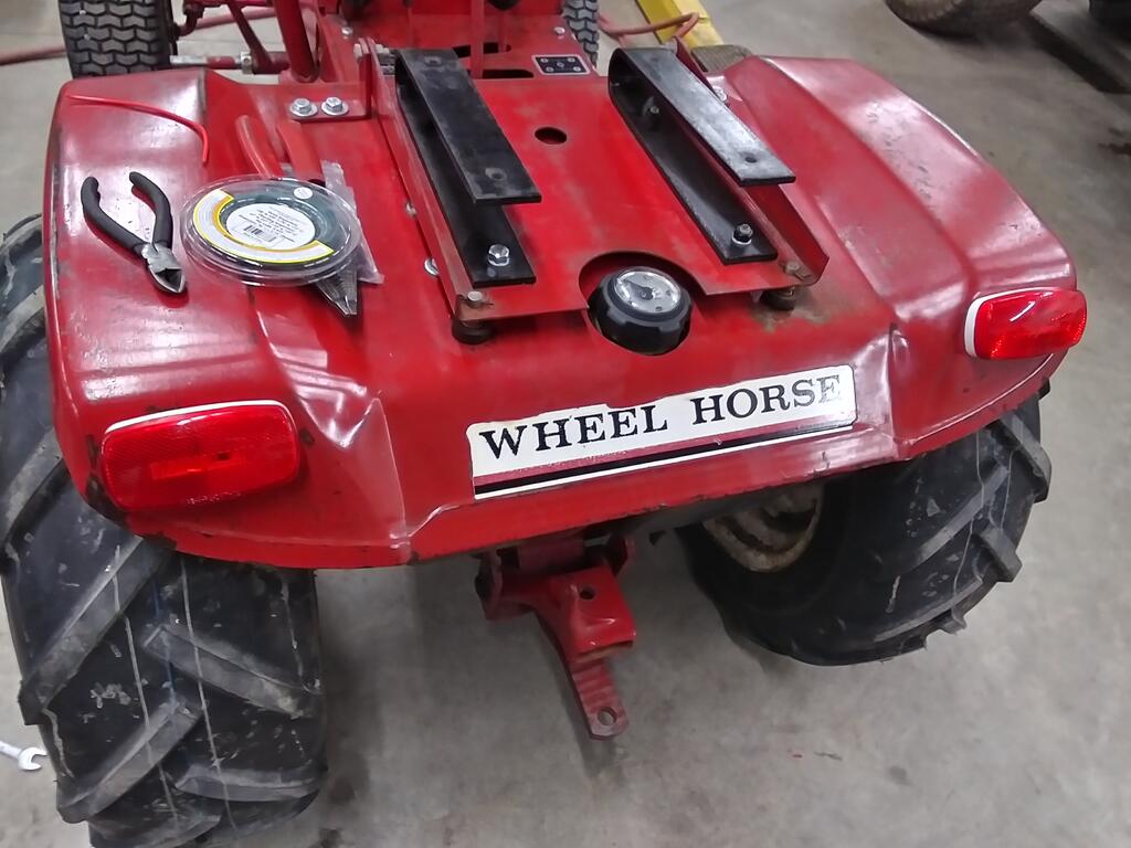

Chris G 3,363 #12 Posted March 11, 2021 Well i had it all up and running yesterday and drove it around. Now i just got ro do the final pieces and last minute touches. 1 4 Share this post Link to post Share on other sites

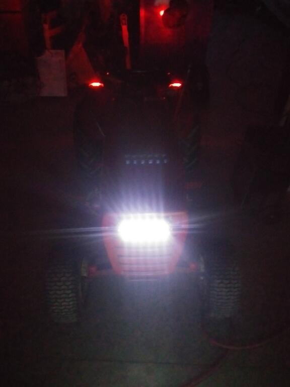

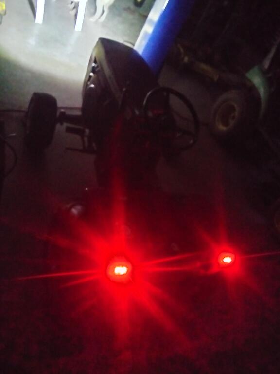

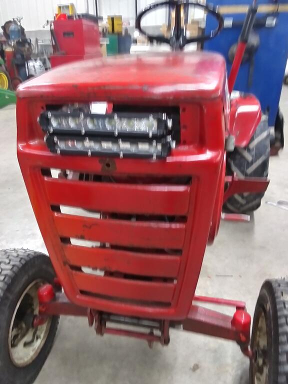

Chris G 3,363 #13 Posted March 30, 2021 Got a few more things done. Got to finalize the mounting of the front lights. But all wired up and working. Footrest and seat left. 1 2 Share this post Link to post Share on other sites
