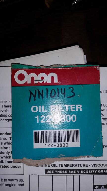

grinchsr 650 #1 Posted March 4, 2021 I think I bought the wrong filter Will this work for the P220 ? Share this post Link to post Share on other sites
Achto 29,544 #2 Posted March 4, 2021 1 hour ago, grinchsr said: I think I bought the wrong filter Will this work for the P220 ? I found this info in an old post. Toro: NN10143 Onan:122-0800 Sten:120-517 Wix-51762 2 Share this post Link to post Share on other sites
WHX?? 52,269 #3 Posted March 4, 2021 There are a bunch of NAPA/Wix filters that will fit.... some are long some are short. I use Napa 1762 but Napa 1763 is the same one but has a nut on the end. Take these into any Napa and they will cross them to a WIX. A Wix # will just have a 5 on the front end. 2 1 Share this post Link to post Share on other sites
