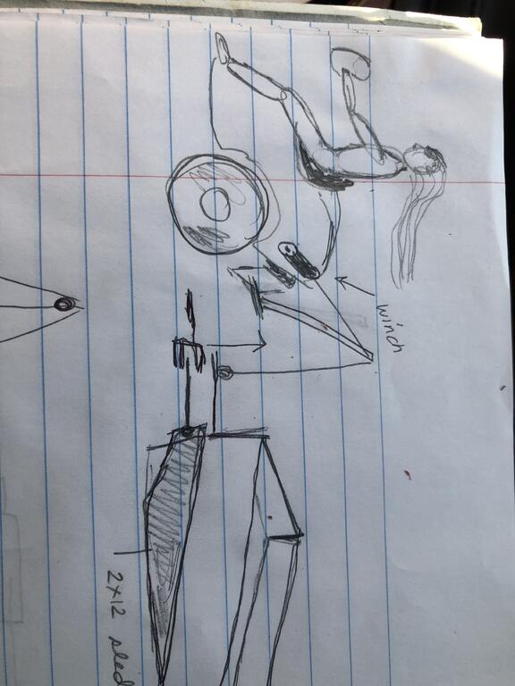

krystolo 504 #29 Posted March 4, 2021 What about a winch/hoist mounted to the back of the tractor? Kind of like Eric's dump cart. Doable? Gotta be careful not to get my hair caught in it. 😂😂😂 1 Share this post Link to post Share on other sites

ebinmaine 80,568 #32 Posted March 4, 2021 20 minutes ago, krystolo said: What about a winch/hoist mounted to the back of the tractor? Kind of like Eric's dump cart. Doable? Gotta be careful not to get my hair caught in it. 😂😂😂 Absolutely doable. There are winch mounts available for trailer hitches. That would also give you the capabilities of lifting/moving things other than the trailer. 1 Share this post Link to post Share on other sites

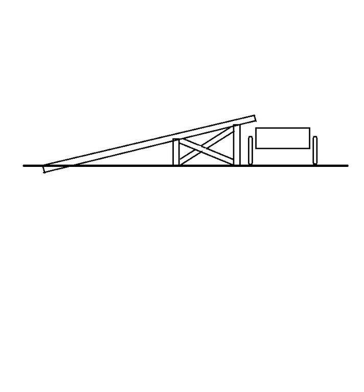

953 nut 69,066 #41 Posted March 5, 2021 When this question was asked I thought you were wanting to put in a ramp the cart could be pulled up next to. Share this post Link to post Share on other sites
krystolo 504 #42 Posted March 5, 2021 1 hour ago, ebinmaine said: You see my video above? The only thing I'd do different is use a flat strap instead of a cable. Yes! That looks perfect! could the boom be attached to the tractor near the hitch? 1 Share this post Link to post Share on other sites
krystolo 504 #43 Posted March 5, 2021 (edited) 13 minutes ago, 953 nut said: When this question was asked I thought you were wanting to put in a ramp the cart could be pulled up next to. Oh yes! That was one idea! Then someone mentioned using a piece of plywood. Push on, push off. Than I thought of plywood with sides to hold more, then sled runners for less resistance, then a dumpable sled. Lol gears were turning! awesome drawing! what materials would you suggest? Would need to be wood. Edited March 5, 2021 by krystolo Share this post Link to post Share on other sites
krystolo 504 #44 Posted March 5, 2021 1 hour ago, DennisThornton said: Yeah. I mean really. Why buy a 12v winch, run battery cables and switch when you can crank for a few seconds? The tractor has a four pin connector wired near the hitch. Thought I could plug the winch in there! I like to keep my butt in the saddle! 😂 1 Share this post Link to post Share on other sites
ebinmaine 80,568 #45 Posted March 5, 2021 18 minutes ago, krystolo said: Yes! That looks perfect! could the boom be attached to the tractor near the hitch? Certainly. Just a matter of fabricating a proper mount. 14 minutes ago, krystolo said: tractor has a four pin connector wired near the hitch. Thought I could plug the winch in there This can be done IIFF you wire the winch through a relay. The little wires feed the relay. The relay's heavy wire side feeds the winch. Share this post Link to post Share on other sites
DennisThornton 4,773 #46 Posted March 5, 2021 58 minutes ago, 953 nut said: When this question was asked I thought you were wanting to put in a ramp the cart could be pulled up next to. I think that is the best approach if possible to place the ramp! Share this post Link to post Share on other sites
