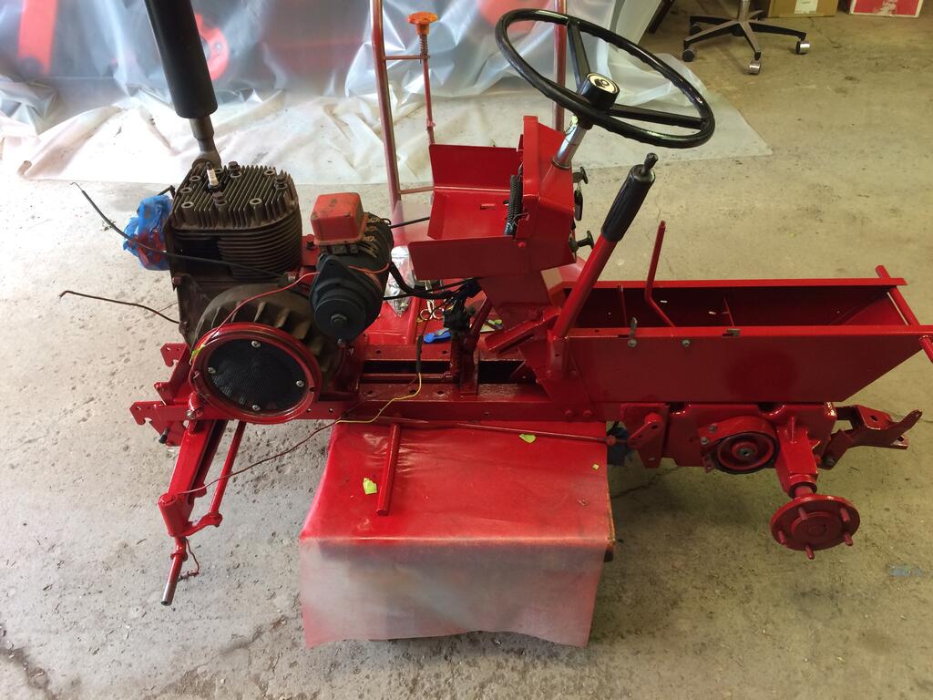

ebinmaine 77,309 #13 Posted March 2, 2021 7 hours ago, OldWorkHorse said: OK I'll will freight is set 7.95 for hole order. There web page lil sketchy so might hold off and call them on phone tomorrow. The web page is tough. I've bought from them as well as multiple other folks here. Had good luck so far. @Achto I was mistaken about the cable. It's the CHOKE cable that's too short. It doesn't wrap under the engine. Is it supposed to? Share this post Link to post Share on other sites
Achto 30,967 #14 Posted March 2, 2021 1 hour ago, ebinmaine said: It's the CHOKE cable that's too short. It doesn't wrap under the engine. Is it supposed to? It should go over the battery, slide through between the block and the aluminum bearing plate and then up to the choke. It is usually a tight fit between the block and bearing plate. I have one tractor that I had to shave some of the rubber casing off to gain clearance. Can't seem to find a picture. I'll try to remember when I get home today. 3 1 1 Share this post Link to post Share on other sites
ebinmaine 77,309 #15 Posted March 2, 2021 42 minutes ago, Achto said: It should go over the battery, slide through between the block and the aluminum bearing plate and then up to the choke. It is usually a tight fit between the block and bearing plate. I have one tractor that I had to shave some of the rubber casing off to gain clearance. Can't seem to find a picture. I'll try to remember when I get home today. Okay okay I gotcha... No worries on the pic Dan. I'm pickin up what you're putting down. 1 Share this post Link to post Share on other sites
squonk 45,492 #16 Posted March 2, 2021 You can see how it goes thru the brg plate and up thru and out on the Skonkmobile. 1 1 1 Share this post Link to post Share on other sites
