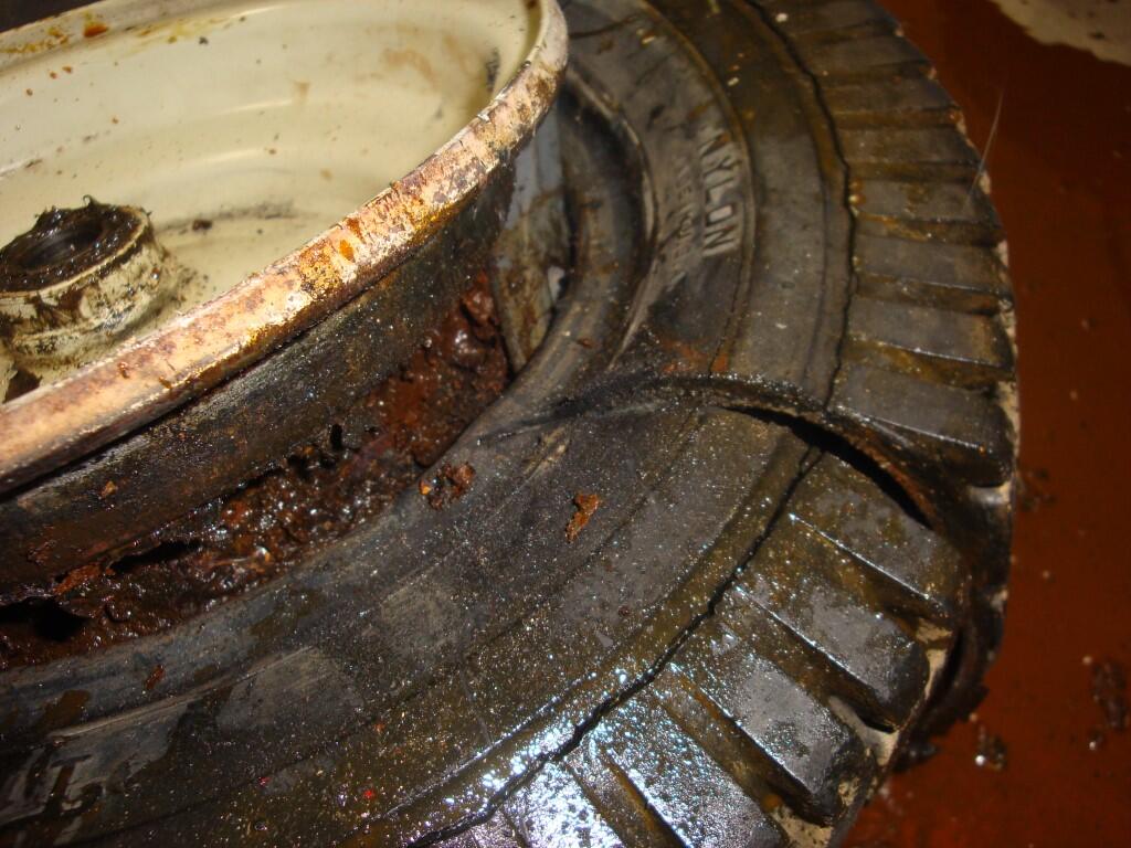

Zeek 2,286 #15 Posted March 2, 2021 (edited) 22 hours ago, John2189 said: The rim was rusty. I sanded it It has a few pits, but I didn’t think it was that bad. It’s a small 5” rim, the new tire went on very hard. I couldn’t imagine putting a tube in it. I'm not a tube guy either. I used a wire wheel, filled any problem areas with body filler, then primed and painted. Mine (new tires) held air fine, just like a car tire. When I say filled with body filler, I'm talking small pits, not major imperfections of course. The rims I did that with are pictured. They were pretty nasty when I started. The goop in the center was a combination of moisture and what looked like slime sealer (the green stuff - not bead sealer). Edited March 2, 2021 by Zeek 1 1 Share this post Link to post Share on other sites
Jeff-C175 7,206 #16 Posted March 2, 2021 21 minutes ago, Zeek said: The goop in the center was a combination of moisture and what looked like slime sealer (the green stuff Hmmm... another set of wheels badly damaged by the use of that Green SNOT. "Friends don't let friends use Slime" Mine were like that, but worse. 2 Share this post Link to post Share on other sites
Herder 2,355 #17 Posted March 2, 2021 2 hours ago, Jeff-C175 said: Hmmm... another set of wheels badly damaged by the use of that Green SNOT. "Friends don't let friends use Slime" Mine were like that, but worse. I worked for a tire company, many years ago. Most all tire sealants are corrosive and flammable. And lets not forget Toxic, keep your pets away. Share this post Link to post Share on other sites
Jeff-C175 7,206 #18 Posted March 2, 2021 (edited) 47 minutes ago, Herder said: I worked for a tire company, many years ago. Most all tire sealants are corrosive and flammable. And lets not forget Toxic, keep your pets away. I know! The product label says to inform the tire tech that you've used it so they can stand clear when the butane explodes! Slime claims to contain "RUST AND CORROSION INHIBITORS" ha ha ha ha ha haaaaaaaaaaaaaaaaaaaaaaaaaaa Edited March 2, 2021 by Jeff-C175 2 Share this post Link to post Share on other sites
