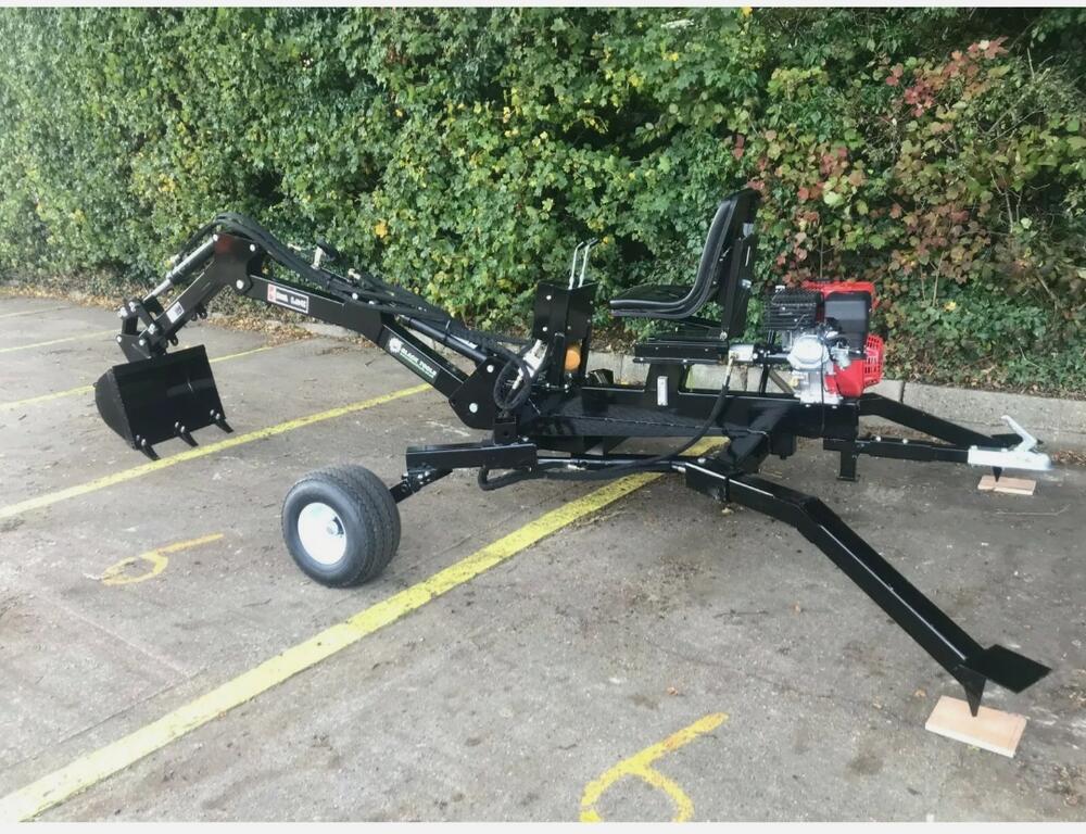

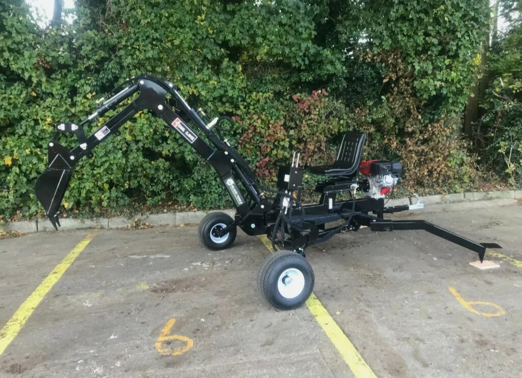

Mickwhitt 5,259 #72 Posted April 25, 2021 Saw this company in Essex selling a tow along micro excavator. Looks a neat unit, self contained and complete. not sure if it would be a candidate for mounting on a Wheelhorse. Cost just shy of £4000 so comparable with building your own I would guess. 6 Share this post Link to post Share on other sites
Wheel Horse 3D 3,826 #73 Posted April 26, 2021 14 hours ago, Mickwhitt said: Saw this company in Essex selling a tow along micro excavator. Looks a neat unit, self contained and complete. not sure if it would be a candidate for mounting on a Wheelhorse. Cost just shy of £4000 so comparable with building your own I would guess. Not sure of the current exchange rates, but i priced those over 3k US and still to modify. If i could score one around 1.5k id consider that, but i havent been seeing any used units. Share this post Link to post Share on other sites

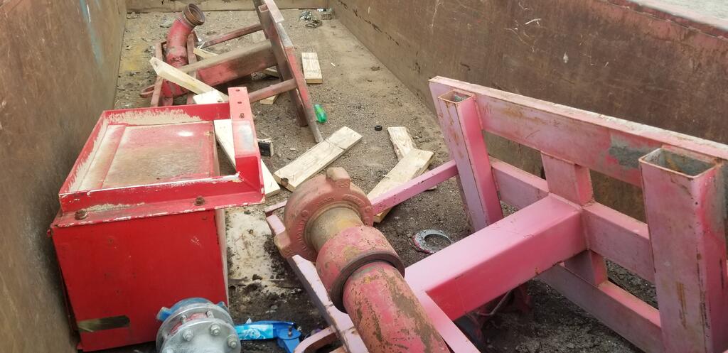

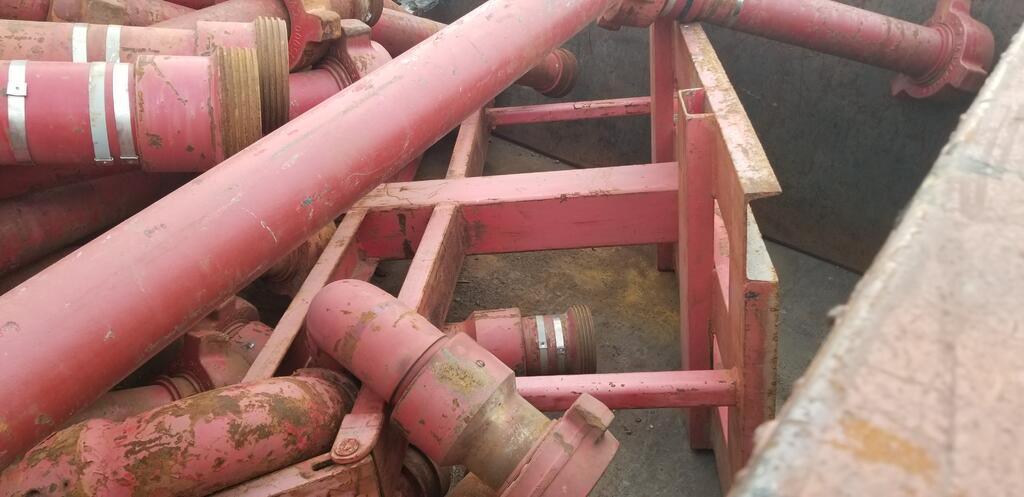

Wheel Horse 3D 3,826 #75 Posted April 28, 2021 Did a little stroll around to the metal scrap bins at work today... 2 Share this post Link to post Share on other sites
