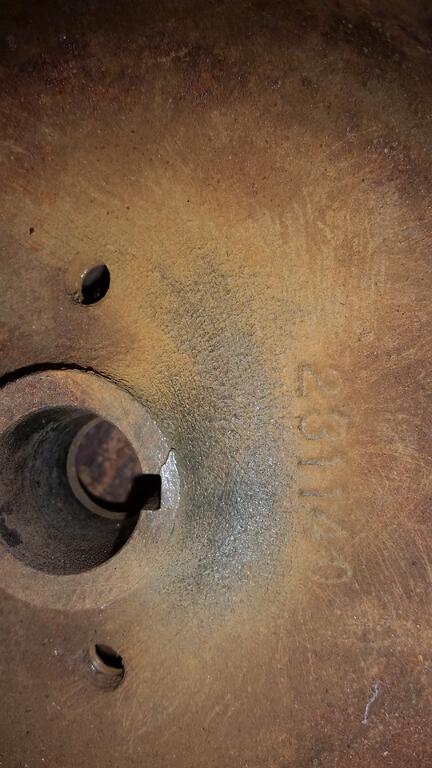

squonk 48,322 #26 Posted February 24, 2021 Spray it with carb cleaner and go have a couple of brewski's. The crack will show up and you'll be using that flywheel for an ashtray. 4 Share this post Link to post Share on other sites
DennisThornton 4,773 #27 Posted February 24, 2021 1 hour ago, Gregor said: I'll never use a rattle gun on a flywheel again. Learn something new everyday. I was able to get a new flywheel for my K161 from Lincoln. Hopefully my wife will let me use one of her torque wrenches. Impacts are great in reverse! Got to be careful or grab another wrench for the other direction. 1 1 Share this post Link to post Share on other sites
Pullstart 71,516 #28 Posted February 24, 2021 48 minutes ago, squonk said: Spray it with carb cleaner and go have a couple of brewski's. The crack will show up and you'll be using that flywheel for an ashtray. Uncle Jim’s an hour behind us, ya know... well... never mind... it’s Uncle Jim. 2 Share this post Link to post Share on other sites
8ntruck 9,381 #29 Posted February 24, 2021 (edited) 1 hour ago, squonk said: Spray it with carb cleaner and go have a couple of brewski's. The crack will show up and you'll be using that flywheel for an ashtray. Or spray with penetrating oil, let it set 5 to 10 minutes, then spray with carb cleaner to clean the surface, then sprinkle with talcum powder. The powder will draw some oil out of the cracks and make them visible. Dye check kits do the same thing, but with red dye instead of the oil and an aerosol spray powder. Edited February 24, 2021 by 8ntruck 2 Share this post Link to post Share on other sites
DennisThornton 4,773 #30 Posted February 24, 2021 16 minutes ago, 8ntruck said: Or spray with penetrating oil, let it set 5 to 10 minutes, then spray with carb cleaner to clean the surface, then sprinkle with talcum powder. The powder will draw some oil out of the cracks and make them visible. Dye check kits do the same thing, but with red dye instead of the oil and an aerosol spray powder. I had forgotten that trick! Thanks! 1 Share this post Link to post Share on other sites
squonk 48,322 #31 Posted February 24, 2021 (edited) Late 80's 4bbl GM305 engines. Using antifreeze with no sign of a leak. Pull the intake. Spray the lifter valley with carb cleaner. go have a cup of coffee. Come back and there are the cracks! (Same thing with the 3.1 V-6 only it was the rear driver side cylinder) Edited February 24, 2021 by squonk 1 Share this post Link to post Share on other sites
WHX?? 58,347 #32 Posted February 25, 2021 (edited) Crap.... ..... strike two..... off of Dan's carcass. Found one on fleabay for 60 clams but keep yours on hot standby Kev. Seller says its for a JD 110 but has same casting numbers. I would paint it Red tho. I would be booted out the club I bought would I? Edited February 25, 2021 by WHX24 Share this post Link to post Share on other sites
DennisThornton 4,773 #33 Posted February 25, 2021 31 minutes ago, WHX24 said: Crap.... ..... strike two..... off of Dan's carcass. Found one on fleabay for 60 clams but keep yours on hot standby Kev. Seller says its for a JD 110 but has same casting numbers. I would paint it Red tho. I would be booted out the club I bought would I? Darned! Wonder why it's available? Share this post Link to post Share on other sites
WHX?? 58,347 #34 Posted February 25, 2021 (edited) Guy had specific pics of the keyway area Dennis ...I don't wanna post a .... club rules ya know. Evidently this flywheel was used on a few spec engines. Edited February 25, 2021 by WHX24 1 Share this post Link to post Share on other sites
