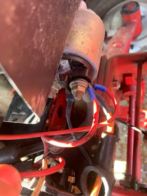

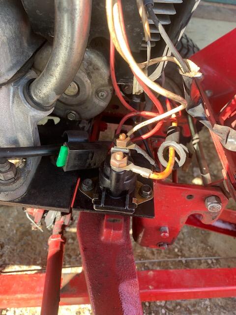

CB520HC 61 #1 Posted February 21, 2021 good morning all red square folks ive been poking around this forum for about 8 months now and it has been a huge help in getting my c-175 auto swapped to a k341 but this question pertains to my 88' 520 hc it is currently wearing the plow and couple nights ago I was cleaning up neighbors driveway parked the tractor and next day I went to go move it and it would not crank with the key. But it did start when I jumped the frame mounted relay. i removed the relay and took it inside over night to see if maybe it had frozen internally but this did not change anything. I went through and checked all my fuses and swapped for new just to be sure they were not the issue. I am starting to think that I have a safety switch that went bad but am not sure which one affects this condition was wondering if anyone had a link to a desympton guide for this model or was unsure if it was identical to the 520h? any input or info on this would be amazing and I'm hoping that I'm following guidelines. Thank you in advance 1 Share this post Link to post Share on other sites
JoeM 9,327 #3 Posted February 21, 2021 May or may not be it but wiggle the PTO handle, I seen that one stump seasoned WH repair guys.! And if you have a 12v test light see if you are getting power to the solenoid, at the control terminal with the key in the start position. That will tell you which way to go. 1 Share this post Link to post Share on other sites

CB520HC 61 #5 Posted February 21, 2021 okay i will give this a look and go from there ill let you guys know what i find thank you for the quick responses 1 Share this post Link to post Share on other sites
