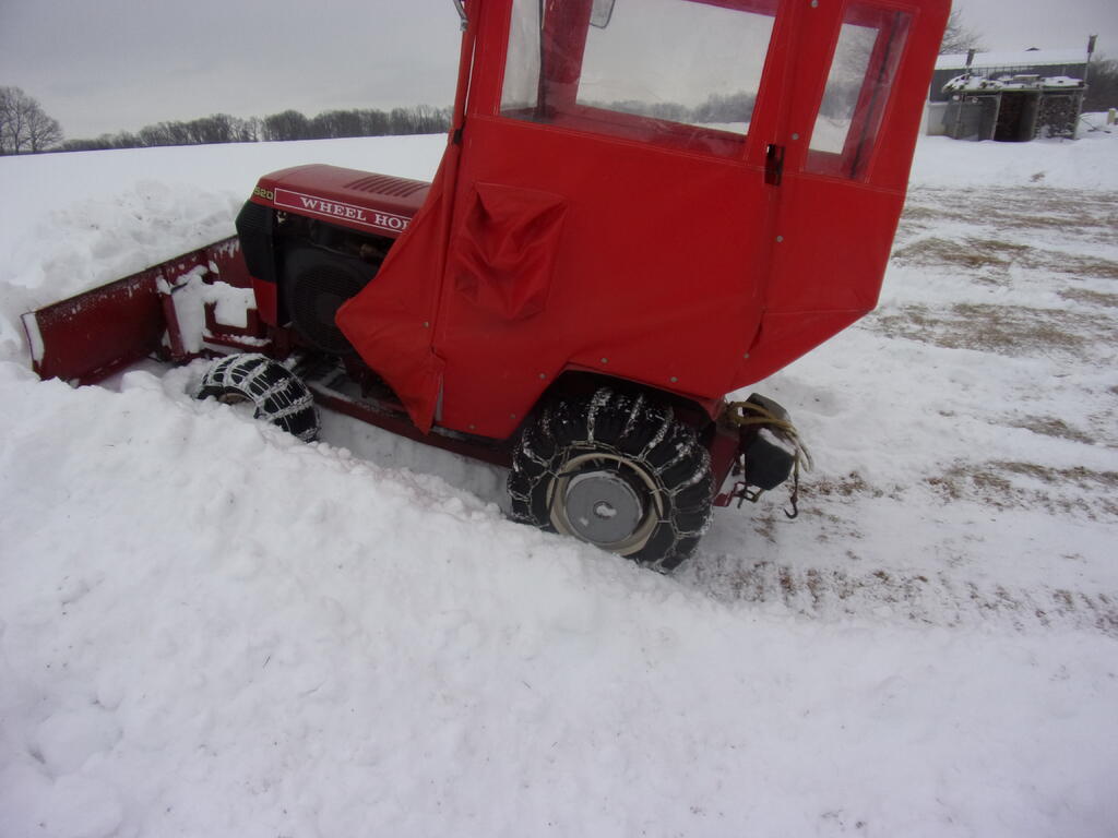

BeninCT 451 #1 Posted February 20, 2021 (edited) Lots of chatter about front tire tread pattern, front tire chains and roller chain and as I plow into the street with my tires at 45 degrees and the tractor still going straight ahead I am wondering about the same thing lately. So, here is my thought/question: I have a donor tractor and was thinking I might cut the front tires off the wheels maybe leaving 1 1/2 or so of sidewall after the tread, stud them with sheet metal screws and use them like a sleeve that fits OVER my current front tires held in place with a couple zip ties or maybe just deflate/inflate trick. Anyone ever done this? Worried that roller chain will make a mess of brand new paving and think this could be “free” since I have a bucket of sheetmetal self tapping screws and the old front tires already. Worst case I could even buy new front tires and cut them up. Mine are 15x6x6 so I think a 16 x 6 tire would be a good size for the sleeve. Edited February 20, 2021 by BeninCT 1 1 Share this post Link to post Share on other sites

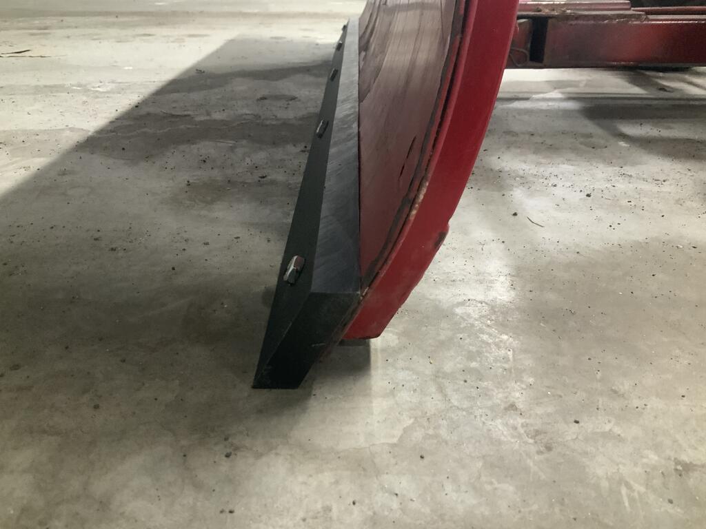

wallfish 19,461 #9 Posted February 20, 2021 Good idea but doubtful studded screws would do less damage to asphalt than the roller chain if that's the main concern. The roller chain is only about $20 or so and added weight will help keep them from sliding sideways on the driveway more. It's the side sliding that leaves the most marks so if you notice the tractor sliding with the roller chain or the studs, stop taking such a big bite to keep the tires rolling forward. If you're still using the steel scraper bar and not something else like PVC for the scraper then that will leave more scrape marks than the chains or studs do. AG lug tires have enough depth in the treads to just stud them. Bicycle chain is too small and it will roll on the tire and roll off. Not sure if the tire cover would do the same, they would need to be anchored well to the tire. 3 Share this post Link to post Share on other sites

Ed Kennell 45,219 #15 Posted February 20, 2021 My experience...Rubber has more traction than steel on plowed bare paved surfaces. Without question on packed snow, ice, and unpaved surfaces, 2 link V-bar steel chains on turfs will outperform rubber. 5 Share this post Link to post Share on other sites
DennisThornton 4,773 #16 Posted February 20, 2021 29 minutes ago, Ed Kennell said: My experience...Rubber has more traction than steel on plowed bare paved surfaces. Without question on packed snow, ice, and unpaved surfaces, 2 link V-bar steel chains on turfs will outperform rubber. Same on any hard surface. If the chains can't bite or dig into a surface they don't help but slide instead. Much rather have bear rubber on bear hard surface than chains. But! I've never been stuck with chains on a hard surface, just slip around a little bit. I've got V-bars on my blower but not on the pusher that I use almost all the time. Something wrong with that... Think it's time for another set of good HD 2 link V-bars. 2 Share this post Link to post Share on other sites
