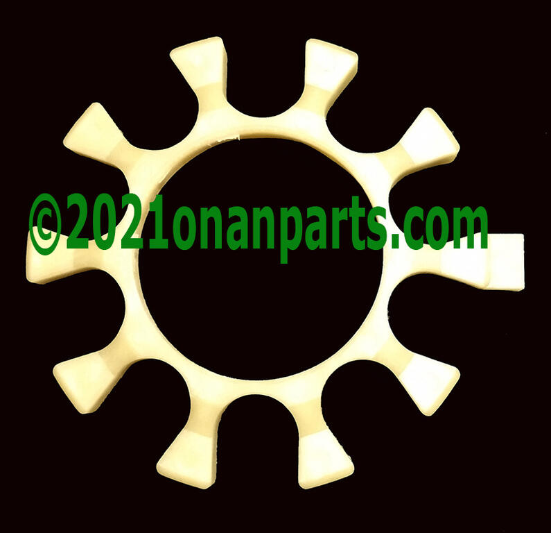

On 2/20/2021 at 8:49 AM, gcole said:
The onan engine does run, it revs to the moon as soon as it fires up. I’m all but sure it’s the flyball spacer for the governor balls slipping. Problem is, I’ve had zero luck locating one to replace and locktite on. The one in it is the plastic one and I’d like to update to the metal one. This is the second onan I’ve owned that has this problem. I’m up in Canada also so a lot of the engines you guys have access to are much more expensive and harder to get ahold of up here
I have several New, not used, long finger OEM Onan Spider/Spacers in stock at this time. A few more might come along soon. We do plan to manufacture them maybe later this year. Nylon/Plastic is most likely. The OEM Nylon ones have held up for decades and thousands of hours before any issues came up. Since the long fingered ones can't turn or rotate they are/were less prone to cracking/breaking. Millions still on the job with no failures, but they getting very long in the tooth....
For the record the OEM spiders/spacers were made of Celanese 1503-1 or 1503-2 Nylon or Zytel 70G-33 HSI-L Nylon.
Metal spiders are possible too in our future plans but the cost would be much higher than Nylon/Plastic or a comparable material. This has been a long term back burner project....
gcole,  PM me if interested in a New OEM spider. I will hold one back a few days to give you a chance to respond. We ship to Canada all the time. :)

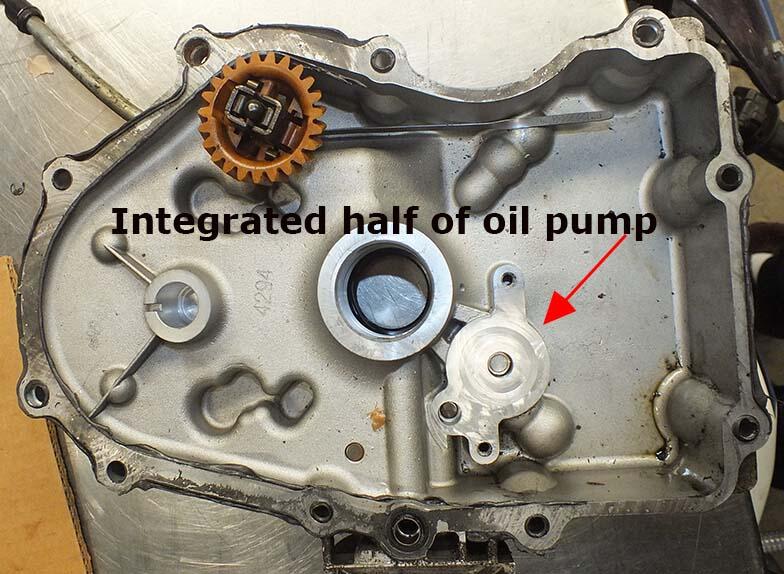

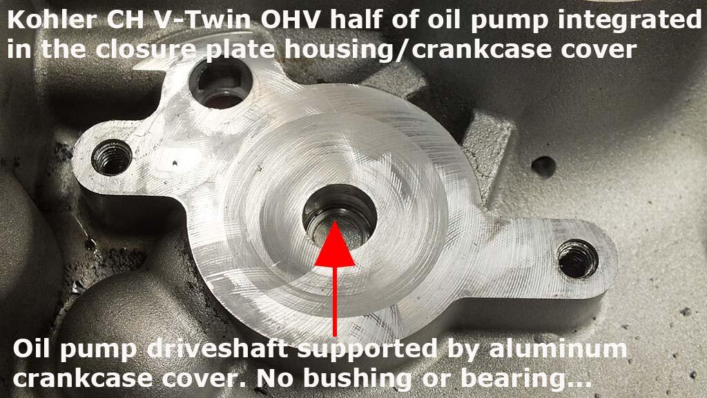

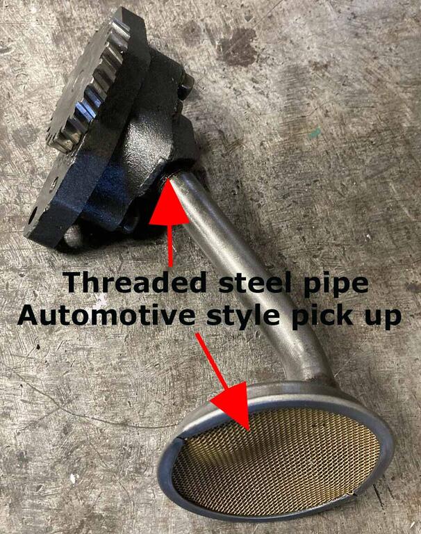

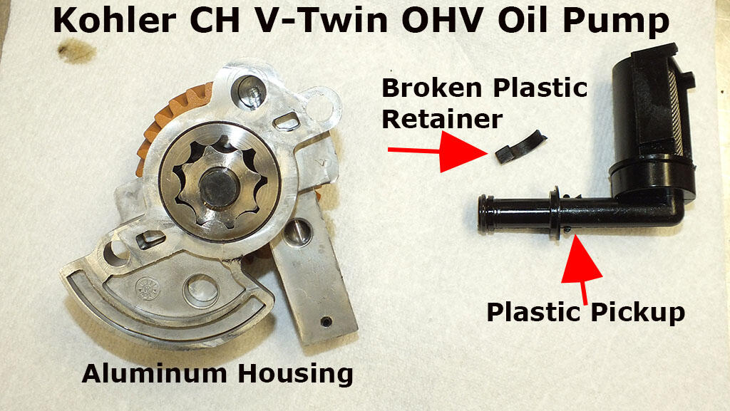

18 hours ago, Skipper said:
If you want to go gas engine, I would look for a low hour kohler v-twin. Much more modern, rock solid, and it will outperform any of the old engines. Something like what you find in a 522Xi or newer. As said, remember to go electric clutch.

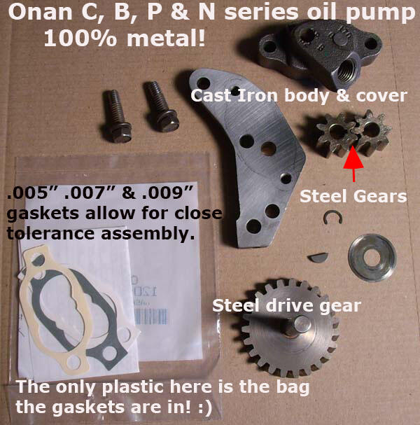

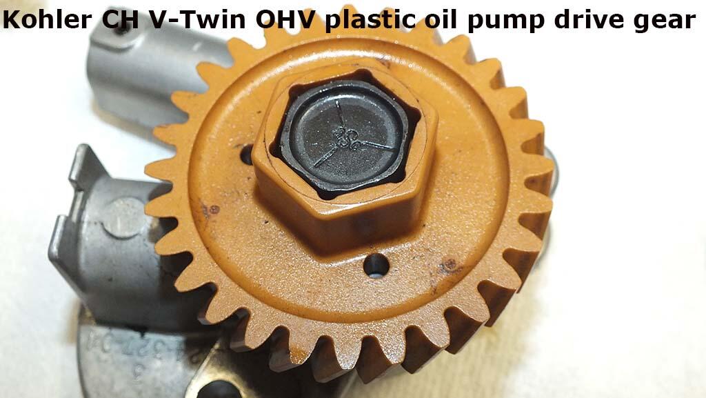

Several folks here have hit on the cheap "Modern" engines with plastic gears etc. Kohler V-twin is rock solid and will "outperform" any of the old engines? Seriously? Not a chance! Pure BS! I've posted these internal Kohler Vs. Onan pics on many threads and forums, here they are again. Judge for yourself....
There are no "bearings" main or cam in a "Modern" Kohler engine. Here is a look inside a "Modern" Kohler V-Twin. The "Aluminum engine block" is the bearing surface for the cam and crank. Unlike the Onan, there are no replaceable bushings, bearings or sleeves etc. None! When worn or damaged, you toss the engine in the scrap pile to be recycled. When the plastic geared aluminum oil pump fails, it most likely will take out or damage those cam and crank bushing surfaces, and the crank and cam too. Since it's a disposable engine, no need to worry about getting parts for it....Pictures are worth a thousand words they say...hopefully folks that choose to "Repower" get some use out of  "The Modern Kohler" or any new disposable engine before it becomes beer can material....
Onan industrial engines are and were made to be rebuidable and repairable. They will "outperform & outlast" any "Modern" disposable repower engine.

Skipper
4 hours ago, onanparts.com said:
Here we go again. Yes, I have indeed seen you have this exact same argument before with other people. And I understand that you are protecting the engine you sell parts for, but seriously, yes!
I'm not saying a Kohler command V-twin is the best engine ever build, just that they (despite your effort to prove otherwise), usually have a long and trouble free life, use less gas the more modern they get, and certainly less than the older opposite twins did. Parts are readily available and fairly cheap. They seem to always just run good. In fact I have newer had one thru the shop that ran less than stellar, and if you do a simple Google search, it don't raise flags with heaps of common problems etc. either. Plus the power they deliver is absolutely sweet too. So yeah, for a second hand low hour gas engine swap, I would surely go for that, all things considered.
I apologies for using the fraise "rock solid". All engines can go boom, or have parts fail, so that's obviously wrong. But I hope we can agree, that some do it more than others...............
I'm not saying an Onan is a bad engine. Nor that it shouldn't be rebuilt if that's the sensible choice for OP. Just trying to go by the facts, and less by the religious craze. Onan undeniably has it's problems too, especially in garden tractor applications, and that IS a well documented fact.
I am not going to contribute further to this, as you put it so nicely, BS! :deadhorse:

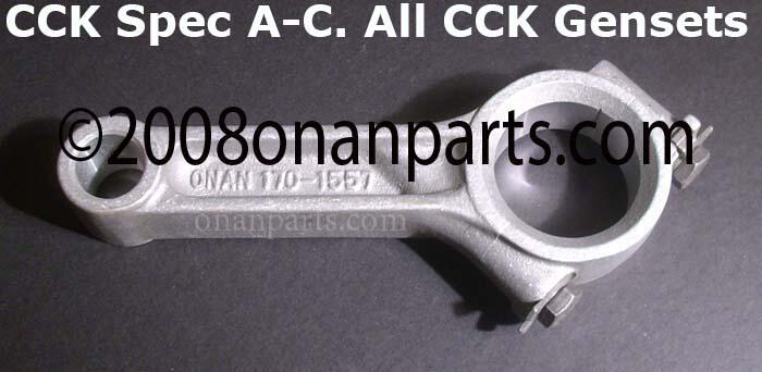

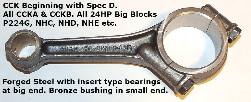

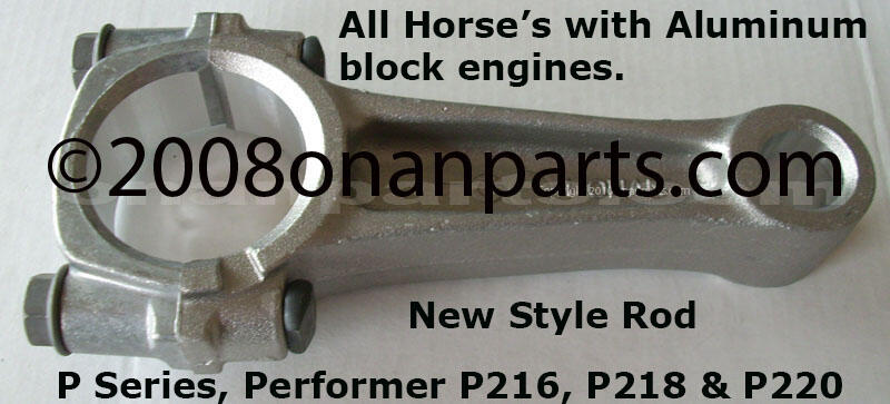

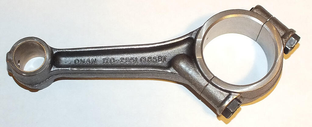

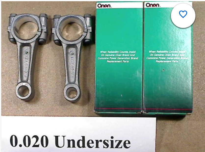

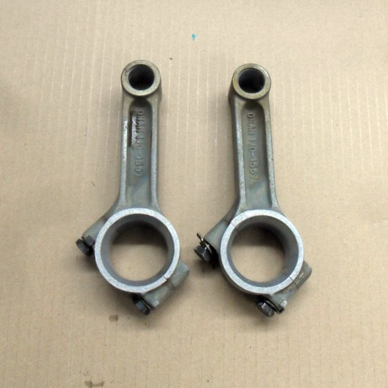

I had wanted to avoid the newer Onan engines that no longer used replaceable connecting rod bearing shells which were available for the CCK series in many common under size.
If you needed to have the crankshaft ground on the later engines,  you had no alternative but to purchase expensive undersized connecting rods made from aluminum.
The picture at the bottom are a pair of CCK rods made from forged steel..
Secondly Onan went with aluminum engine blocks, the older CCK series is all cast iron and you may have noticed all of the older Kohler engines are also made from cast
Secondly Onan went with aluminum engine blocks, the older CCK series is all cast iron and you may have noticed all of the older Kohler engines are also made from cast iron.
Those pics are all aluminum rods, early and later...I think you were looking for these 114-0203 forged steel con rods..they were also used on the later 24HP big block Onan engines too. :)
I'll post pictures of a couple of connecting rods tomorrow from a CCK series engine I'm parting out.

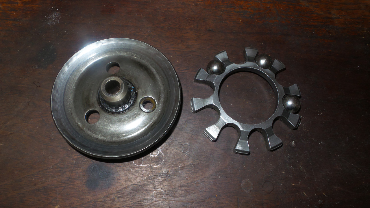

The Onan on my Alis Chalmers 720 is over revving and we all know what that means, I have my work cut out for me.
lynnmor
You have two balls missing?
The "work" is finding a suitable replacement.  Is that a groove in the cup where the balls ride?  My dad frequently ran his Onan very slow and that is what I believe knackered the cup in his engine, my theory is that there was not enough centrifugal force to keep the balls firmly against the cup.  I modified things to prevent the slow running much to his objection.
