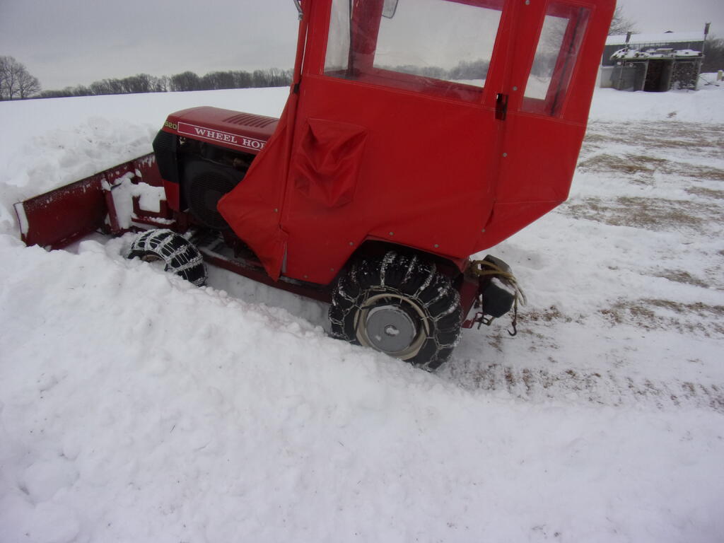

DennisThornton 4,771 #5 Posted February 19, 2021 I try to get my gravel drive (ones and dust) as flat as I can before freezing weather and try to keep it that way. I've always needed to go back over with a blade and I found that I use the blower less and less because I have to use the blade anyway and it doesn't cover me in snow. Unless the snow is over 6" or so I do not use the blower any more. And sometimes even over 6" I still blade with the little Wheel Horse and push the banks back with my compact FEL. The more uneven the drive AND the wider the blade or blower the more snow will be left. Bigger is often better but not always the best. Gravel vs blowers is a compromise. 1 1 Share this post Link to post Share on other sites

DennisThornton 4,771 #8 Posted February 19, 2021 37 minutes ago, Ed Kennell said: I used several different blowers for 20 years and now have gone back to plowing only with no regrets so far. You know, I was going to type that as well, since it's been probably 3 years since I've blown. But I didn't want to completely poopoo blowing since I do intend to either this season or next put at least another blower back together. I've finally got enough GTs to dedicate one for every task without changing anything. I just added rear weights to my chains and filled tires and it was a noticeable improvement. Then the front roller chains really impressed me (more when I can keep them on!)! But I've not had good luck with heavier than 6" and then needed help from the compact for the sides piled up. I'm sure I can handle deeper now but I'm guessing maybe 9". You must get some serious snow out your way, how much will your rig handle? I do much prefer to plow than blow! 1 Share this post Link to post Share on other sites

DennisThornton 4,771 #13 Posted February 19, 2021 3 minutes ago, cod said: Thanks for the responses the "washer experiments" will begin tomorrow. I like the idea of a plow as well and if I had more room to push onto, I'd be on it. Then again a second 418 would keep the first one company. "Honey look what I found just for you..." I have trees on each side of a lot of the drive and indeed the blower works great there. But I've found that I can come back and push straight ahead between the trees. There's a limit, but so far doable. If those trees were fence then I'd use the blower more, but still plow the small snowfalls. And yes! The you and the Honey would make a great team plowing and blowing, great pictures and great videos! Upload when you get them! Share this post Link to post Share on other sites
