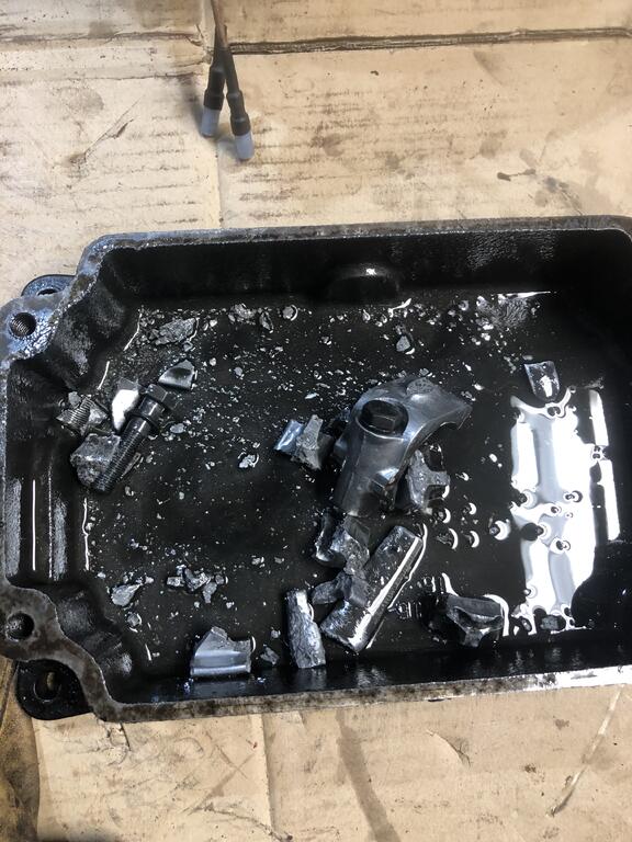

The Tuul Crib 7,340 #51 Posted March 9, 2021 That very same thing happened to me on a K3 41. It was running very well then all of a sudden everything went silent and the fly wheel kept spinning! Not the greatest feeling in the world. The connecting rod was the weak point and didn't hurt anything internally it just exploded in thousands of pieces! Share this post Link to post Share on other sites
