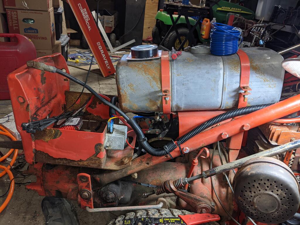

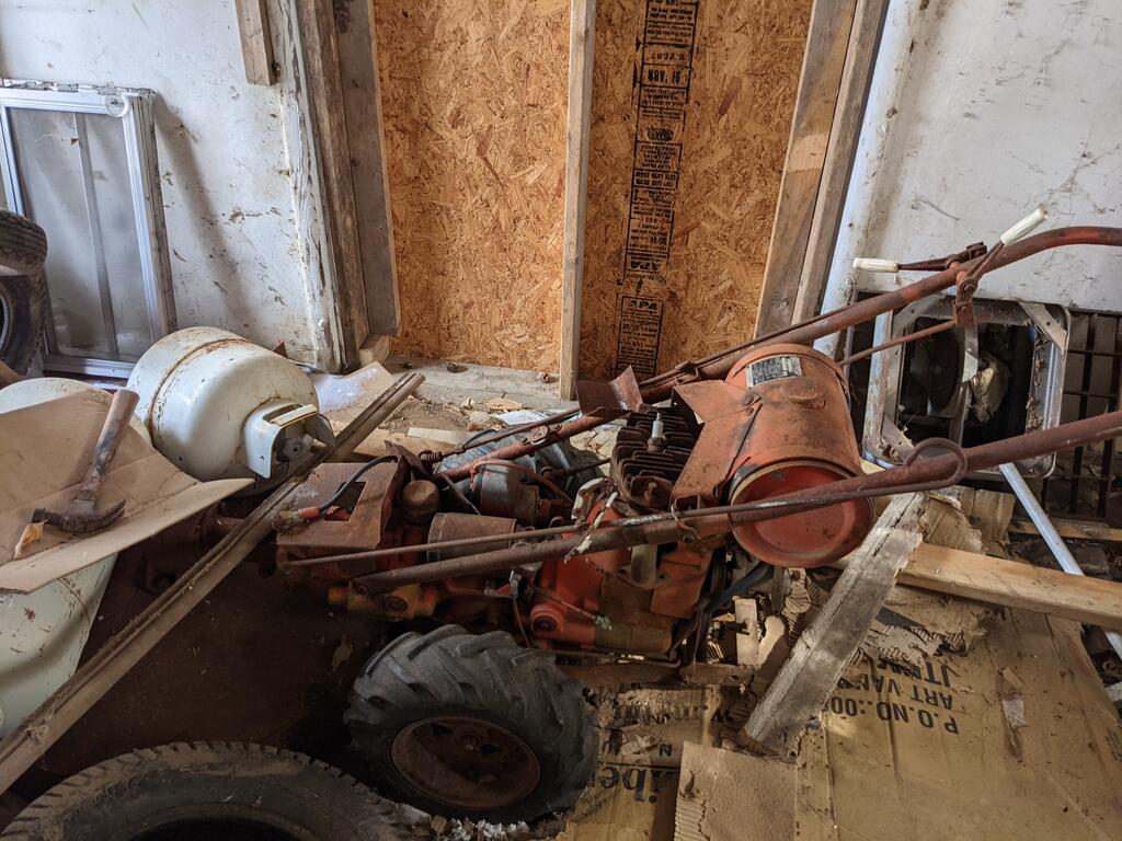

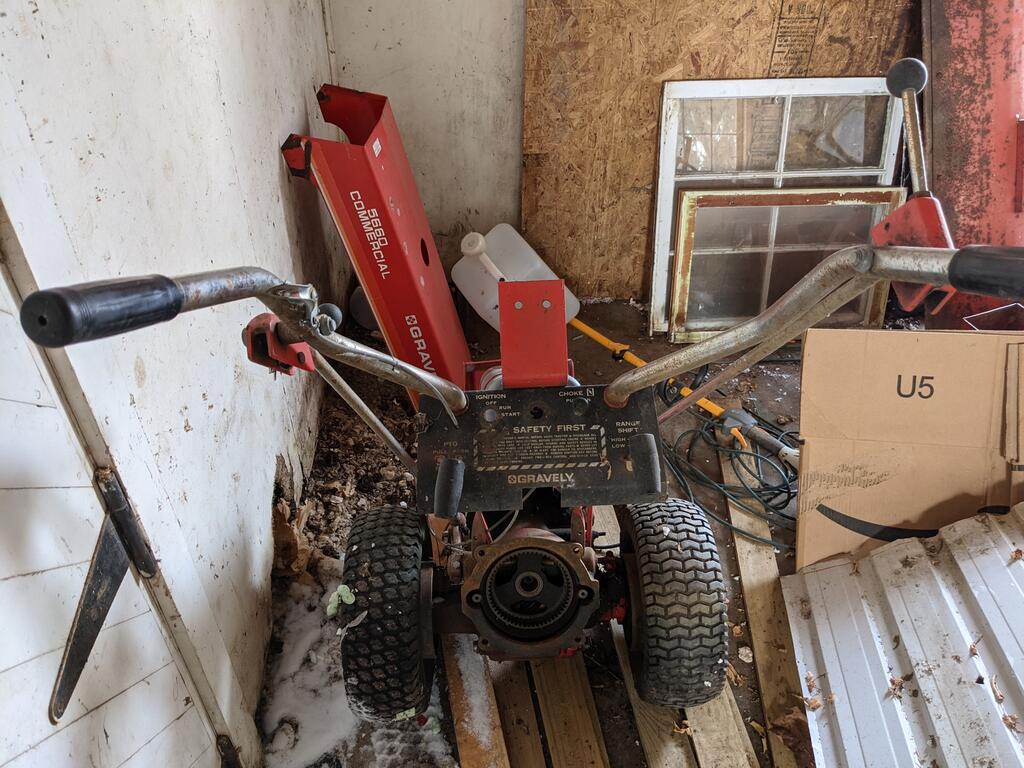

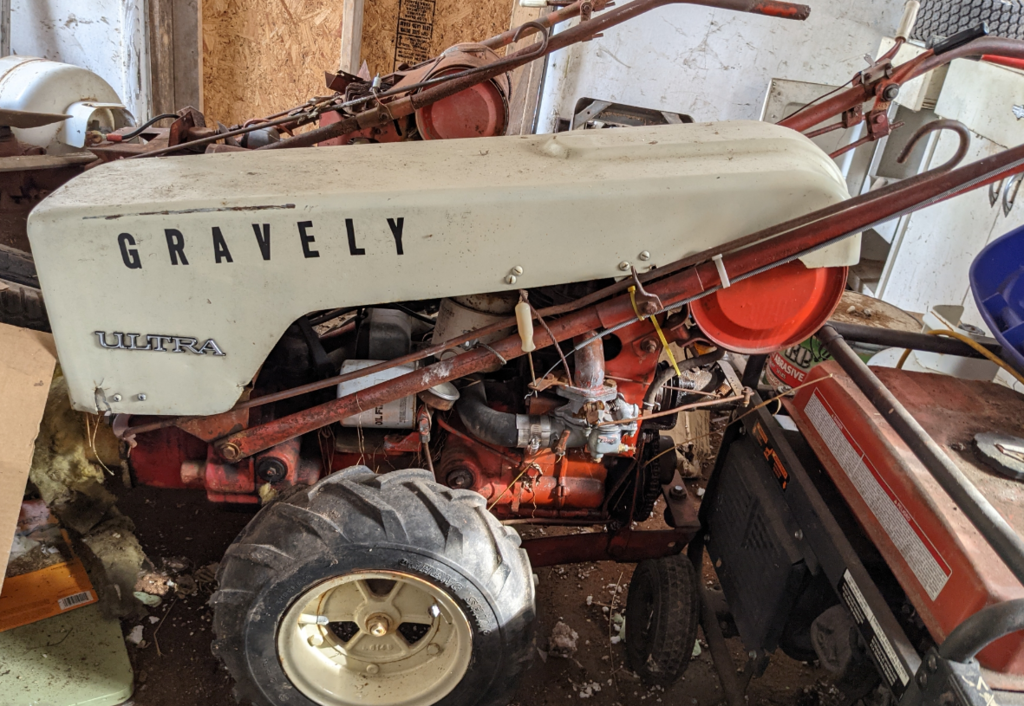

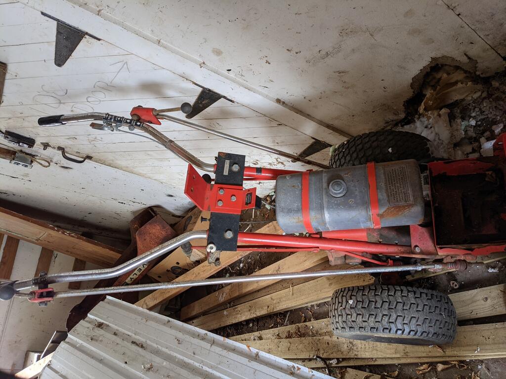

seuadr 490 #26 Posted February 21, 2021 (edited) Here is the machine in question: also discovered i am a fraud! it is a 5660! (not totally sure what the difference is) that bracket between the bars is for the steering brakes. here are a couple shots of it's older brother and it's older brother's parts donor: Edited February 21, 2021 by seuadr Share this post Link to post Share on other sites

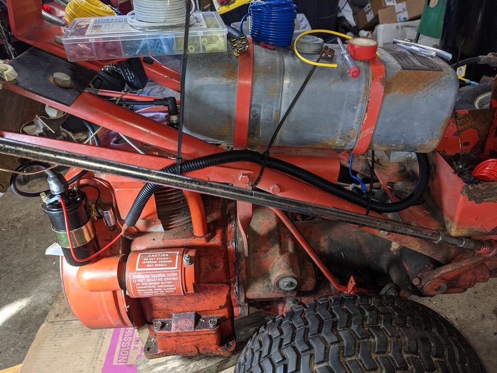

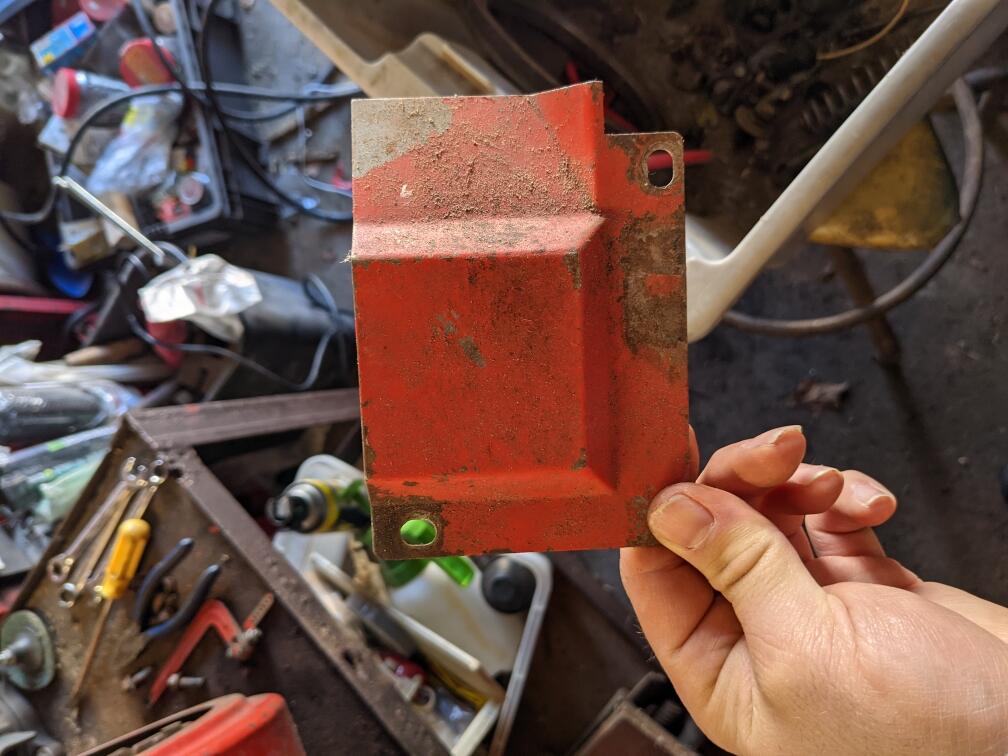

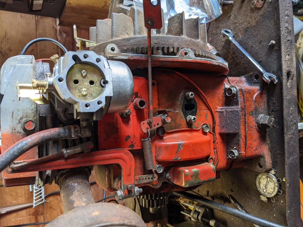

seuadr 490 #35 Posted February 23, 2021 ok! so i was wrong - i DO have that spring. the PO had it connected to something else entirely, but then again, the PO also drilled a hole in the governor linkage and wrapped wire around the handle instead of just switching the throttle linkage around so... this feels right - it moves nice and easy and it connected up easily. i might have the throttle bracket that attaches to the shourd upside down, not sure. now i got it almost buttoned up - just missing the fuel pump and lines as far as i can tell. did have a question - in the parts diagrams i've seen, this cover doesn't have this open spot: any idea what that is for? seems to go through to the inside of the motor so i'm thinking vacuum but the fuel pump is mechanical so i'm not sure what for? I don't have the air cleaner hooked up yet - perhaps it has something to do with the remote air cleaner.. i also have this cover for... something? next thing i'm working on - cleaning and lubing these guys: and of course, i gotta figure out how exactly they are supposed to go.. but that is going to mean digging out the machine so i can work on both parts at once. Still, making good progress i think! Share this post Link to post Share on other sites

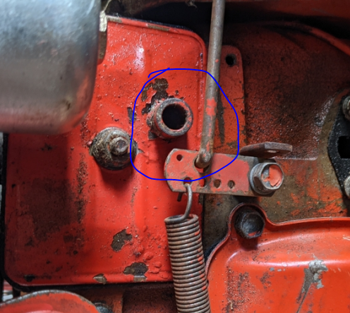

squonk 48,010 #36 Posted February 23, 2021 (edited) That plate is supposed to cover the fins between the coil and dipstick I think that hole is supposed to have a tube that runs to the air cleaner for crankcase vent. You can see the remains of the tube in this pic. Edited February 23, 2021 by squonk 1 Share this post Link to post Share on other sites
seuadr 490 #37 Posted February 23, 2021 7 minutes ago, squonk said: That plate is supposed to cover the fins between the coil and dipstick I think that hole is supposed to have a tune that runs to the air cleaner for crankcase vent ? Gotcha! since i have the remote air cleaner instead of the local one, it is probably one of the longer pieces of dry rotted tube i had. i can probably locate that and hook it up once i have the remote cleaner .. elbow.. connector.. thing.. attached. thanks! 1 Share this post Link to post Share on other sites
squonk 48,010 #38 Posted February 23, 2021 Just now, seuadr said: Gotcha! since i have the remote air cleaner instead of the local one, it is probably one of the longer pieces of dry rotted tube i had. i can probably locate that and hook it up once i have the remote cleaner .. elbow.. connector.. thing.. attached. thanks! Look at my edited post 1 Share this post Link to post Share on other sites
seuadr 490 #39 Posted February 23, 2021 hey - i just noticed that you have your flywheel.. grill? on under the shroud - mine rubbed against the shroud when under, so i put it over the shroud - does yours rub at all? Share this post Link to post Share on other sites
squonk 48,010 #40 Posted February 23, 2021 5 minutes ago, seuadr said: hey - i just noticed that you have your flywheel.. grill? on under the shroud - mine rubbed against the shroud when under, so i put it over the shroud - does yours rub at all? I lifted that pic from Tuul Crib's post it isn't mine, but I think on the small blocks the screen is on the inside. Yours should be on the outside. Share this post Link to post Share on other sites

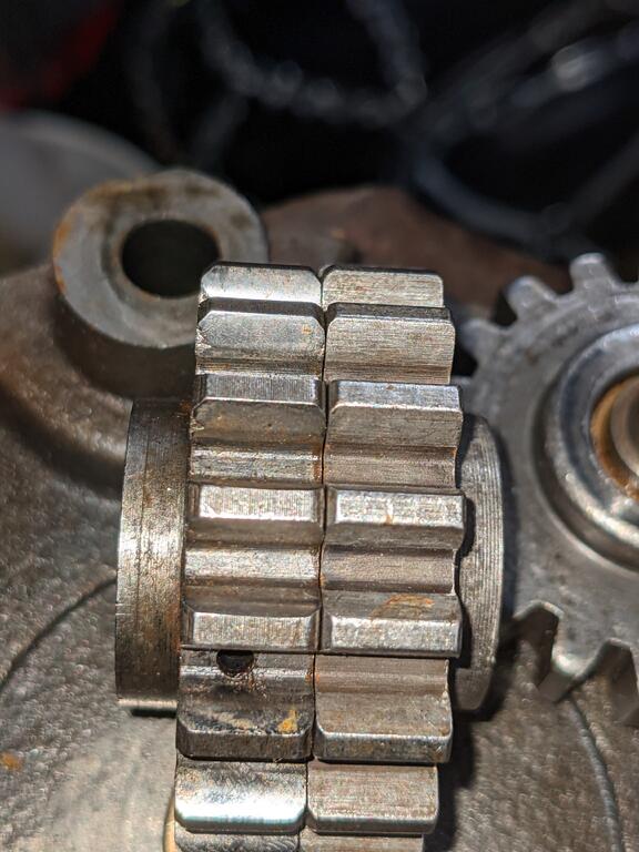

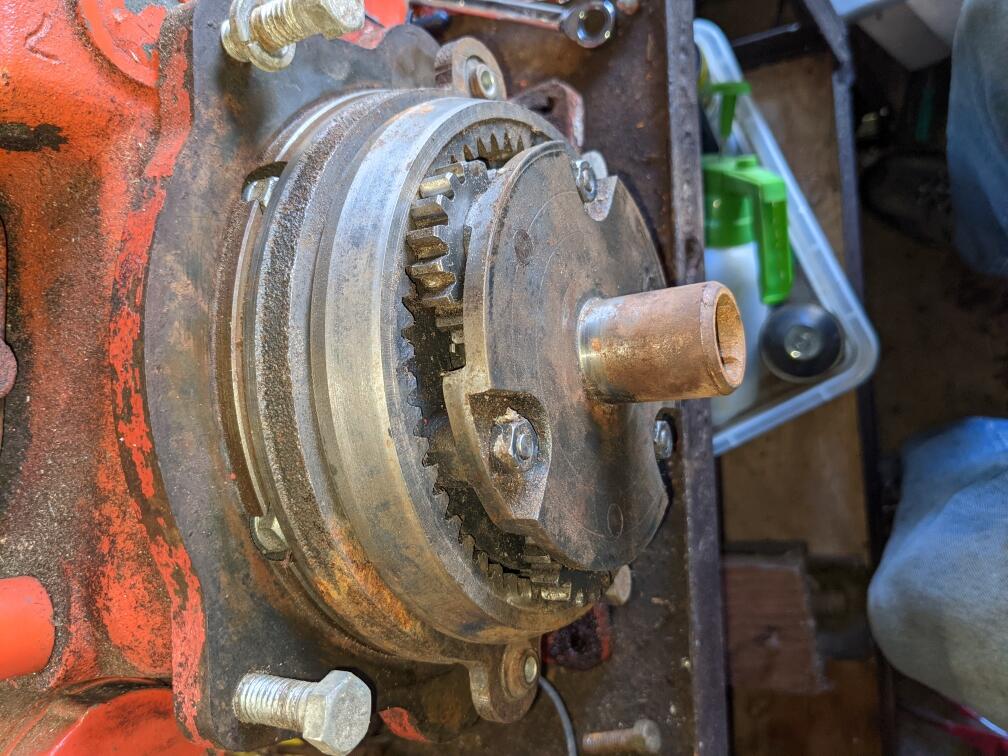

seuadr 490 #41 Posted February 23, 2021 Are these bushings shot? PXL_20210223_204127479~2.mp4 Share this post Link to post Share on other sites

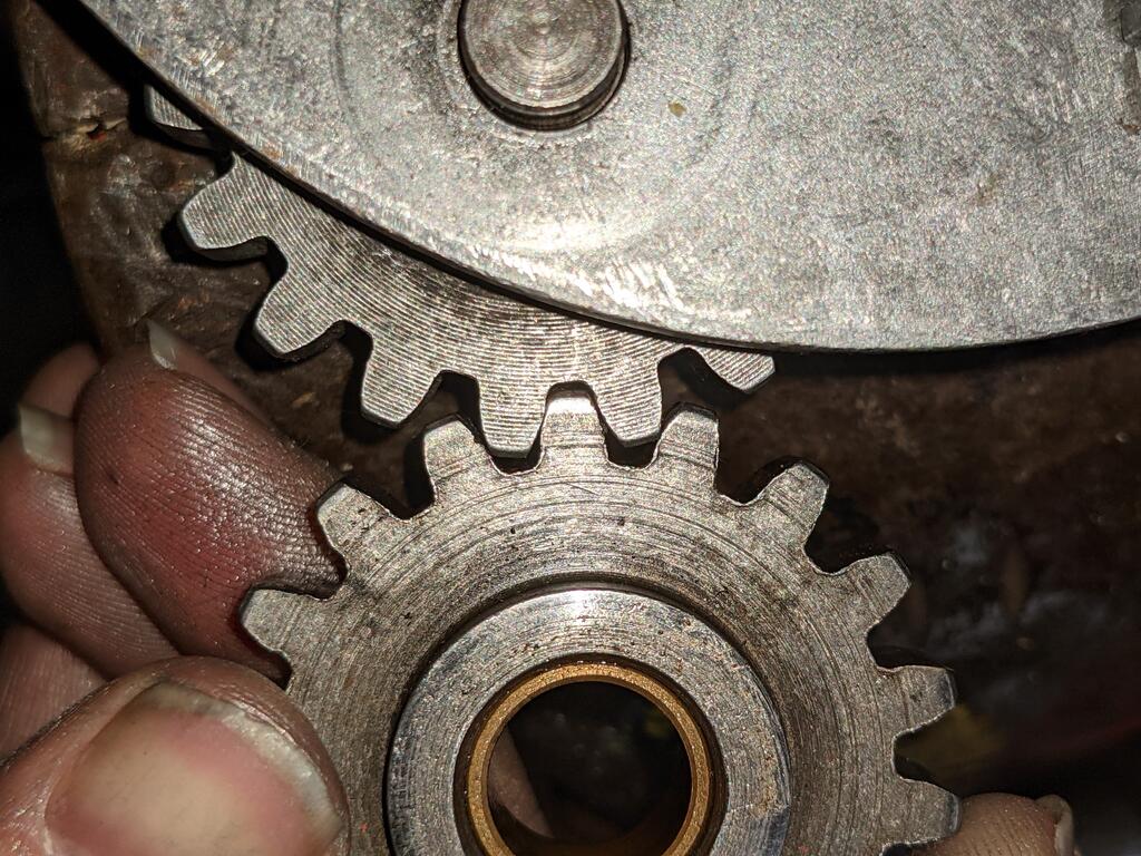

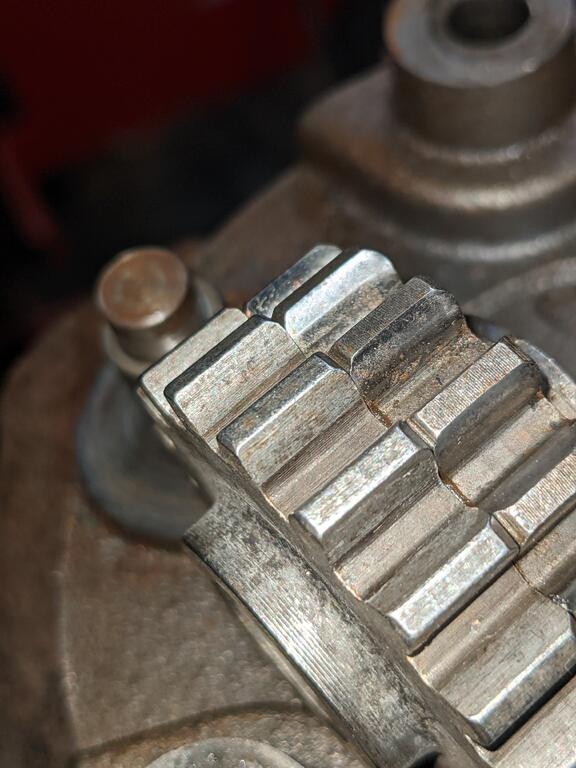

squonk 48,010 #42 Posted February 24, 2021 I see a lot a wear on the gears. Take it apart. Check for rocking on the orbit gears. 1 Share this post Link to post Share on other sites
seuadr 490 #43 Posted February 24, 2021 is that the play you are talking about? looks like i can replace the bushings - will that help or do i need to replace the gears? Share this post Link to post Share on other sites

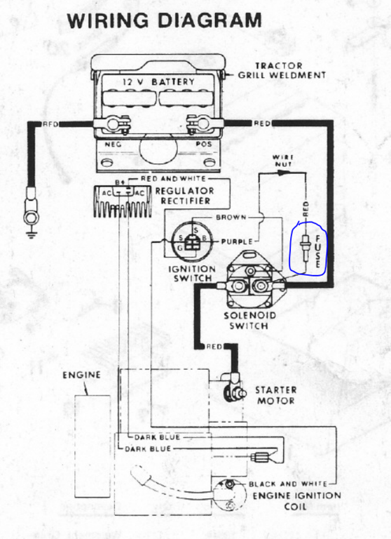

seuadr 490 #44 Posted February 24, 2021 so on to the wiring harness for now - mine is essentially non existent, so - now i'm tracking down the wires i need. this is what my harness would look like IF I HAD ONE: i have 2 wires (that of course, don't match the colors in the wiring schematic - and also aren't nearly long enough to get to the place they are supposed to go ) and i know i can make the wires that go to the ignition. Heck, i think i even have some inline fuse holders laying around (though, they'd be blade type, not glass) but i'm not sure what amperage it is supposed to be. according to the schematic it goes from the solenoid to the ignition switch, so i wouldn't expect it should see a ton of amperage, so i'm thinking like a 10? i am assuming the purpose is to provide 12v to the relay inside the solenoid that goes through to the black/white wire to the starter? am i reading that wrong? Share this post Link to post Share on other sites
squonk 48,010 #45 Posted February 25, 2021 (edited) Yes those bushings are replaceable but I see a lot of gear wear. Looks like 10 amps would be fine for a fuse. If it has one of those plastic fuse holders for a glass fuse throw it away and install a blade style fuse holder with a weatherproof cap. Edited February 25, 2021 by squonk Share this post Link to post Share on other sites
seuadr 490 #46 Posted February 25, 2021 24 minutes ago, squonk said: Yes those bushings are replaceable but I see a lot of gear wear. Looks like 10 amps would be fine for a fuse. If it has one of those plastic fuse holders for a glass fuse throw it away and install a blade style fuse holder with a weatherproof cap. hmm. looks like i can pick up new gears for around 80 bucks a pop. doesn't look like the idler gears are available new (at least from the place i've checked) but i'm guessing that they are less critical? i was hoping to pick some up used, but the ones i see on ebay look to be as worn, if not more so, than mine! (which i suppose shouldn't be all that surprising) Share this post Link to post Share on other sites
seuadr 490 #47 Posted March 1, 2021 so i bit the bullet and ordered new replacements. 70 bucks a pop, but i noticed today that the machine's hour meter read almost 1000 hours, so, i guess that is pretty cheap per hour I also got the fuel pump installed, and fit the motor to the machine so that i can start building my own wiring harness, since it appears i don't have any of that. I figure that i'll need to make it approximately the right length and that will be a lot easier with it in place. actually not bad at all to get lined up and in place, the motor happens to sit the same height as a furniture dolly i use for moving heavy things around the shop so i just rolled it up and bolted it on! Also discovered that i need a new pan gasket, when i tipped the motor when setting it down on the dolly it leaked out of the front pretty bad. on the bright side, i was going to drop the pan and check the timing anyhow so.. Share this post Link to post Share on other sites
seuadr 490 #48 Posted March 6, 2021 Orbit gears replaced and new wiring harness made! The new pkug for the ignition had completely different colors than the wiring schematic, but i didn't any wires to begin with so i matched the new colors. Of course after i hooked everything up - it looks like the starter solenoid is bad. 😭 Of course in fairness for all i know it is the original so, probably fair. Share this post Link to post Share on other sites

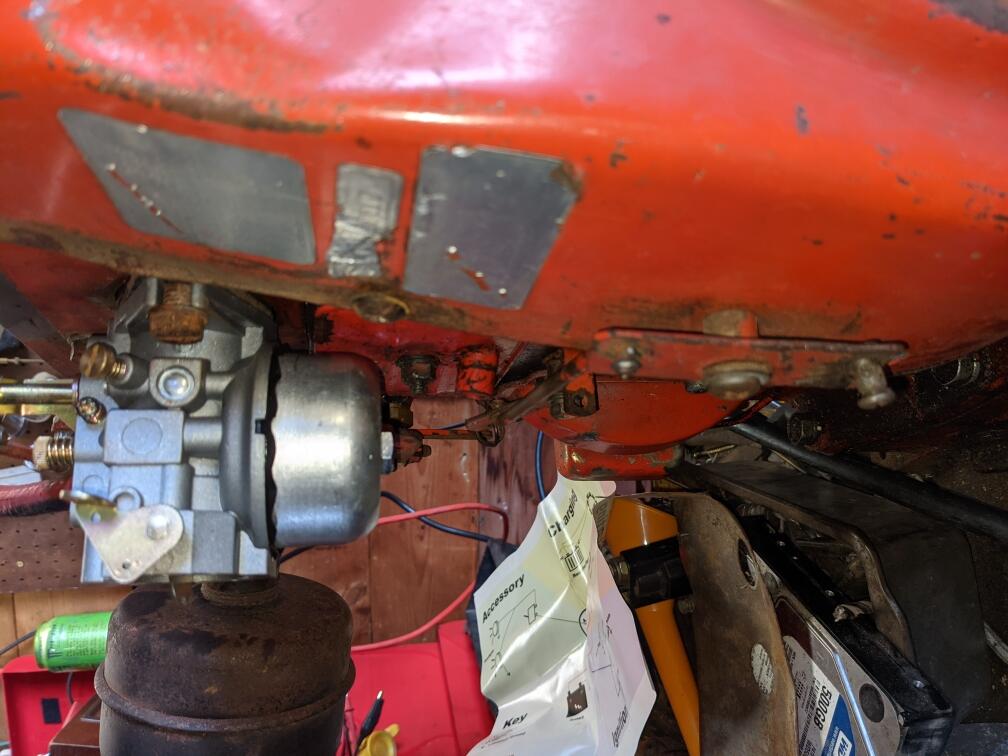

seuadr 490 #49 Posted March 7, 2021 She lives! Carb needs some major adjustment as it is pretty lopey and I'm not sure the governor is quite right, but she runs, she drives. I didn't hook up any attachments or check the pto at all because currently neutral is pretty much just a theory and I'd hate to get run over by my own tractor. Share this post Link to post Share on other sites
seuadr 490 #50 Posted March 9, 2021 Well, they say a picture is worth a thousand words so: I was working on adjustment of the carb when the motor just started turning free. I don't know if it was not put together correctly or what, but i was adjusting the liw end of the throttle cable so i wouldn't expect that it overreved or anything. As far as i can tell, there was oil circulation. The cylinder walls aren't scored and the valves still move. The piston was stuck at bottom. Seemed to be oil around the rings abd i put oil in the top of the cylinder and rotated it by hsnd a hslf dozen times before ever putting it back together, but perhaps that was not sufficient. I have some before pics from the other day: has about 15 mins of run time since i put it on - but the rebuild was ~20-30 years ago according to the guy i bought it from. i dunno if there was an issue with assembly or what, but, there does not appear to be any damage to the cylinder or crank, and the piston came right out with just me pushing with my fingers so it was not seized. Share this post Link to post Share on other sites
