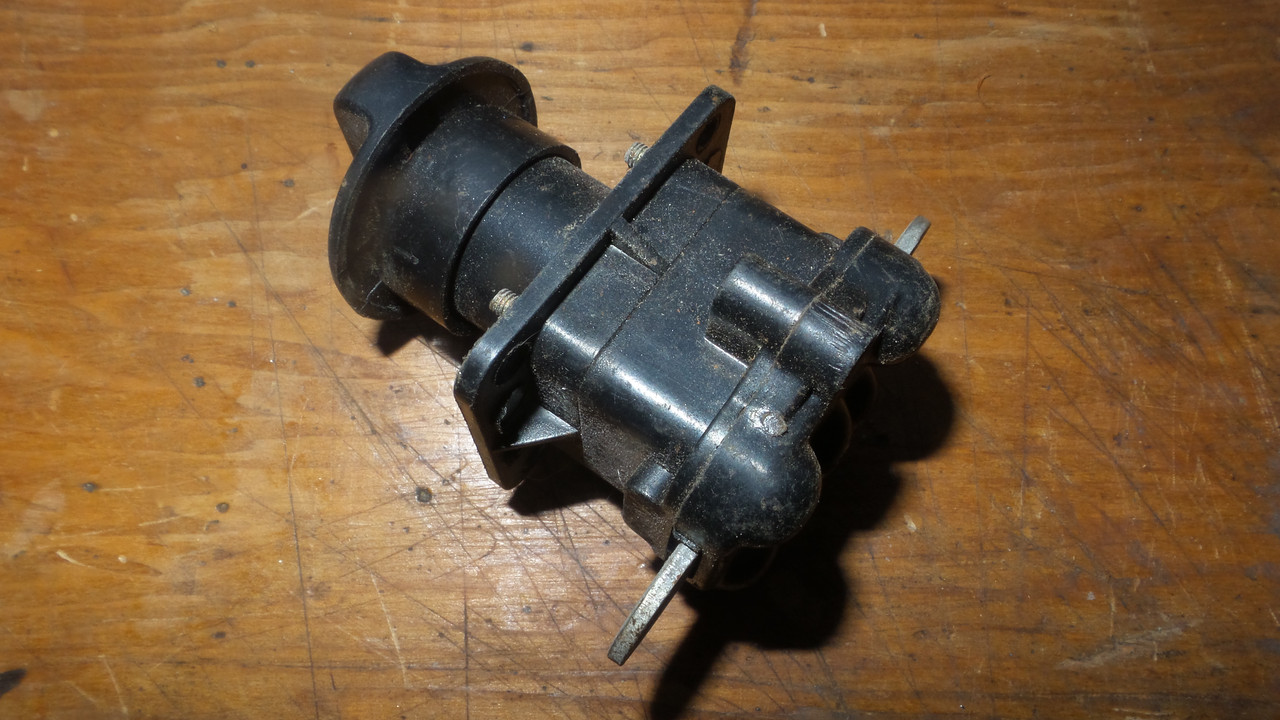

bc.gold 3,406 #9 Posted February 18, 2021 (edited) This switch came off of an emergency jump start pack, I'm going to install this on my Jone Deere LA 175 which has a parasitic drain that kills the battery. Night Switch. Edited February 18, 2021 by bcgold Share this post Link to post Share on other sites
