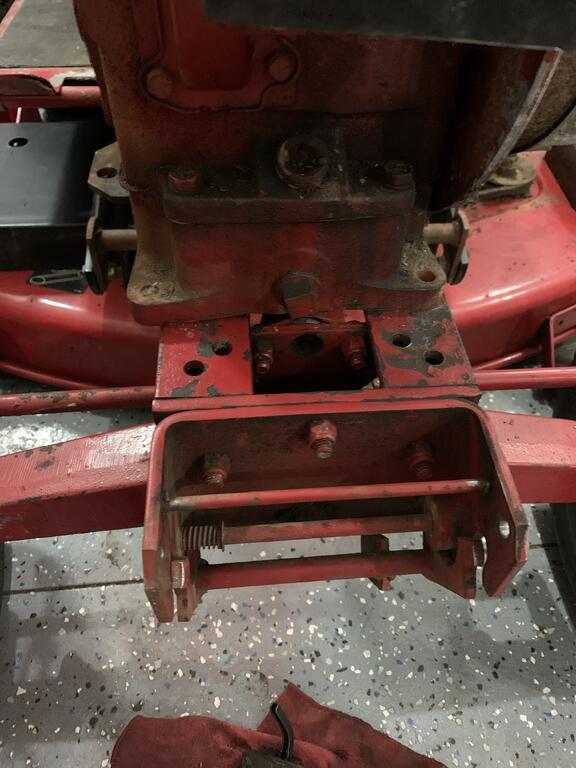

Raposo 532 #1 Posted February 15, 2021 Hey guys, I picked up a 416-H without a motor. I had a magnum 16 I wanted to put in it. The issue is the oil pan on the engine only has 4 bolt holes and it doesn’t have the threaded holes on the right side of the engine. My question is, will a magnum 14 or magnum 12 oil pan from a wheel horse engine bolt up to the engine? If not I plan on welding in tabs onto the side of the frame to bolt the right side of the engine (the part that over hangs the frame) Share this post Link to post Share on other sites
gwest_ca-(File Mod) 11,921 #2 Posted February 15, 2021 Could you not use a "J" bolt hooked onto the frame? Garry 3 Share this post Link to post Share on other sites
cschannuth 3,819 #3 Posted February 15, 2021 Like Garry said, I believe J hooks were used in some big block applications. Share this post Link to post Share on other sites
JAinVA 4,638 #4 Posted February 16, 2021 That style pan with the correct bolt pattern can be sourced from the m10 through m16 or k series 10 to 16 horse. 1 Share this post Link to post Share on other sites
Raposo 532 #5 Posted February 16, 2021 Hey guys, I never thought of j bolts. Anyone have a link or photo? The j bolts I’m thinking of seem to have a big radius to them? Is this what you guys are referring to? Or is it more of a v style? 091E91BA-1F0E-488D-8553-26A9074A8295.webp 1 Share this post Link to post Share on other sites
