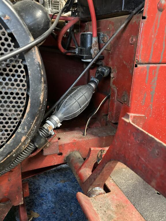

SylvanLakeWH 29,888 #7 Posted February 10, 2021 I just replaced the fuel line and in line filter on my C 105. No need to drain tank - just turn off petcock. I also installed an in line bubble to prime the fuel line for easier startups... man what a difference! Wheelhorsepartsandmore has the grommet and petcock. Vendor on this site. Good folks! 2 Share this post Link to post Share on other sites
Jeff-C175 7,207 #8 Posted February 10, 2021 12 minutes ago, SylvanLakeWH said: installed an in line bubble to prime the fuel line for easier startups... man what a difference! Me too, and you sure got that right! I was going to go the electric pump route but figured I would try this first and glad I did. 1 Share this post Link to post Share on other sites
HittinSteel 12 #9 Posted February 10, 2021 28 minutes ago, SylvanLakeWH said: I just replaced the fuel line and in line filter on my C 105. No need to drain tank - just turn off petcock. I also installed an in line bubble to prime the fuel line for easier startups... man what a difference! Wheelhorsepartsandmore has the grommet and petcock. Vendor on this site. Good folks! I think I will try that before spending the money to replace the pump! 1 Share this post Link to post Share on other sites
stevasaurus 23,517 #10 Posted February 10, 2021 If you are not familiar with those bulbs, notice they have an arrow on them for direction of gas flow. 2 1 Share this post Link to post Share on other sites
