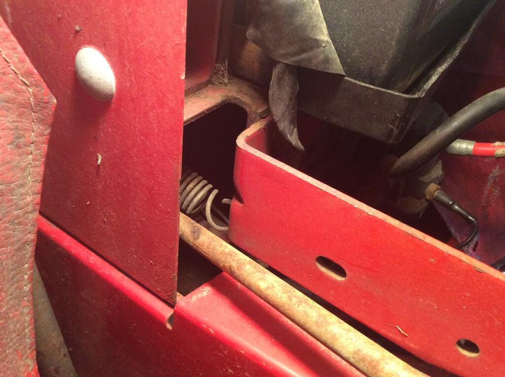

Anyone have a picture of where the 103125 spring on the pto rod connects to the hoodstand of a c125 or c145? Thanks

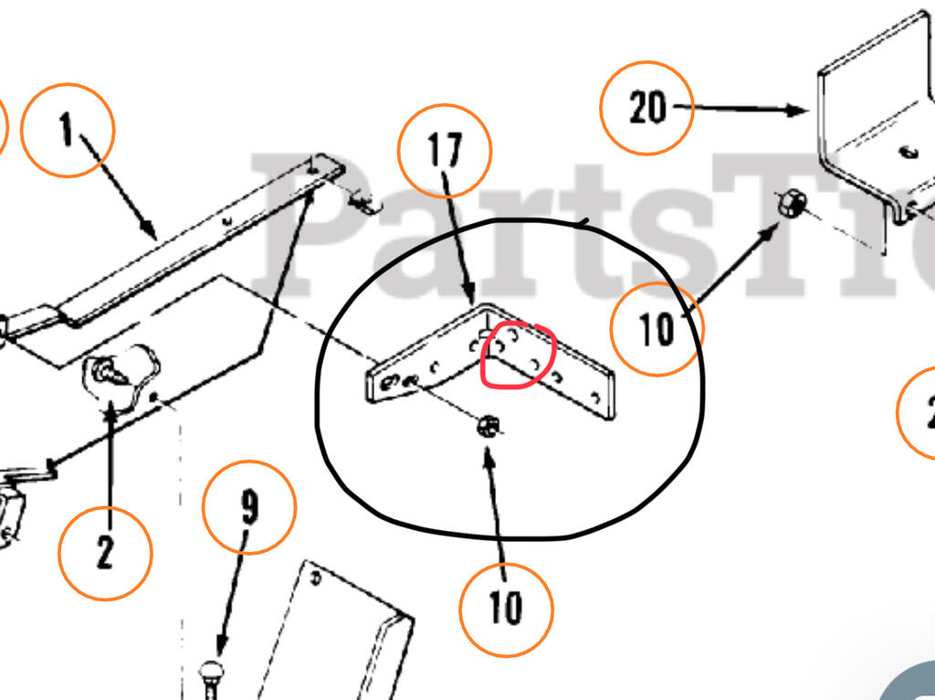

@mark in ny on my C-145 the pto spring is connected to a bracket under the battery, which also serves as the brace for the right side belt cover top bolt. I have circled in black the bracket and in red where the spring is attached. The picture of the parts list is from partstree. The 2nd is a picture of my machine. Hope this helps.315D747A-721D-4E4B-93FE-FDBEC189BCED.jpeg.f5f23c401ea1a76d0744d72b0a1e6b2e.jpegA7B929C9-4C59-48E5-AB73-592848E24B7F.jpeg.213454b5bafeca6d7d2b190b2880f795.jpeg

Tuneup
Ditto on my 125...

mark in ny
Thanks guys I really appreciate it. All the exploded views never show it.
