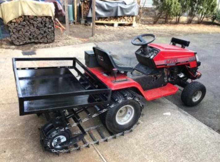

3148ISGREAT 5 #203 Posted February 13, 2021 I found this while on break at work, the removable ski's are rough but the idea could probably be refined. 3 Share this post Link to post Share on other sites
Oldskool 6,678 #204 Posted February 13, 2021 Just now, ebinmaine said: We've got plenty of red oak here. Perfect Share this post Link to post Share on other sites
ebinmaine 80,485 #206 Posted February 13, 2021 Yepp. There we go. I'd have the two wheels much closer. Mostly so I could use a hitch. More cross tracks too. But the basic idea is that. 2 Share this post Link to post Share on other sites
DennisThornton 4,773 #207 Posted February 13, 2021 I picture same size rears closer together and no idlers or bogies. 2" receiver of course. AND! I just thought this morning that it might be worth having the add ons be independently suspended. Trailer hubs on separate arms each with an air shock. Deep snow or mud, more air to push the rears down so the front drive wheels climb less. Independent for better ground contact and traction. Wouldn't have to be the same tire/wheel size but why not if there's room. 1 Share this post Link to post Share on other sites
Oldskool 6,678 #208 Posted February 13, 2021 I would like to see a video of that style track used in snow. Without it being plowed. I have to wonder if the same amount of weight was added with a really good set of chains which would really be more effective. Share this post Link to post Share on other sites

Oldskool 6,678 #210 Posted February 13, 2021 16 minutes ago, ebinmaine said: https://www.farmshow.com/a_article.php?aid=35404 I love that magazine. I used to get it quite a bit. I like his track better then others. The idler is alot closer to the drive wheel so more ground contact in one area. The cross bars are closer together. The only thing I have to wonder is tire slippage IN the tracks Share this post Link to post Share on other sites
Oldskool 6,678 #211 Posted February 13, 2021 I may be inclined to add more crossbars though Share this post Link to post Share on other sites
DennisThornton 4,773 #212 Posted February 13, 2021 24 minutes ago, Oldskool said: I would like to see a video of that style track used in snow. Without it being plowed. I have to wonder if the same amount of weight was added with a really good set of chains which would really be more effective. Similar to when we briefly chatted about the screws, there's so many variables! Trying to get through the woods in heavy snow gets a lot more doable with snow shoes, but not because they offer better traction. Multiple wide tires can help but again, because of better traction? Sometimes, maybe sometimes not. I think with the added rear tires we're adding surface area and some traction. How to test? I just added more cross links to my 4-links on my Bolens and I'm pretty sure it pushes better, but how much better? When Norman on ISaveTractors says that he didn't think his first attempt added much performance one has to wonder if it was worth it. I'm in no hurry to get this build going, not until most questions are answered as best as we can. I'd love to see it make a difference AND be something the average handy GT owner could do. Share this post Link to post Share on other sites
ebinmaine 80,485 #213 Posted February 13, 2021 12 minutes ago, Oldskool said: I like his track better then others. The idler is alot closer to the drive wheel so more ground contact in one area. The cross bars are closer together. The only thing I have to wonder is tire slippage IN the tracks Yepp me too. 10 minutes ago, Oldskool said: I may be inclined to add more crossbars though Also me too. I feel like every other link......? OR. A cross bar with a deeper bite. .....? 12 minutes ago, DennisThornton said: When Norman on ISaveTractors says that he didn't think his first attempt added much performance one has to wonder if it was worth it I caught that comment as well but how much rough surface testing?? I only saw portions of each video. Always on flat ground where a chained weighted tire would be adequate so a track system would be of little benefit. Share this post Link to post Share on other sites
DennisThornton 4,773 #214 Posted February 13, 2021 13 minutes ago, ebinmaine said: Yepp me too. Also me too. I feel like every other link......? OR. A cross bar with a deeper bite. .....? I caught that comment as well but how much rough surface testing?? I only saw portions of each video. Always on flat ground where a chained weighted tire would be adequate so a track system would be of little benefit. Yep! So many variables. I'd think that it would have to add traction but not turn it into a bulldozer. But then as noted, more links, more weight AND I think being able to load AND adjust the load on the rears could help. Push hard on the addon rears and the drive rears don't have to climb so much in deep snow or mud. Independent linkage on the rears might be a big plus in rough terrain. I've not seen that yet but I can see how to do it and if I keep searching might see how someone else actually did it. With rubber tires the chain/links tracks could be swapped with low traction straps to skidder type links. No limit to what could be done with the tracks. Could be nothing more than treads from used tires, decent aggressive treads from ATVs or whatever. The drive mechanism would be in place to handle whatever one would want for tracks. 1 Share this post Link to post Share on other sites
Oldskool 6,678 #215 Posted February 13, 2021 38 minutes ago, ebinmaine said: Yepp me too. Also me too. I feel like every other link......? OR. A cross bar with a deeper bite. .....? I caught that comment as well but how much rough surface testing?? I only saw portions of each video. Always on flat ground where a chained weighted tire would be adequate so a track system would be of little benefit. Yes I think every other link using that material. I think a 2in channel iron would be fine. I have other thoughts on pad design too. But keep in mind with metal tracks they tend to slide sideways on ice like a skate. Maybe added ice studs? Removable? 1 Share this post Link to post Share on other sites

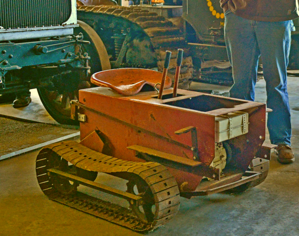

DennisThornton 4,773 #222 Posted February 13, 2021 Much simpler! Not what I'd want to build but I just had to share it: 1 1 Share this post Link to post Share on other sites
