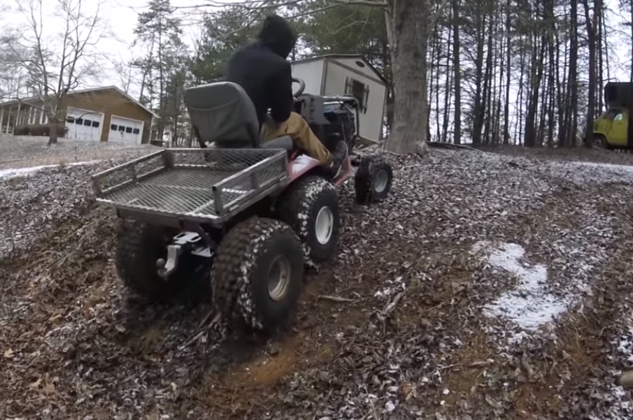

DennisThornton 4,773 #104 Posted February 11, 2021 Simplest I've found so far. Not the most sturdy but I like the idea. Maybe use a 12" rim with cogs and a heavier spring/shock system. 1 Share this post Link to post Share on other sites

DennisThornton 4,773 #113 Posted February 11, 2021 (edited) I'm trying to get a few things done around here and still check in as I can. Just saw this: Worth taking a look. Has several neat ideas and doesn't even have tracks! Yet! Here I've been all about tracks but this has really gotten my attention; And then a follow up in the mud. He eventually got stuck but still quite impressive. Edited February 11, 2021 by DennisThornton added a vid 1 1 Share this post Link to post Share on other sites
