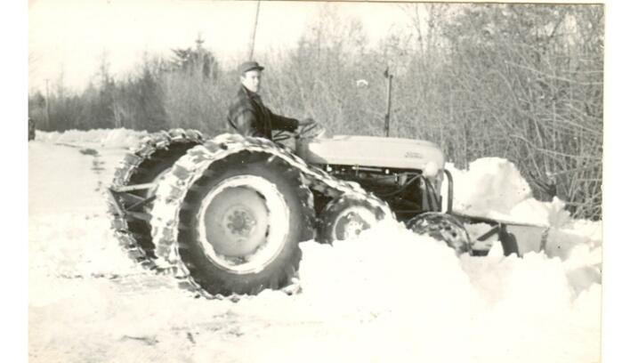

DennisThornton 4,773 #38 Posted February 9, 2021 11 minutes ago, Maxwell-8 said: they converted polaris tracks to work on the lambo, i guess we can make it fit a WH Yeah, the idea has been out there for a long time but I don't think we need to go that far. I have a set of these and I've talked to someone who used them and I think this could be done with our Horses. So far I don't see anything simpler. Maybe not the most traction but not so extreme that it would be unreasonable to do seasonally. Could still add front skis. 1 Share this post Link to post Share on other sites
Oldskool 6,678 #39 Posted February 9, 2021 1 minute ago, DennisThornton said: Yeah, the idea has been out there for a long time but I don't think we need to go that far. I have a set of these and I've talked to someone who used them and I think this could be done with our Horses. So far I don't see anything simpler. Maybe not the most traction but not so extreme that it would be unreasonable to do seasonally. Could still add front skis. There actually is more traction then one would think. My grandfather used them in the woods for years hailing pulp wood. 2 2 Share this post Link to post Share on other sites

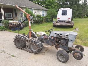

slim67 2,825 #40 Posted February 9, 2021 Don’t forget this one. 1 2 Share this post Link to post Share on other sites

DennisThornton 4,773 #42 Posted February 9, 2021 5 minutes ago, Oldskool said: There actually is more traction then one would think. My grandfather used them in the woods for years hailing pulp wood. When you compare ground contact from the rear tire only to all the rear tracks there is quite an improvement in contact area. My friend said they were impressive until a track came off! I don't know but I guess that happened more when in a grove and then trying to steer out of it OR when they got too loose or making sharp brake assisted turns. There's lot of photos and both ARPS and Bombardier sold them. Must have been a good market for two suppliers. I think we should do it! Let's get a 953-1054, sold the only 953 I ever had, but I want one with limited slip and steering brakes. Or... Share this post Link to post Share on other sites

slim67 2,825 #44 Posted February 9, 2021 I’ve seen this on you tube 1 Share this post Link to post Share on other sites

DennisThornton 4,773 #47 Posted February 10, 2021 15 minutes ago, slim67 said: I’ve seen this on you tube Oh my! Need a link! I have a few of the old Sears too! And a crane! Oh my! 1 Share this post Link to post Share on other sites
slim67 2,825 #48 Posted February 10, 2021 37 minutes ago, DennisThornton said: Oh my! Need a link! I have a few of the old Sears too! And a crane! Oh my! 37 minutes ago, DennisThornton said: Oh my! Need a link! I have a few of the old Sears too! And a crane! Oh my! He pulled a sled with it, also has a clone powered long hood he pulled with. Share this post Link to post Share on other sites
