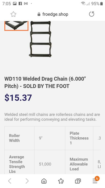

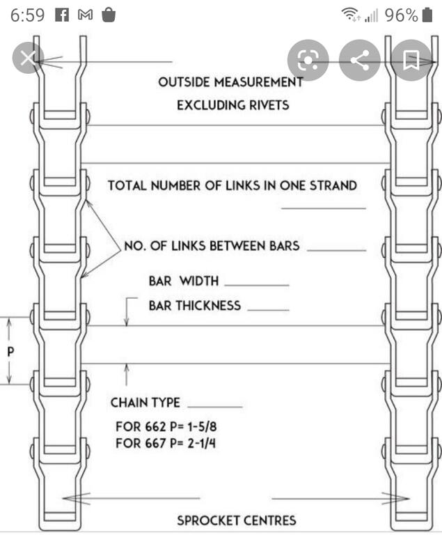

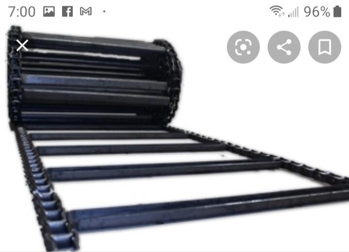

Oldskool 6,678 #231 Posted February 14, 2021 (edited) More food for thought. Edited February 14, 2021 by Oldskool Share this post Link to post Share on other sites
DennisThornton 4,773 #232 Posted February 14, 2021 "Food for thought!"? Way to much to eat already! It's an idea and I'm guessing there are many more options in sizes and strengths to consider. If this project went with sprockets then YES! But I'm thinking sprockets and chains aren't necessary, at all. For now I'm still leaning towards heavy chain and rebar, but I'm still exploring that too. Rebar is reasonably priced, pretty durable, different sizes, bendable, weldable and could be two side by side, three in a triangle or? Could be welded onto flat plate or other bars. Heck, could bend it into rings! V-bars! The ultimate material! I'm leaning away from more floatation from the tread and more towards asking the treads for traction and asking the 4 tires to provide the floatation. Could be wrong! Not saying that floatation is bad but I think it could receive too much attention and isn't of primary importance in most snow and mud. Water, lots of light fluffy and liquid bottomless mud yes, but I'm not sure this project is up to that or needs to be. I now see tires and tracks as a media to carry traction devices, lugs, cleats, chains or... BUT, if more flotation can be had without major cost or compromises then sure! My projects tend to be driven by what I have on hand or what is readily available and/or affordable. But right now I don't have what I'd want for any track design other than some #4 rebar and used tires. If floatation is the goal I think cut off tire treads could be easily and reliably laced together offering almost free treads of any length and more than wide enough. I don't think we are limited to just BIG tires to cut one continuous tread. 1 Share this post Link to post Share on other sites

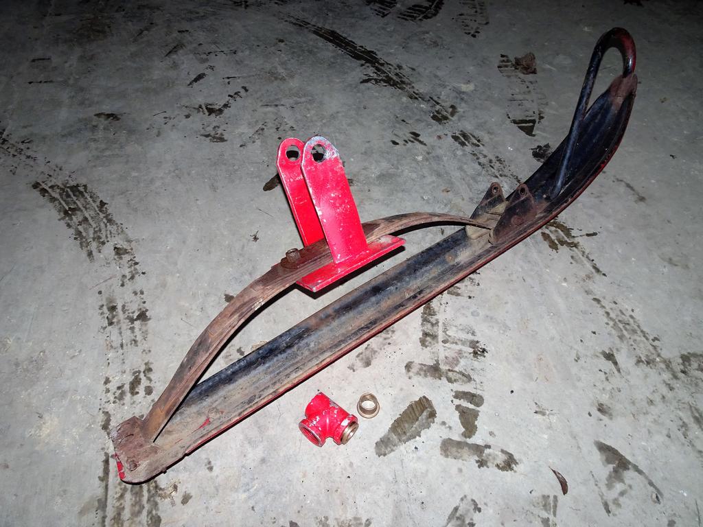

giddyap 1,574 #235 Posted February 15, 2021 On 2/10/2021 at 9:27 AM, DennisThornton said: pull the front wheels and replace with skis. If it steers well then there's hope. 3 Share this post Link to post Share on other sites
ebinmaine 81,056 #236 Posted February 15, 2021 3 minutes ago, giddyap said: I was hoping you'd Post in here. Did you ever get to try that in deeper snow? Curious to know what you think about having something with front skis like that and half tracks for working winter use. Share this post Link to post Share on other sites
giddyap 1,574 #237 Posted February 15, 2021 The front loop continues along the flat bottom of the ski as an edge to dig in. Rigid plate caster yokes item 1-3303 from the Surplus Center catolog $1.49 were used to gain height. Good with half track IMO 1 1 Share this post Link to post Share on other sites
ebinmaine 81,056 #238 Posted February 15, 2021 2 minutes ago, giddyap said: The front loop continues along the flat bottom of the ski as an edge to dig in. Rigid plate caster yokes item 1-3303 from the Surplus Center catolog $1.49 were used to gain height. Good with half track IMO You figure there's a snow depth limit? Share this post Link to post Share on other sites
Oldskool 6,678 #239 Posted February 15, 2021 1 hour ago, ebinmaine said: You figure there's a snow depth limit? Looks like it steers fairly well in that amount of snow 2 Share this post Link to post Share on other sites
ebinmaine 81,056 #240 Posted February 15, 2021 1 minute ago, Oldskool said: Looks like it steers fairly well in that amount of snow Very much agreed. I have absolutely zero experience on a snowmobile of any kind. What I'm wondering is the propensity for the front end of a snowmobile which in turn would be on a tractor to sink into the snow. Best example I can give would be snowshoes for your feet. I have giant snowshoes and Trina has very small ones because we're vastly different in size. So in turn, would the skis need to be a certain length and width in order to be able to navigate snow that is several inches or even two or three feet deep without sinking in? Share this post Link to post Share on other sites
Oldskool 6,678 #241 Posted February 15, 2021 2 minutes ago, ebinmaine said: Very much agreed. I have absolutely zero experience on a snowmobile of any kind. What I'm wondering is the propensity for the front end of a snowmobile which in turn would be on a tractor to sink into the snow. Best example I can give would be snowshoes for your feet. I have giant snowshoes and Trina has very small ones because we're vastly different in size. So in turn, would the skis need to be a certain length and width in order to be able to navigate snow that is several inches or even two or three feet deep without sinking in? As the years went on for the snowmobile alot changed. The older sleds had narrower skis but they weren't very good in DEEP snow neither were there tracks or suspension style.( not alot of clearance). Now with newer, higher suspension. Better tracks, the skies are almost twice as wide. 1 1 Share this post Link to post Share on other sites

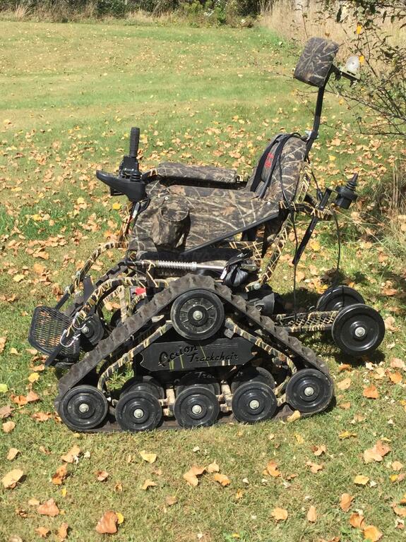

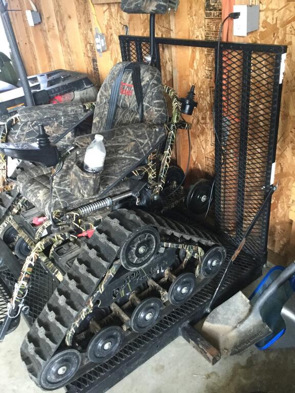

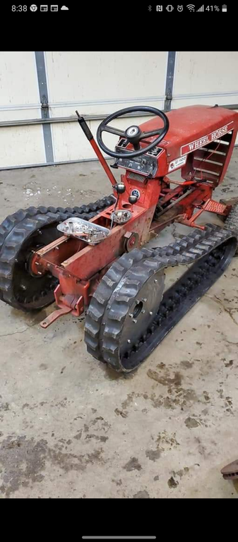

ACman 7,749 #245 Posted February 16, 2021 (edited) Denies this setup on my track chair is a very simple design using snowmobile bogie wheels and tracks from a walk behind loader/trencher . Could be easily converted to driving with a axle . This is driving with a pair of 24v motors and two big gel deep cycle batteries with onboard marine charger . It’s goes about 5mph , has a range of 5-8miles and would climb a tree if it could. Someone does make a blade for it . I really want to do a track setup under my A-81 based on this setup but moving the drive the back . I’ve climbed sand dunes, been in 2’ of water and drove over big logs . It has little ground clearance but it doesn’t seem to matter . Edited February 16, 2021 by ACman 3 Share this post Link to post Share on other sites
Oldskool 6,678 #246 Posted February 16, 2021 7 hours ago, ACman said: Denies this setup on my track chair is a very simple design using snowmobile bogie wheels and tracks from a walk behind loader/trencher . Could be easily converted to driving with a axle . This is driving with a pair of 24v motors and two big gel deep cycle batteries with onboard marine charger . It’s goes about 5mph , has a range of 5-8miles and would climb a tree if it could. Someone does make a blade for it . I really want to do a track setup under my A-81 based on this setup but moving the drive the back . I’ve climbed sand dunes, been in 2’ of water and drove over big logs . It has little ground clearance but it doesn’t seem to matter . That is an AWESOME rig. How long does it take to charge? Is that a track tensioner at the bottom/side of the seat? 1 Share this post Link to post Share on other sites
ACman 7,749 #247 Posted February 16, 2021 4 hours ago, Oldskool said: That is an AWESOME rig. How long does it take to charge? Is that a track tensioner at the bottom/side of the seat? Charging I really don’t know because it’s plugged in whenever possible. I do however will cycle the battery running it down then plugging it in overnight . The tensioner is on the front wheel . That spring just keeps forward pressure on the armrest to keep it from rattling. If you push back on the armrest there’s a quick pin you pull and the whole thing folds down to help with transfers. 1 Share this post Link to post Share on other sites

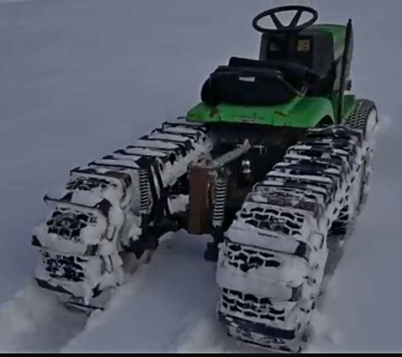

WVHillbilly520H 10,379 #248 Posted February 21, 2021 @DennisThornton I think someone is thinking like you... 1 Share this post Link to post Share on other sites
DennisThornton 4,773 #249 Posted February 21, 2021 42 minutes ago, WVHillbilly520H said: @DennisThornton I think someone is thinking like you... That certainly is one of my favorite designs. I have a set of ARPS for old Fords and Fergs. I'd like to see a design that is more within folks budgets of time and money though with way less alterations, maybe even a quick on and off. But I do like this one! Got more info, pics or links? 1 Share this post Link to post Share on other sites
WVHillbilly520H 10,379 #250 Posted February 21, 2021 7 minutes ago, DennisThornton said: That certainly is one of my favorite designs. I have a set of ARPS for old Fords and Fergs. I'd like to see a design that is more within folks budgets of time and money though with way less alterations, maybe even a quick on and off. But I do like this one! Got more info, pics or links? Fella on FB just starting this. 1 Share this post Link to post Share on other sites
