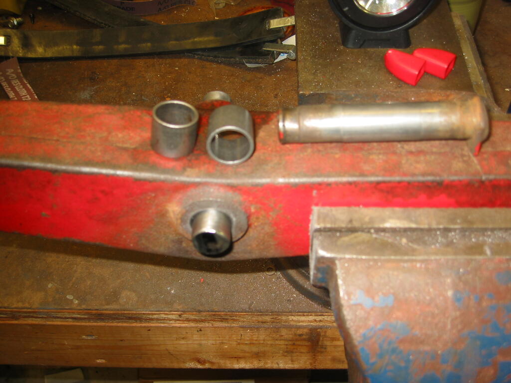

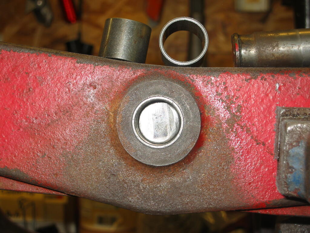

pfrederi 20,079 #4 Posted February 8, 2021 (edited) I can't see your video but this is what I did to one of my Chargers. Made a new pivot pin and drilled out the axles to 7/8" then pressed in two sleeve bearings from Mcmaster. . In my case the front hole in the frame the pin rides in was also wallowed out so I welded a plate over it with a true 3/4' hole and I made my replacement pivot pin a bit longer to fit in it. Edited February 8, 2021 by pfrederi 2 2 Share this post Link to post Share on other sites

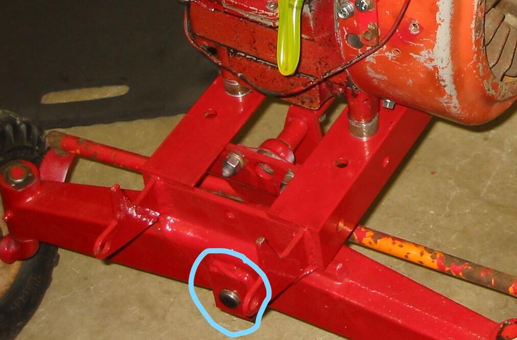

pfrederi 20,079 #6 Posted February 8, 2021 Can't play your video. the back end of the pivot pin has a plate welded to it. Near the top of the plate is a small bolt. Take it out and remove the snap ring from the front of the pivot pin and you can push the pin out to the rear and drop the axle. Share this post Link to post Share on other sites

oliver2-44 11,329 #11 Posted February 13, 2021 To some extent you won’t know till you take it apart. However it’s not to big a job, so to start get a new pin and maybe some washers to take up any slack in front or behind it. 1 Share this post Link to post Share on other sites
tallen4392 71 #12 Posted February 25, 2021 Will that pin and plate in the above pic fit my charger are they pretty much the same for most before I order one I’ll have to look around for some washers with a hole that big Share this post Link to post Share on other sites
pfrederi 20,079 #13 Posted February 25, 2021 WH #6216 was used on virtually all WHs up through at least the 300/400 series. Share this post Link to post Share on other sites
