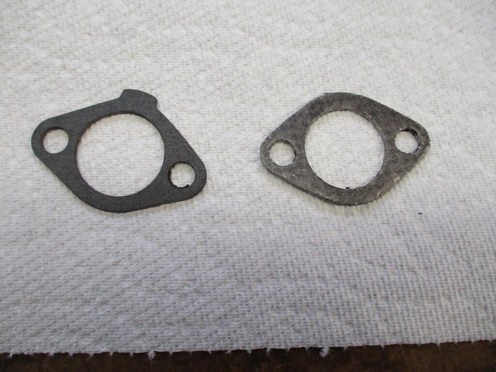

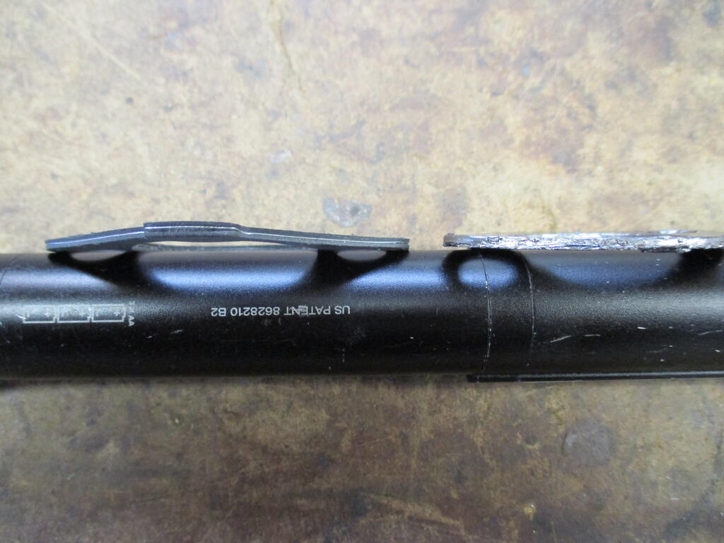

pfrederi 21,051 #26 Posted October 7, 2021 Got to spend some more time working on it. Great fun installing the tins. ( some of which will have to come off again to retorque head bolts). There are 34 screws involved. Only 8 actually go int to block the rest just connect the various pieces. Of course after 34 years the tins are bent and #1 rule get all the bolts started before you start tightening any of them... Also have a problem with the exhaust manifold gaskets in the set I got (after market Kohler set is NLA as are many of the gaskets). Didn't really notice a few months ago when I got them but there are 4 identical gaskets for the intake and exhaust manifold. That just can't be right. They are paper with a very thin layer of metal in the middle. Doubt they would survive the exhaust heat. The exhaust are still available but I hate paying as much in shipping as the gaskets cost. Rummaged around my left over gasket pile and found a couple metallic looking ones that came for a K341 the line up and they are going in. Cheap ones on the left... 2 Share this post Link to post Share on other sites
ebinmaine 80,302 #27 Posted October 7, 2021 2 hours ago, pfrederi said: Rummaged around my left over gasket pile and found a couple metallic looking ones that came for a K341 the line up and they are going in Good choice I believe. I've been given/sold the same for exhaust gaskets too but never put them in. Didn't figure they'd hold up, same as you. Share this post Link to post Share on other sites
