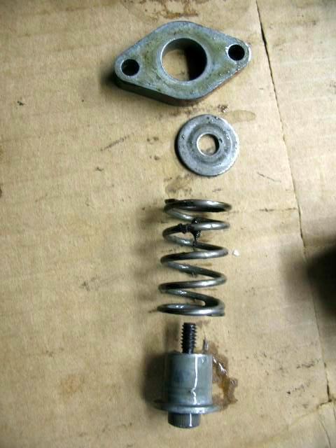

Smittyjws 19 #1 Posted February 4, 2021 (edited) New to the wheelhorse world but have a ? What keeps the lever on the lift valve from lowering when you hit a bump while driving. Seems like there should be some resistance on lever. I am missing the spool cap and spacer would that have any affect on the lever resistance? Edited February 4, 2021 by Smittyjws Share this post Link to post Share on other sites

Jeff-C175 7,207 #3 Posted February 4, 2021 4 hours ago, Smittyjws said: missing the spool cap and spacer would that have any affect on the lever resistance? Yes, there's a spring in the cap. Share this post Link to post Share on other sites
oliver2-44 11,258 #4 Posted February 4, 2021 This service manual shows a breakdown of the valves. if your missing the spacer the spring may not have enough tension on it. Share this post Link to post Share on other sites

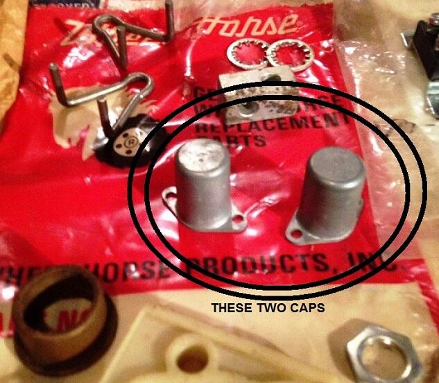

daveoman1966 3,882 #7 Posted February 6, 2021 I can send you the parts in RED outline...AND one of the cap covers. For further details (price) email me at: daveoman@windstream.net Share this post Link to post Share on other sites
