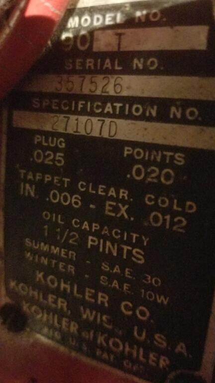

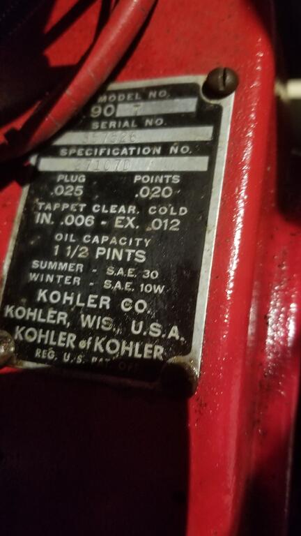

Suzqnii 5 #1 Posted February 1, 2021 I inherited my Dads tractor. It is the tractor i learned how to drive. Beforehe died from mean stupid covid, he had had it restored. Hiwever after using it for a few light storms here in the Berkshires, i noticed black spit coming from the casing where the pull thing is. So, i need to know: How do i fill oil..cant find it Is this spit oil or transmission (3 speed) Can i get an owners manual Its been in my family at least since 1963 the year I was born. I am pretty sure he didnt buy it new. Serial No. 357526 Spec No. 27107D Model No. 90 T Any help is very much appreciated! I love my little red tractor and wish to use it often. 5 Share this post Link to post Share on other sites
gwest_ca-(File Mod) 11,854 #2 Posted February 1, 2021 Welcome to the forum. Sorry for your loss. Found a parts list for the engine but not a spec number listed as being used by Wheel Horse. A basic engine is usually a service replacement. Can you post a few pictures of the tractor? Garry Share this post Link to post Share on other sites
953 nut 63,136 #3 Posted February 1, 2021 Sorry for the loss of your father. The tractor a 1958 or 1959 RJ based on the engine being a K-90. If your transmission is leaking you can fill it by removing the shift lever, just need a 7/16" wrench and an allen wrench. Pictures of the tractor will be helpful. Share this post Link to post Share on other sites
