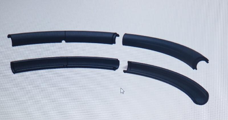

Wheel Horse 3D 3,822 #34 Posted March 18, 2021 Ill work on coming up with something, a rough draft we can apply specific dimensions to easily. 1 Share this post Link to post Share on other sites
Wheel Horse 3D 3,822 #35 Posted March 18, 2021 (edited) 11 hours ago, Wheel Horse 3D said: Ill work on coming up with something, a rough draft we can apply specific dimensions to easily. Modeled for a 14" steering wheel with 3 round spokes. Note the downward angle of the spoke holes. This is one 3rd ( 60 degree section) of the wheel. For a steering wheel like this with even spokes, you just repeat this pattern. 3x. Can definately be done even on my little printer, but a lot of print time. Something youd do for that one perfect steering wheel or something with custom embossed features. Can even model covers over the spokes and all the way to a new center. Edited March 18, 2021 by Wheel Horse 3D Share this post Link to post Share on other sites
