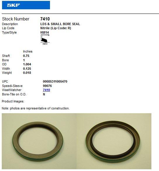

The Tuul Crib 7,347 #1 Posted January 29, 2021 Anyone know the crossover number for this grease seal # 1303 . It's on a mid 60s mower deck. It's number four in the picture. Share this post Link to post Share on other sites
WHX?? 55,257 #3 Posted January 29, 2021 Same seal on tranny brake shafts. 1 1 Share this post Link to post Share on other sites
The Tuul Crib 7,347 #4 Posted January 30, 2021 6 hours ago, WHX24 said: Same seal on tranny brake shafts. Good I may have a couple! I only need three! Share this post Link to post Share on other sites
