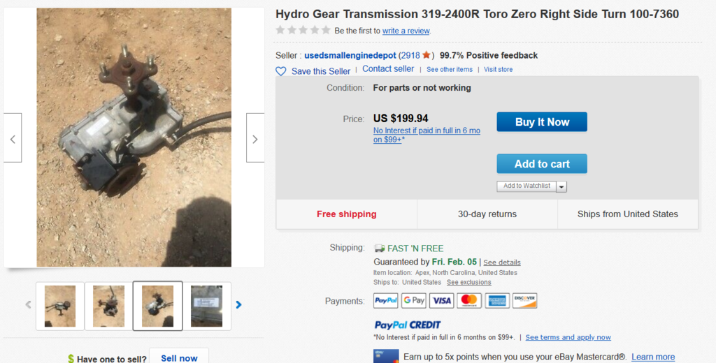

gyanzuk 10 #1 Posted January 29, 2021 Hi everyone. I have a question about a Toro Time Cutter zero turn. My problem is that the Hydro has a number 319-2400R, when I go to the parts book it gives me another number 107-1708. I can't find the correct number from Hydro-Gear. Does anyone have any idea on where to find the correct number for this Hydro? I found a service manual from Hydro-Gear but it is a completely different number of this Hydro. Hydro-Gear manual showes a 310-2400/2600 Intergrated Zero-Turn Transaxle, this a different number that is shown with the mower. According to Tractor Data.Com it is showing a Hydro-Gear IZT, whitch I think is the 319-2400R but not sure, so I was wondering if someone could help. I would appreciate it. Thanks George Share this post Link to post Share on other sites
