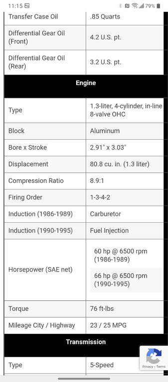

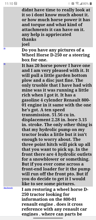

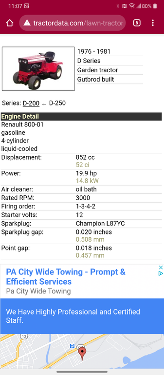

WVHillbilly520H 10,378 #34 Posted January 31, 2021 No real pics of the comparable engines...but some quick specs... Share this post Link to post Share on other sites
Tractorhead 9,217 #35 Posted January 31, 2021 I‘m not 100% sure, but i believe this Engine was also beeing used in the basic Renault R5. but they are also hard to find today and if so, they be mostly Historic Vehicles. The most Parts for the R5 you can Find here are primary parts for the R5 Turbo Alpine, a blown big bro of the Basic R5. It was a Blast in the early 90ies and win’s lot‘s of Rally prices. At the first time out of any comparsion until Audi 4WD hit‘s the Scene. Here in Europe the R5 Turbo Alpine is still a legend. Definitely not everybody‘s darling, but still a well known Racing legend. Share this post Link to post Share on other sites
littleredrider 409 #36 Posted January 31, 2021 Must be thinking of the Kei trucks, they are 660cc motors, thought the sammi's were. Can't find any of those either lol, other than complete trucks, which I'd LOVE to have lol 1 Share this post Link to post Share on other sites
