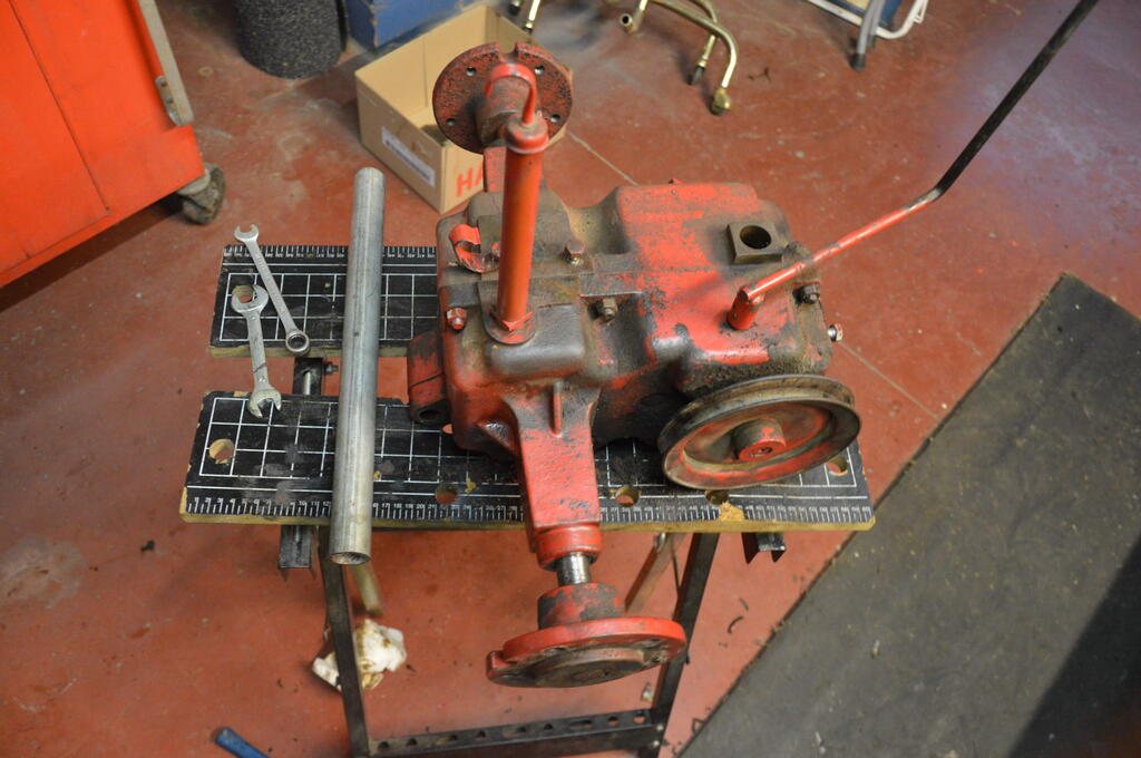

Maxwell-8 4,370 #26 Posted February 18, 2021 (edited) And a fresh gasket ans some new axle seals. Edited February 18, 2021 by Maxwell-8 2 Share this post Link to post Share on other sites

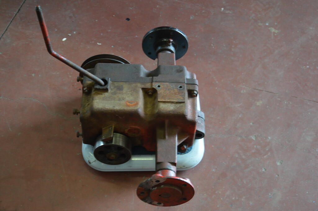

Maxwell-8 4,370 #27 Posted February 18, 2021 And installed the hubs so she is ready to get bolted back up to the tractor. another trans/tractor saved and ready to run another +35 years 2/3 of the trannys done, tomorrow i start on the Raider 10, a 4 speed. 2 1 Share this post Link to post Share on other sites

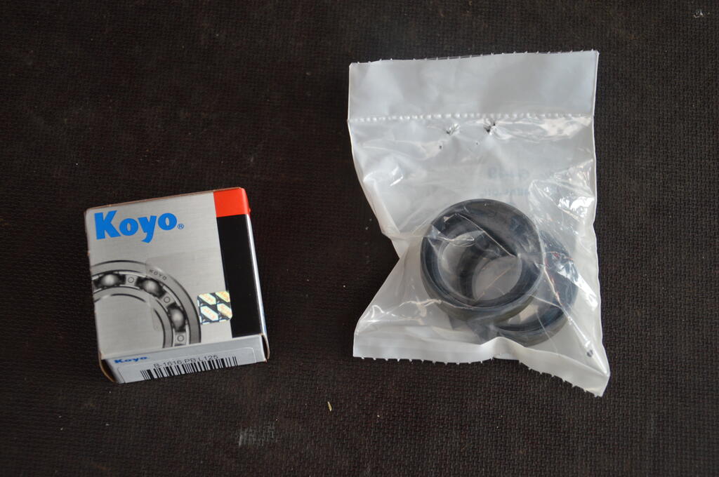

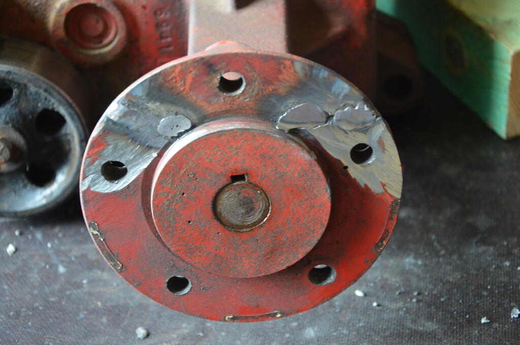

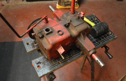

Maxwell-8 4,370 #31 Posted July 4, 2021 Finnally the last axle bearing came in, 55$ for one bearing. Made myself a bearing installer since I didn't want to risk using the hammer It went in like butter everything nicely cleaned and a new gasket But disaster striked again 'Gently' hammerd the hubs on, but the last hit, I hit a bit to high and blew one piece clean off. Since hubs are impossible to find, we had no other option but to weld her back together. with a 20$ welding rod But this 40kg (90 lbs) tranny is now finnaly done and ready to put back under the Raider 10. My first horse I ever bought but 8 months later and I still haven't driven it. But that is about to change! 3 1 1 Share this post Link to post Share on other sites
