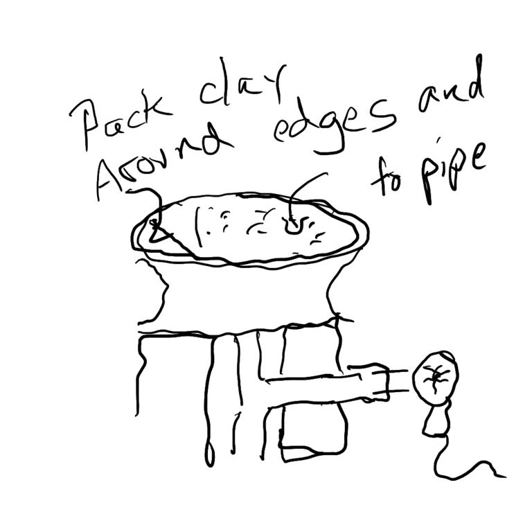

Wheel Horse 3D 3,827 #103 Posted March 18, 2021 (edited) Key is getting all contained small like the sketch i did over the pic. Keep the air through the coals as long and far as possible. Edited March 18, 2021 by Wheel Horse 3D 1 Share this post Link to post Share on other sites

Wheel Horse 3D 3,827 #107 Posted March 18, 2021 Any ol rim a couple bricks, a pipe and T, Trinas hair dryer, some clay, or plain clay kitty litter 1 Share this post Link to post Share on other sites
Wheel Horse 3D 3,827 #109 Posted March 18, 2021 (edited) Even this setup a couple bricks on either side of your basin makes a huge difference Plain clay kitty litter soaked in a bucket till soggy, mix in some unburned ash from the burnpile excellent firebrick, make do Edited March 18, 2021 by Wheel Horse 3D 1 Share this post Link to post Share on other sites

Wheel Horse 3D 3,827 #116 Posted March 18, 2021 (edited) 7 minutes ago, 8ntruck said: Agree with heating to bright red to orange. Good working range. Any hotter, you can start to burn the carbon out of the steel. The quench step should be dependent on the material being bent and the intended use. If it is a high carbon material, quenching it could make it hard and brittle. If hardness is desired, a tempering cycle might also be needed. If it is low carbon material (rebar, hot rolled, etc.), quenching will just cool the piece off quickly. In your firebrick receipe, you say to mix in some unburned ash. That like gray wood ash with no chunks of charcoal in it? Yep, the ashes that even sittin overnight with hot coals didn't burn. I use it like a "fire clay". My basin is thin sheet metal (used to be a chimney spacer?) with a brass 4" grate in the bottom. I used that mixture and made me this fire clay and I'have a good couple of inches of it all around the inside of my basin. Over time ya have to go back in and freshen it up, but works great. But DO be careful mixing! make sure to wear rubber gloves, depending what ashes ya have there's some Potassium Hydroxide goi'n on there! (Wood lye) i think that's part of why it works. Edited March 18, 2021 by Wheel Horse 3D Share this post Link to post Share on other sites
Wheel Horse 3D 3,827 #117 Posted March 18, 2021 (edited) Poassium carbonate(ash) plus water Potassium hydroxide. Im sure they clay has some calcium carbonate (limestone) in there which wouldn't do much till heated to Calcium oxide and then react with the remaining moisture which basically turns into lime, and maybe enough moisture to turn into Calcium hydroxide..both would react with CO2 in the air to basically turn back into carbonates......with other sand etc in there you'd basically end up with some sort of Potassium and Calcium Carbonate mortar holding together the other components of the kitty litter and ash (silica,very fine carbonized fibers?) HAD TO EDIT! I realized why the ash...Potassium! Potassium has a much lower reaction point with oxygen. So in the heat of the fire while calcium carbonate(limestone and theres not much of that in the kitty litter) would be turning to calcium oxide and waiting to react qith water and degrade, potassium has aleady reacted and is in the stable carbonate form and doesnt react as much with water! Potassium basically skips the oxide phase. Now i feel better! Edited March 18, 2021 by Wheel Horse 3D Share this post Link to post Share on other sites
