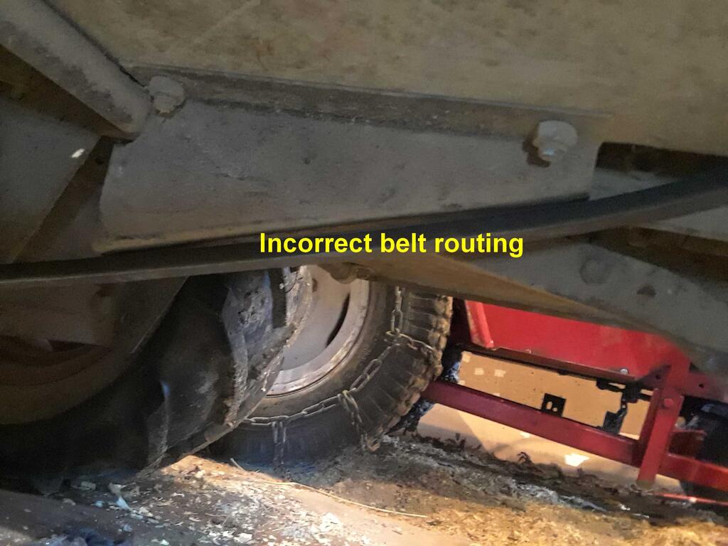

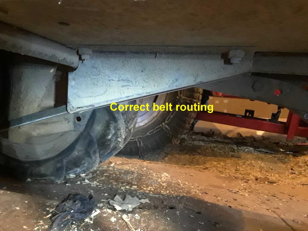

wind77west 14 #6 Posted January 24, 2021 Well I started my troubleshooting today and it turns out to be short lived. I started by looking under the tractor for a good place to jack it up and what to my surprise I found the drive belt with the incorrect routing (see photo). I proceeded to correct the routing of the belt (see photo). I started the tractor and what to my surprise the noise had gone away. To verify the cause I but the belt back to the incorrect routing and started the tractor and low and behold the noise came back. This told me I found the problem. The only way I can figure is when the original noise started and I found a bad idler pulley and replaced it I installed the belt guard incorrectly with the belt routing causing the noise. Well the tractor got some extra maintenance (transmission oil change) which it needed. Thanks for all the input. 3 1 Share this post Link to post Share on other sites
