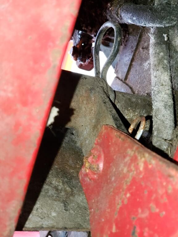

Tom kite 3 #1 Posted January 20, 2021 (edited) I have a snowblower on my 520h. I can't get it to come up equally on bought sides. I chould used help with this ty . Edited January 20, 2021 by Tom kite Share this post Link to post Share on other sites
Maxwell-8 4,368 #2 Posted January 20, 2021 33 minutes ago, Tom kite said: I have a snowblower on my 520h. I can't get it to come up equally on bought sides. I chould used help with this ty . Is nothing bent? Share this post Link to post Share on other sites
Tom kite 3 #3 Posted January 20, 2021 (edited) No sir , as you can see that it in up all the way up Edited January 20, 2021 by Tom kite . Share this post Link to post Share on other sites

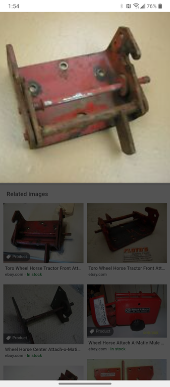

WVHillbilly520H 10,376 #9 Posted January 24, 2021 (edited) 16 minutes ago, Tom kite said: Gary i took of the belt it still lifts t h e same way. What causes this sir. The 4 bolts that mount the hitch to the snow thrower itself could be twisted, like Gary said try taking the bolts out enlarging/slotting the holes then remount to the tractor with the bolts finger tight lift to highest position "level" and wrench tighten the bolts. Also make sure you have the hitch bar securely locked in the front attach-a-matic, sometimes it doesn't lock in completely without a a little help from a small hammer. Edited January 24, 2021 by WVHillbilly520H Share this post Link to post Share on other sites
