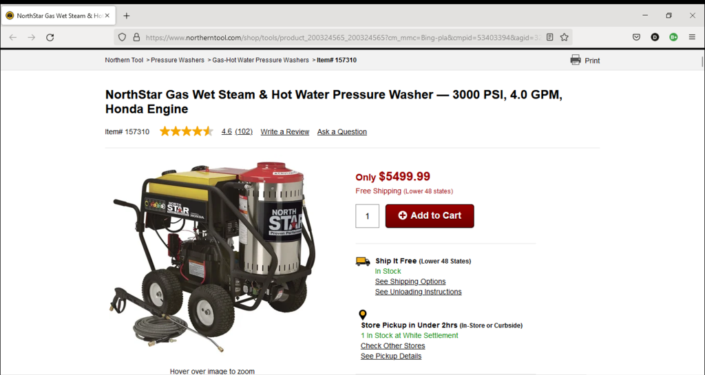

Snoopy11 5,731 #23 Posted August 8, 2022 (edited) On 1/23/2021 at 7:44 PM, AMC RULES said: hit it with the high heat pressure washer Uh... I hate to say this... but... Who the hell has a "heated pressure washer???" I'm an equipment nut... and own a pressure washer... but... not... a... "heated pressure washer???" I don't even KNOW anyone who owns a "heated pressure washer" EDIT: Oh... I see why I don't own a "heated pressure washer" ... Don Edited August 8, 2022 by Snoopy11 Share this post Link to post Share on other sites
ebinmaine 77,771 #24 Posted August 8, 2022 8 minutes ago, Snoopy11 said: Uh... I hate to say this... but... Who the hell has a "heated pressure washer???" I'm an equipment nut... and own a pressure washer... but... not... a... "heated pressure washer???" I don't even KNOW anyone who owns a "heated pressure washer" EDIT: Oh... I see why I don't own a "heated pressure washer" ... Don Trina's pressure washer can be connected to the utility sink. Not sure the high temp resistance. It'll run hot 🔥 water through it that way. 1 Share this post Link to post Share on other sites
Snoopy11 5,731 #25 Posted August 8, 2022 1 minute ago, ebinmaine said: pressure washer can be connected to the utility sink Oh... so... it's technically not a "heated pressure washer" Just... the water that goes through the pressure washer is hot... I say all that... 'cause the average joe-douchebag (myself included) doesn't have... or want... a "heated pressure washer" Don Share this post Link to post Share on other sites
