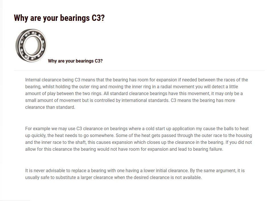

Kelsey 91 #14 Posted July 28, 2021 (edited) Our K241 crank bearings have MGMRADAX HUNGRY 6308 stamped on it. I'm curious to see how these 31 year old bearings cross reference to a different manufacturer. I found this bearing on Amazon : NTN 6308C3 Bearing Open 40x90x23 mm 6308 C3 Could these bearing be used? Edited July 29, 2021 by Kelsey Share this post Link to post Share on other sites
pfrederi 19,887 #15 Posted July 29, 2021 The 6308 defines the size any added letters usually address seals or other uniqueness Share this post Link to post Share on other sites
