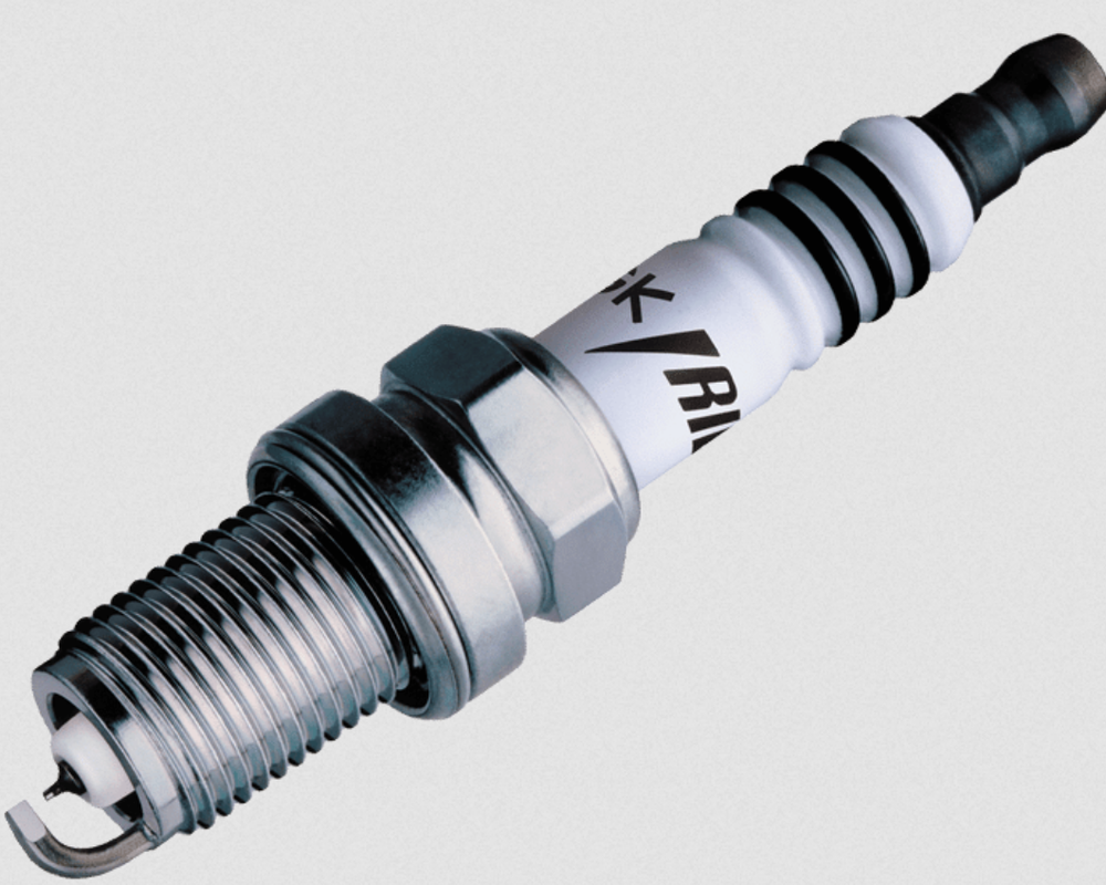

305 381 #1 Posted January 14, 2021 In the H70 Tecumseh on my `69 700 and the H60 on my `68 Lawn Ranger i use non resistor sparkplugs because that is what they had in them new. should i be using resistor plugs? i tried them i believe they started harder and did not tun as well with them...or was it my imagination? i also think i had a better spark what do think? Share this post Link to post Share on other sites
ri702bill 12,803 #2 Posted January 14, 2021 Going waaay back - resistor plugs came out to eliminate ignition "noise" that could be heard on the car AM radio. Bill 2 1 1 Share this post Link to post Share on other sites
squonk 47,887 #3 Posted January 14, 2021 Yup it was your imagination. The resistor plugs require no more voltage to fire than non-resistor. The resistance is in the insulation to stop leakage out. Same thing with fatter ign wires. 1 1 Share this post Link to post Share on other sites

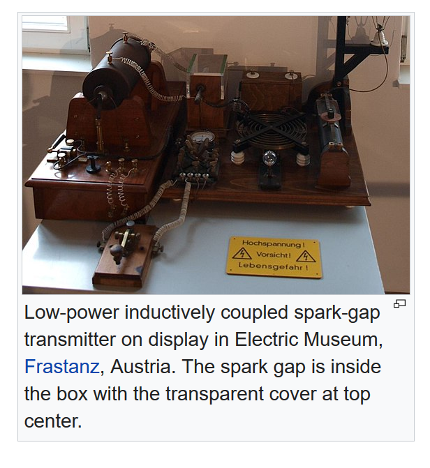

bc.gold 3,406 #7 Posted January 14, 2021 (edited) 1 hour ago, Zeek said: They are simply to eliminate radio interference. As far as pacemakers (if for some reason you plan to put it within 12'') I believe they mean the "ignition system", meaning the coils/magneto that generate the high voltage and wires that carry it, not the plug buried in the head. Don't be a plug hater VA7ELM certificate with honors. Licensed ham operators who design and build their own equipment have to be aware of radio interference that may cause issues with neighbors electronics. First generation spark plug wires had a wire core, 2nd gen wires are carbon impregnated fiber. Do not pull the wire portion as you can damage the wire which in turn will require a replacement. Grab firmly onto the spark plug wire boot, then twist in either direction and pull off simultaneously. By pulling the cable incorrectly could cause an internal break which in turn a allow for a spark gap, the wireless telegraph works on the principle. Spark-gap transmitter A spark-gap transmitter is an obsolete type of radio transmitter which generates radio waves by means of an electric spark.[1][2] Spark-gap transmitters were the first type of radio transmitter, and were the main type used during the wireless telegraphy or "spark" era, the first three decades of radio, from 1887 to the end of World War I.[3][4] German physicist Heinrich Hertz built the first experimental spark-gap transmitters in 1887, with which he proved the existence of radio waves and studied their properties. Edited January 14, 2021 by bcgold 2 Share this post Link to post Share on other sites

lynnmor 9,008 #9 Posted January 16, 2021 Years ago there was a guy that set up at carnivals selling Hot Spark Intensifiers that were only large resistors replacing the coil wire. He demonstrated the engine performance with the device and with a plain coil wire showing improvement with his device. It was basically a scam, but it did show the benefits of increased resistance when the spark plugs are in poor condition. You see, on a simple points ignition the spark voltage rises till it is enough to discharge thru the wires and plugs. The higher voltage caused by the resistance was able to jump the spark plug gap instead of bleeding away thru faulty wires and dirty plugs. Share this post Link to post Share on other sites
bc.gold 3,406 #10 Posted January 16, 2021 Electricity always takes the shortest route provided. The ribs are spark arresters. one path removed. Share this post Link to post Share on other sites
