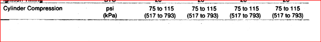

Tom kite 3 #1 Posted January 13, 2021 what should the Compression on a onan p220 ? Mine 100 is that low? In Cylinder 1 and 2 are 100. ty Share this post Link to post Share on other sites
WHX?? 56,848 #2 Posted January 13, 2021 I just checked one of mine Tom and got 125 on both jugs. Guessing that's probably the max one would get. Brand new motor might get a tad more. 100 doesn't sound the worse. Any idea how many hours are on it? 1 Share this post Link to post Share on other sites
WHX?? 56,848 #3 Posted January 13, 2021 From the manual.... 1 Share this post Link to post Share on other sites
Handy Don 16,752 #4 Posted January 13, 2021 Yep, 100 is just fine and good that they are both there. Share this post Link to post Share on other sites
