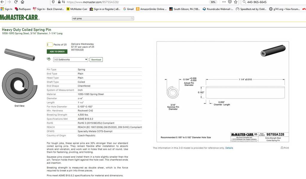

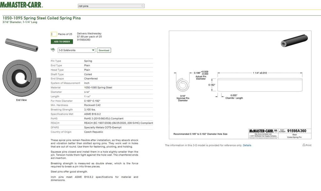

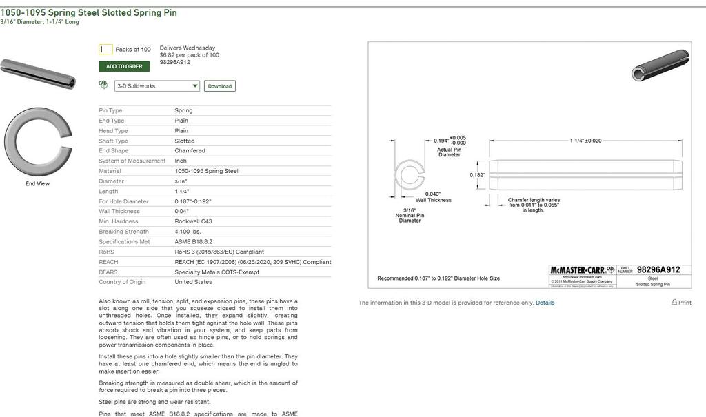

pfrederi 19,272 #9 Posted January 12, 2021 Spiro are stronger ONLY if you are sure you are getting the heavy duty ones. I doubt the ones in the parts bin at the hardware store are heavy duty... 1 Share this post Link to post Share on other sites
