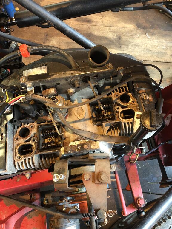

WheelhorseBob 1,550 #1 Posted January 10, 2021 Last project this weekend. I’m adjusting the valves on my 416. Doesn’t seem like a bad job at all. I also have head gaskets to do a decarb but that will wait. Weather windows can close fast this time of year in NH and I don’t want this dead in the water for too long. Question for Onan guys. Reseal the intake or no? It ran well but was ticking so the valves are a must but..... Share this post Link to post Share on other sites
Handy Don 15,645 #2 Posted January 10, 2021 Hi. Just did over a P218 and elected NOT to disassemble and reseal the intake manifold. It was a 400 hour engine, I saw no sign of deterioration. I taped over the ends and put a bit of gasoline into the manifold while it was off the engine and couldn't detect any seepage out of the seams, either. I cleaned it and put it back. The only step I nearly forgot was too put back the spring "reed" valve in the front cylinder valve cover (a sort of PCV system.) Also, following the manual and advice from members here, was careful to use proper torques on ALL bolts and nuts (the valve covers seem barely more than finger tight!) and to trim a bit of the manifold cover where it was rubbing on the manifold. Share this post Link to post Share on other sites
WheelhorseBob 1,550 #3 Posted January 10, 2021 (edited) Reed valve in front valve cover? Mine are identical? Edited January 10, 2021 by WheelhorseBob Share this post Link to post Share on other sites
Handy Don 15,645 #4 Posted January 10, 2021 5 minutes ago, WheelhorseBob said: Reed valve in front valve cylinder? Mine are identical? Sorry for the false lead. Clearly the P216 doesn't have the reed-valved PCV tube that on the P218 connects from the top of the front valve cover to the air cleaner. You're good! 1 Share this post Link to post Share on other sites
lynnmor 8,384 #5 Posted January 10, 2021 Do the check with gasoline in the intake. I clamp a plate with gasket material over the carb hole and then pour gas in. See that small cut in the side of your intake? Trim the heat shield there and look for other cuts as well. The breather design changed over the years, the one that goes in a valve cover has a hose that is troublesome. 1 Share this post Link to post Share on other sites

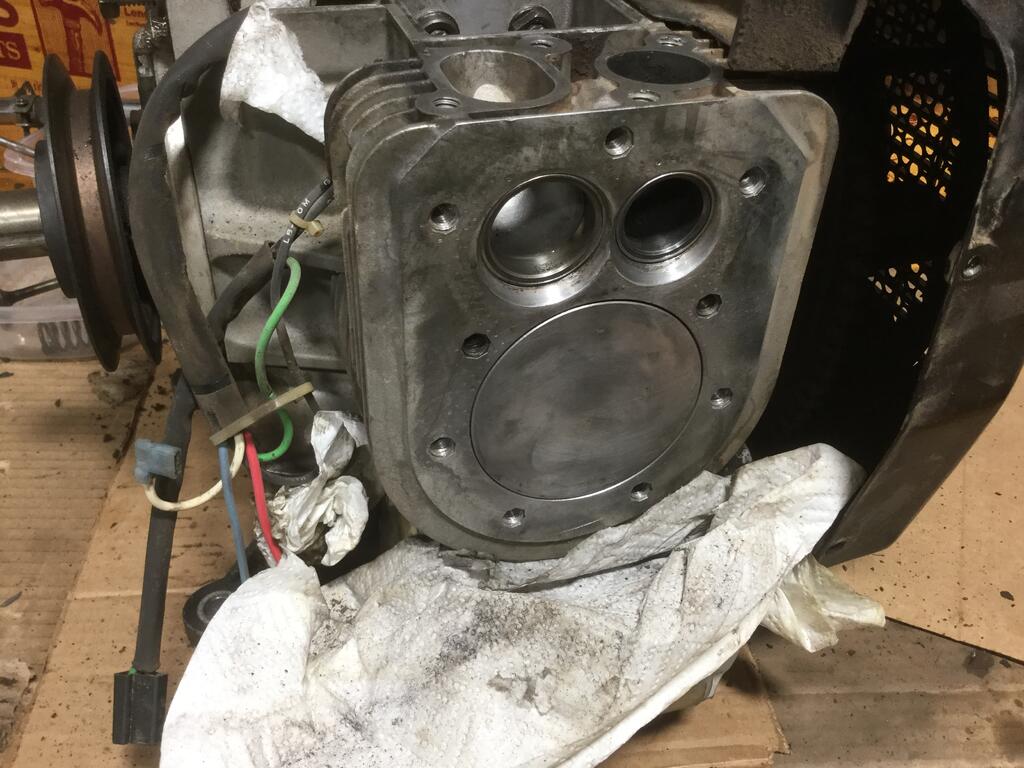

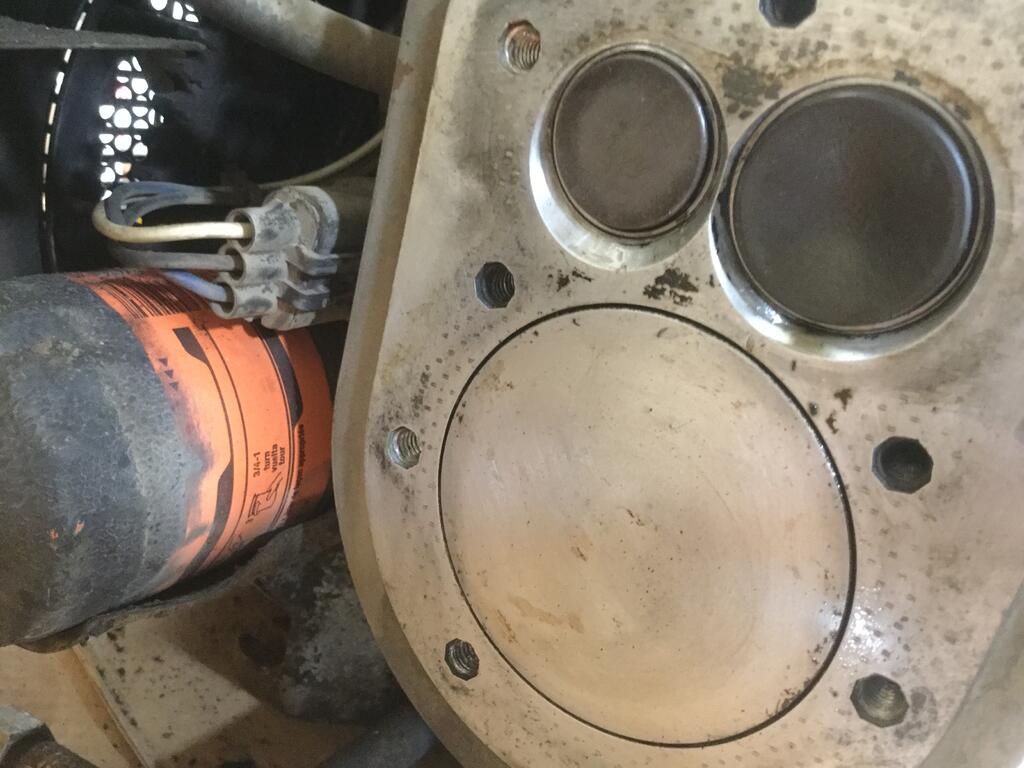

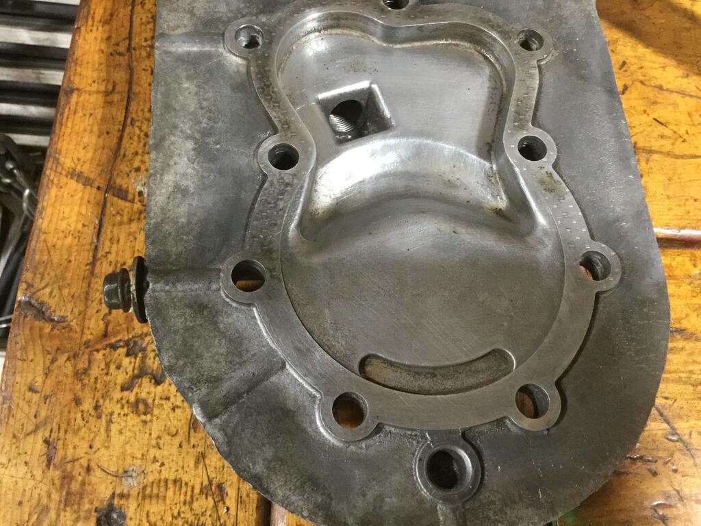

Tuneup 1,452 #10 Posted January 12, 2021 I've just finished the valves on my very early P216 - it has the vent filter on the front valve cover but does not have an oil filter. Just for the record - seems the lister has his question answered . Question: What method do y'all use to remove the carbon from the head? This is aluminum and the old wire wheel is a no-no. I've looked for brass but am out of luck. I'm down to hand scraping with an old brass windshield scraper. Help? Share this post Link to post Share on other sites
richmondred01 2,323 #11 Posted January 12, 2021 Angle a razor blade at 45 degrees so it won’t dig. That gets the big stuff. Use brake cleaner and a soft cup wire brush on an 1/4 angle grinder. That will take 95-98 % off. Finally use scotch bright to remove the rest. 2 Share this post Link to post Share on other sites
lynnmor 8,384 #13 Posted January 12, 2021 3 hours ago, Tuneup said: I've just finished the valves on my very early P216 - it has the vent filter on the front valve cover but does not have an oil filter. Just for the record - seems the lister has his question answered . Question: What method do y'all use to remove the carbon from the head? This is aluminum and the old wire wheel is a no-no. I've looked for brass but am out of luck. I'm down to hand scraping with an old brass windshield scraper. Help? I have used oven cleaner successfully on the heads, the low odor kind will let you use it indoors. The oven cleaner can discolor aluminum, so wash it off before it is on too long. I don't use any kind of metal tool to prevent damage. When scraping pistons, I oil the cylinder walls and move the piston to the very top. After cleaning, the oil will hold the dirt as you move the piston down a little. Share this post Link to post Share on other sites
pacer 3,179 #14 Posted January 12, 2021 All carbon on heads is not created equal Some times its like cement and others comes right off. If its the softer kind a stick of hard wood (like oak/hickory) shaped like a paint paddle with a chisel type taper sanded on end will do the trick. Other wise the already mentioned methods will have to be used. On the manifold leakage, I fabricate a plate to fit/cover the carb mount and mount it in the vise upside down then fill with .... whatever, paint thinner, gas, kerosine, etc and let it sit while I do the other maintenance. So far I've never had one to leak --- which suits me just fine! Share this post Link to post Share on other sites
tom2p 2,394 #15 Posted January 12, 2021 hard plastic scraper might work to remove carbon ? probably around 40 years since I decarbonized a head or piston - but I think back in the day I did use a wire wheel on a drill or dremel ... ? ... didn't know any better Share this post Link to post Share on other sites
squonk 45,086 #16 Posted January 12, 2021 Soak the carbon with carb cleaner, lacquer thinner or Sea Foam. A good amount of carbon will wipe away. 1 Share this post Link to post Share on other sites
Tuneup 1,452 #17 Posted January 13, 2021 I appreciate y'all, thanks - will try each and every one of these methods, just for comparison. Makes me curious. The rings are on their way so I'll have this engine together by month's end. 1 Share this post Link to post Share on other sites
