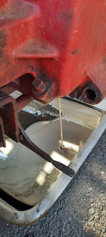

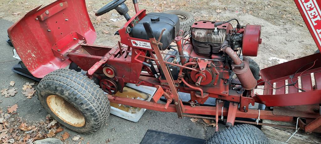

Docwheelhorse 2,992 #1 Posted January 9, 2021 Bought a brand new 7473 belt ($46) for my C160 because it wasn't shifting right and squeeled alot... saw it was one of those Green Gates cheater belts and figured that was issue. Decided to do a full service as I knew transaxle had water... siggghhhh THE NEW BELT DOESNT FIT.... WTH??? OH!!! SOME IDIOT BEING CUTE PUT A HYDRO 5" PULLEY ON ENGINE. Now I get to try and get it off without wrecking anything and I need to find an 8 speed 1 1/8 crank pulley to make it right. Some people should not have tools or Wheel Horses... 🤬🤬🤬🤬🤬🤬🤬🤬🤬🤬🤬🤬🤬🤬🤬🤬🤬 Stay Safe Everyone Tony 2 Share this post Link to post Share on other sites

wallfish 20,736 #6 Posted January 9, 2021 Just leave that pulley on there and enjoy the extra speed. I've never had any problems at all using the TSC kevlar belts to drive a tractor. The squealing is probably caused from the frozen water in the trans. Clean the pulley surfaces 5 1 Share this post Link to post Share on other sites
Handy Don 17,684 #7 Posted January 9, 2021 1 hour ago, Docwheelhorse said: Water you say? Looks more like a Starbucks mocha latte to me! 2 Share this post Link to post Share on other sites
Docwheelhorse 2,992 #8 Posted January 9, 2021 1 hour ago, wallfish said: Just leave that pulley on there and enjoy the extra speed. I've never had any problems at all using the TSC kevlar belts to drive a tractor. The squealing is probably caused from the frozen water in the trans. Clean the pulley surfaces No frozen water... its been squeeling for the 6 months I've owned it and it just doesn't de-clutch correctly... it grinds the gears when shifting in. It will be corrected 1 1 Share this post Link to post Share on other sites
rjg854 13,422 #9 Posted January 9, 2021 All I can say about that gear oil is WOW Share this post Link to post Share on other sites

squonk 48,339 #12 Posted January 10, 2021 Harmonic balancer puller will get that pulley off 1 Share this post Link to post Share on other sites
Retired Wrencher 7,037 #13 Posted January 10, 2021 Tony I have seen worse than that for tranny fluid. The chunky kind. I have frozen 4 speeds come back to life by flushing them out. 1 Share this post Link to post Share on other sites
clueless 3,440 #14 Posted January 10, 2021 15 hours ago, Handy Don said: Water you say? Looks more like a Starbucks mocha latte to me! That how the cream color Behr interior paint that I painted the living room with last weekend looked before I stirred it . 1 Share this post Link to post Share on other sites

AHS 1,703 #18 Posted January 11, 2021 You probably have already done this, but make sure to replace the shifter boot... to make sure any milky stuff doesn’t come out of the tranny later in life! Share this post Link to post Share on other sites
